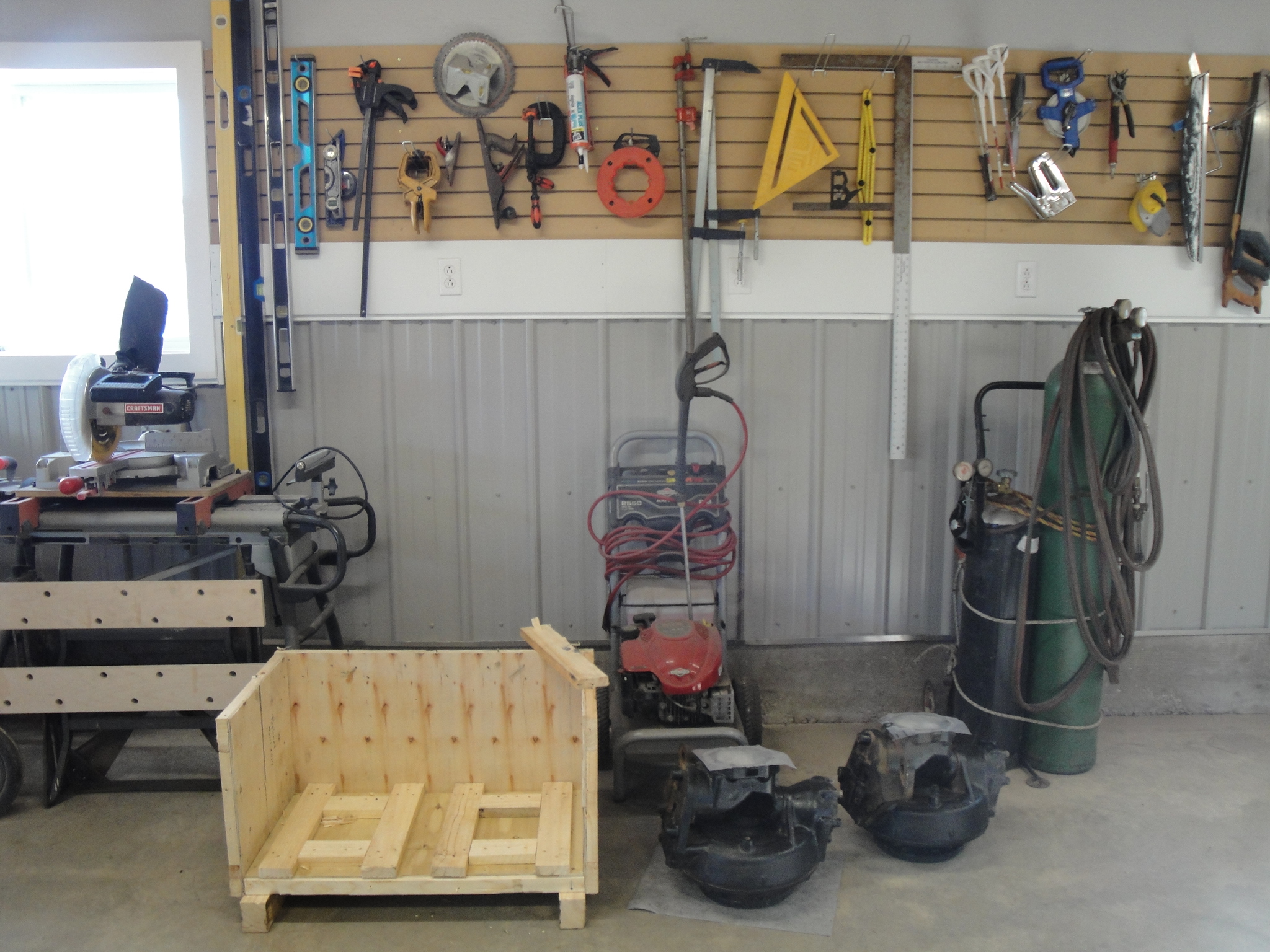

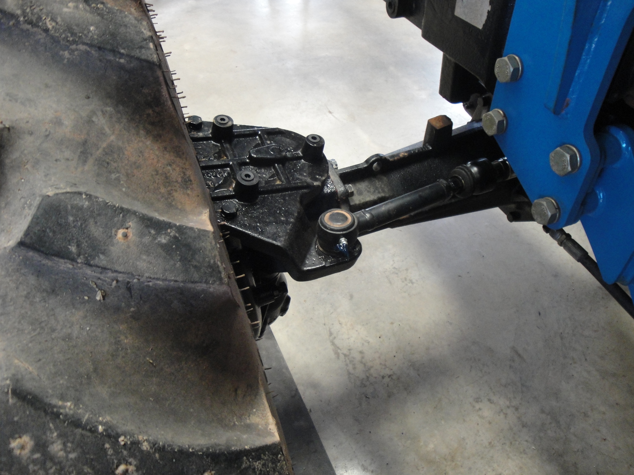

/ Failed bearing 7010 #36
A couple mechanics came to my garage on May 5/17 and replaced the front hub assembly's on my 2012 LS7010. Mine were still good but LS (Pattersons) are upgrading 200 tractors in the area. They left me the old assemblies to do what I wish with. The tie-rod ends they had with them had grease fittings installed in them so I decided to drill and tap mine for grease fittings. Easy to do and could help extend the life of them. Just a note: Keep the boots lubricated to help prevent them from drying out and cracking. Just under 900 hrs. on my tractor and everything going well. (Knock on wood) PS: Only a couple hour job to replace both hub assembly's.
