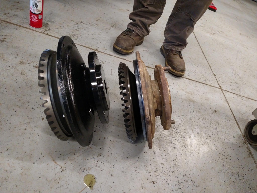

The other side on mine blew up yesterday....
/ Failed bearing 7010
#26
Dealer came thru with a hub assemble for me, seems to be a thing with some tractors, service manager tells me, this is a "new" design. He feels that the angle plow in the winter may be stressing the bearings. If so, hopefully this new design will be a fix.
/ Failed bearing 7010 #27
We had another P series come in for service with the front wheel bearings failed and replaced with the updated hub assembly from LS. Our service rep feels confident that this updated design should be the fix. It's hard to see in the picture but the outer cast cover is heavier/thicker.
The one on the left clearly looks heavier. Did your service rep mention if these updated designs are on production tractors? If so when did they start to replace the previous design? Reason I ask, I have a 2014 7010... Bought in October, but do not know date of manufacture yet.

If you are having bearings failed, what would changing the housing stop the bearing to fail ?
/ Failed bearing 7010 #33
One possibility is that the outer cover is flexing, putting additional side load on the bearing.
/ Failed bearing 7010 #35
Both my front bearings on a 7040 were replaced with the new updated style.If you jack the front end up there is definately play in them like the old ones.The shop manager said you cannot set the bearings as they are not tapered.no preload.So they said they would replace them for free even after warranty because they dont think they will hold up.First set laste 310 hours.
/ Failed bearing 7010 #36
A couple mechanics came to my garage on May 5/17 and replaced the front hub assembly's on my 2012 LS7010. Mine were still good but LS (Pattersons) are upgrading 200 tractors in the area. They left me the old assemblies to do what I wish with. The tie-rod ends they had with them had grease fittings installed in them so I decided to drill and tap mine for grease fittings. Easy to do and could help extend the life of them. Just a note: Keep the boots lubricated to help prevent them from drying out and cracking. Just under 900 hrs. on my tractor and everything going well. (Knock on wood) PS: Only a couple hour job to replace both hub assembly's.
