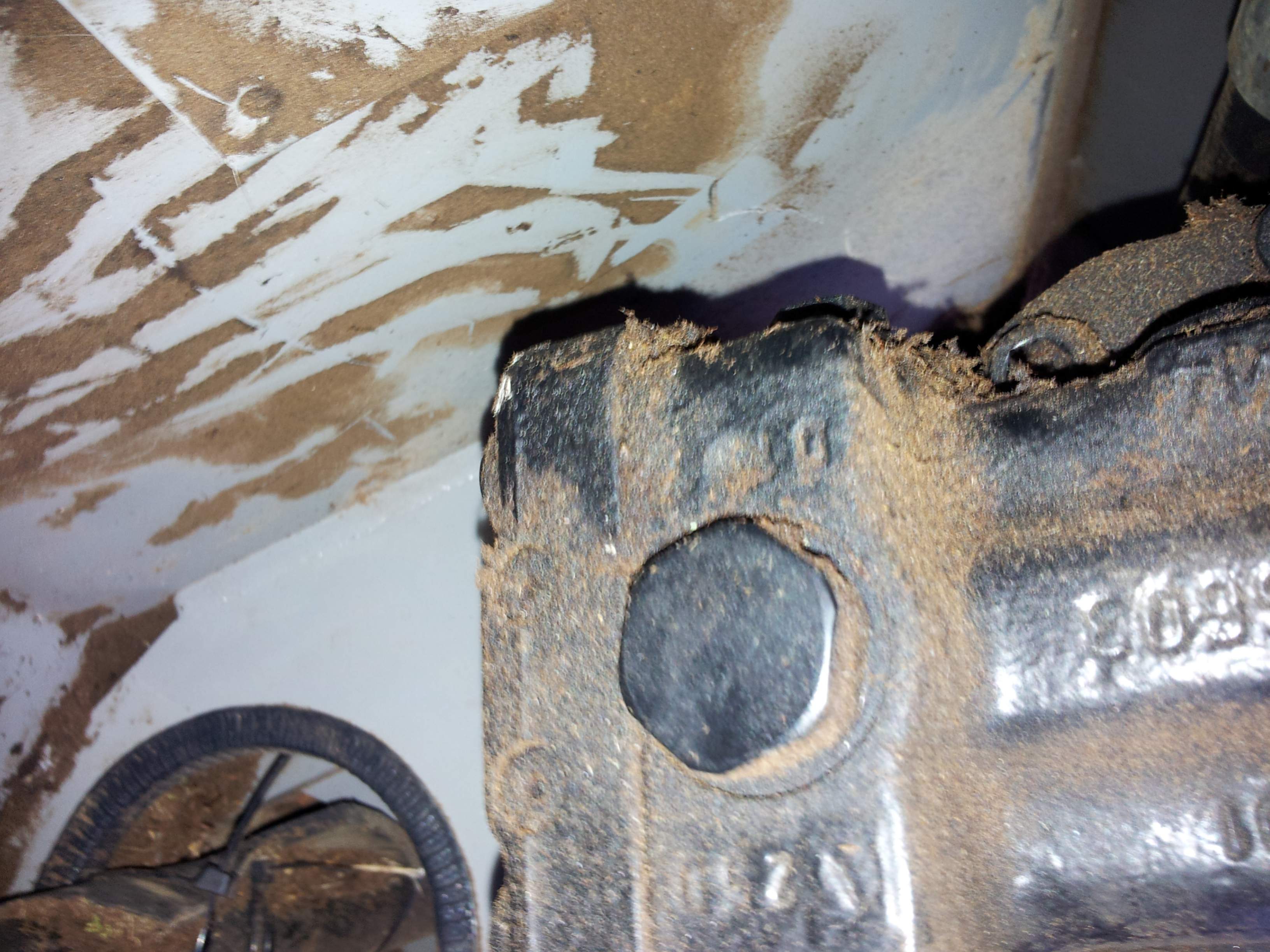

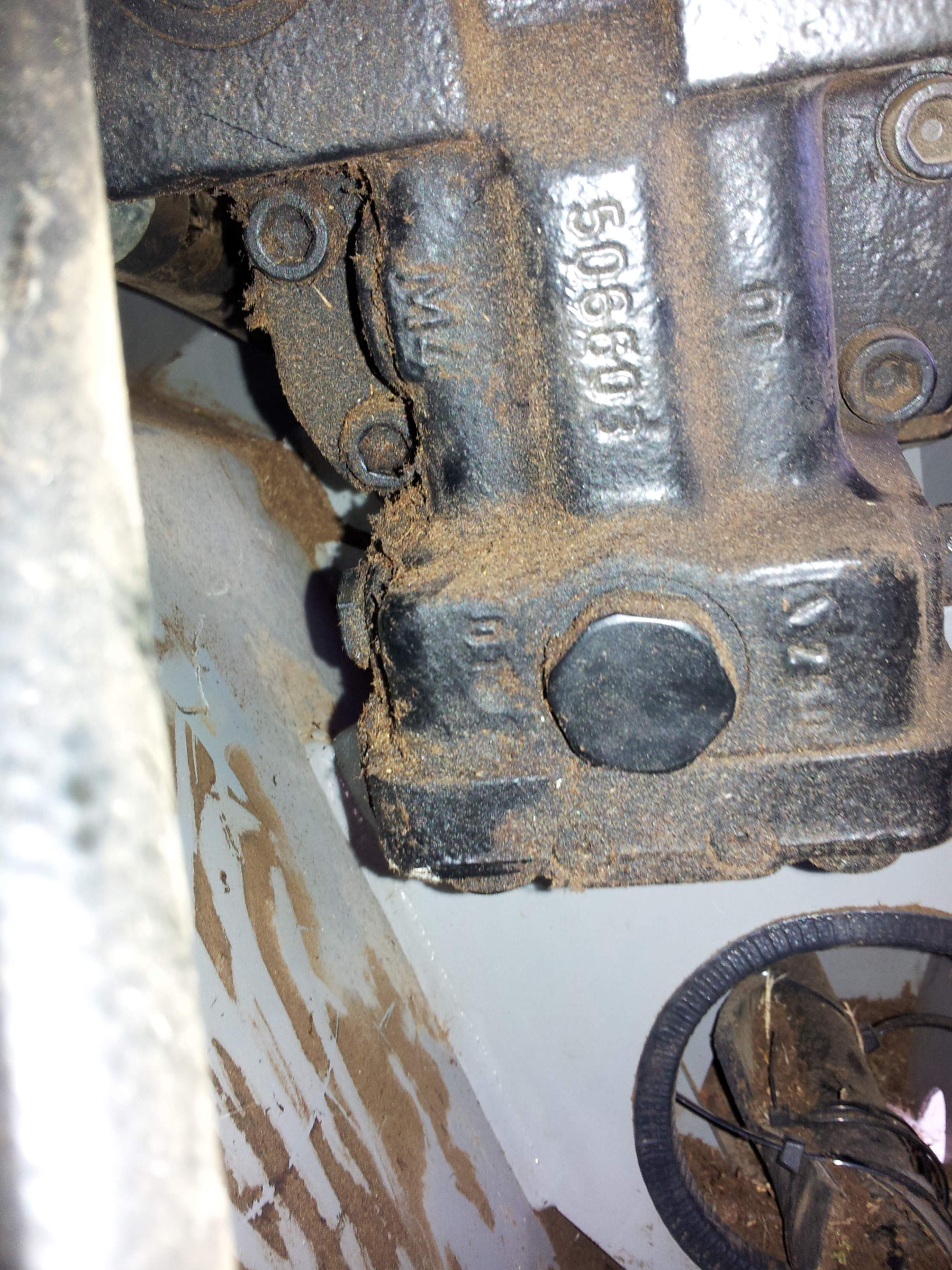

I have an FAE 2 speed mulching head. I noticed some oil seepage around the upper part of the hydro motor. I think the main seals are to the right of that area. This mower's motor is new to me but never had a problem in 7+ years with my single speed mower.
Other than the hoses and main seal, does anyone know where it could leak? It's not a lot of oil but I cleaned it off about 15 hours ago and had more wood dust/fluff stuck to the motor when I checked it last night. It looks as if some might have "sprayed" on the front, inside wall of the mower but won't know until I take the covers off and feel around. Not a lot of room to work in there and it's under warranty so I didn't want to mess with it too much. I rather not have to haul it to the dealer if it's something minor. Does anyone know if there are test ports or other fittings that can get loose? I've had that happen on other machines. If it's a small seep, is that a big deal? I've had other hydro motors that have mystery seeping and go years and years but since this is in an abusive application, I'm not sure what to think.

Call Lee Smith @ FAE, ask him to send you a motor diagram. There are many aditional ports on a motor, alternate locations for pressure/return, case drain and test ports. This way you can id what port is leaking and it might just be a loose plug or o-ring. From what you described it is on the pressure side of the motor, you need to find the source before it blows. That could cause motor damage and then there is the possibility of the dealer or manuf. saying lack of "proper" maint. I.E. checking for loose connections.

A few pics I took today. Blew off most of the wood dust and what's left is a little residue. No dripping and I couldn't get oil on my fingers beyond a residue. 20130802_145238.jpg20130802_145336.jpg20130802_145206.jpg
I tried the ports I could reach and didn't find anything loose or glaring like a blown o ring. FAE is supposed to get me more information.

I'm still finding the oily residue. I have not had enough down time to take it into the dealer and the head is operating fine. It's just an annoyance to see the motor "dirty". The best way I can describe it is the above pictures and to add that it gets an oily-hairy residue on the lower half of the motor. I see similar residue around some of the hydraulic hose fittings that are crimped. My dealer looked at the pictures and mentioned something about hydraulic motors "sweating". Anyone heard of that? If I blow off the motor it looks clean but I still suspect a little leak somewhere but it's not obvious.
