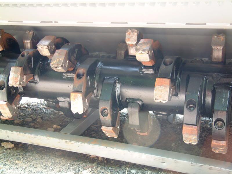

Some teeth....

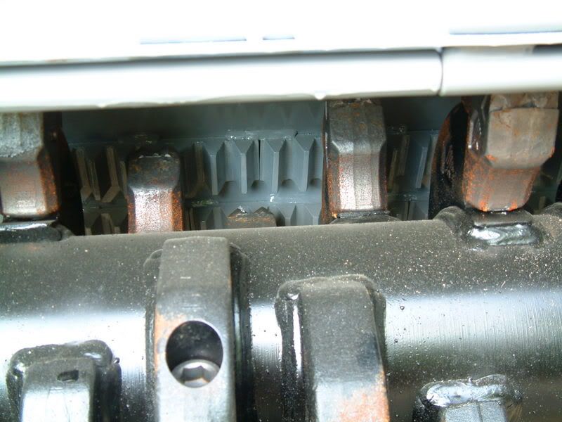

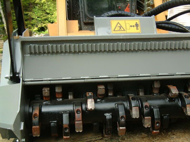

On the door and behind the rotor it has fixed teeth
The teeth are held on by a single, massive allen bolt
I need to get some couplers for it tomorrow and then to the woods.

Very nice. I have not personally seen them but I like the looks. I have the Fecon, Loftness and Magnum here and that looks ever bit as nice as any of them.
Let us know how it works.

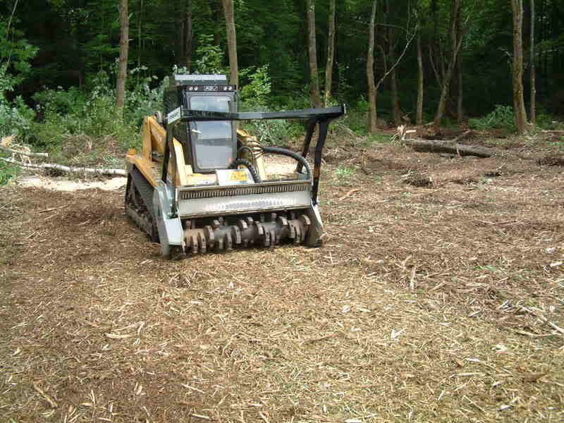

In the 2nd picture... what is that framework undearneath for?
Is it for shipping or maybe a dolly for rolling it around on in the shop?
   / FAE arrives
Gamma, yes the frame was for shipping.

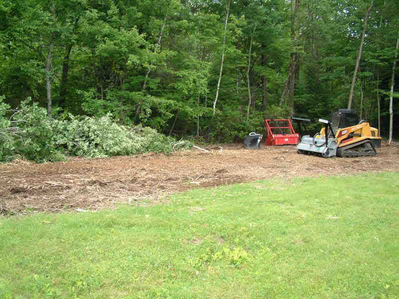

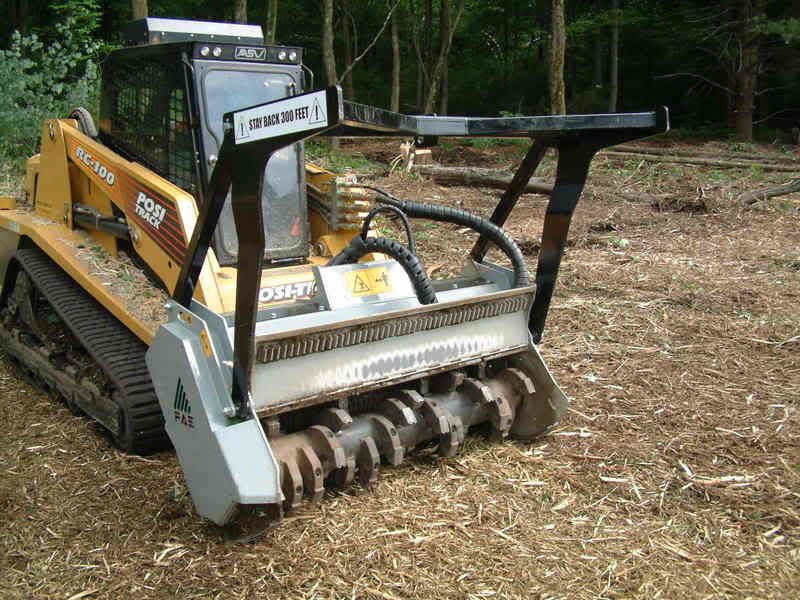

OK...mulching with the FAE.
First impressions. I tackled some cut branches and right away the noticed more flying debris compared to my Fecon. I hit it a few times with the door closed and I was very impressed with the final product, much finer then the fecon. Now you need to know that when I picked up the Fecon the salesman had sold me a model for 39-42 GPM, he said it would turn a bit slower but have more torque because of the lower gearing(anyone ever hear that?). Now after seeing the better finished product with the higher rotor speed I think he may have sold me what he had in stock and not what he should have. But in any case the FAE had the far better finished texture. It had better recovery time too. The only complaint was that it clogged up more then the Bull Hog.
Finished mulch.

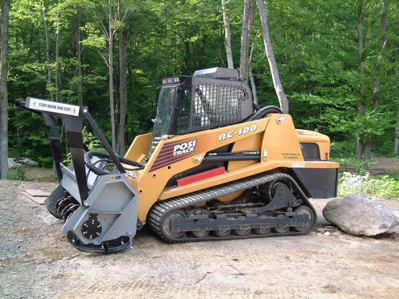

Final thoughts.
FAE gets picked up today. They offered me a very good price and if I had the choice today I would go with the FAE but I have most of the Fecon financed and I would lose on the deal if I had to sell it now, just bad timing.
Also, talked to the guys at Fecon and they said the slower RPM and more torque set up is used alot and my salesman was right on when he suggested that configuration. I will be trying the faster/less torque set up to see how that works, (less production and better finished product?) we'll see
