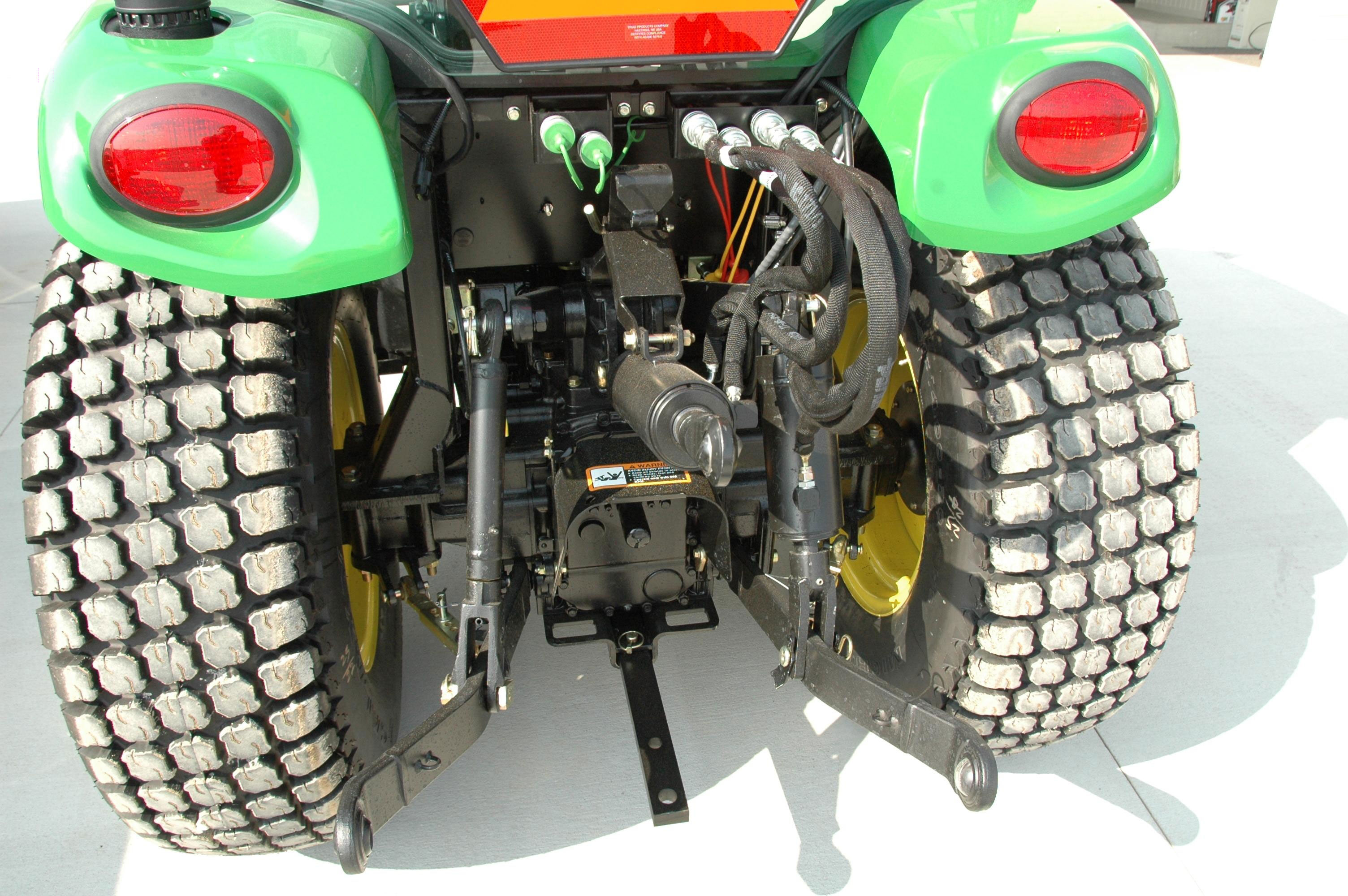

Been looking at adding a Hydraulic Toplink to my machine...In looking at the JD Specs from the parts site:
3.150" Bore
1.5" Rod
6" Stroke
Closed Length: 19.25"
Extended Length: 25.25"
Does anybody out there have pics of the Factory Toplink Cylinder? Do these specs match up to reality? Just want to make sure I'm on the right track before getting stuff ordered and lined up.

Hi Dave,
I've got the factory TNT on my 3720 cab. If you still need measurements let me know. I'll do it tomorrow.
