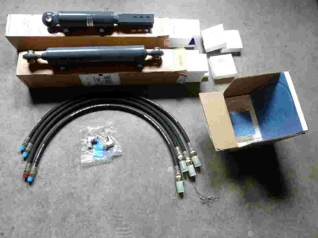

I went with the Kabota Remotes and the third party TnT kit on my L3010 which must be very similar to your L3200. The TnT kit was from Brian and went in with no problems. This is what he shipped

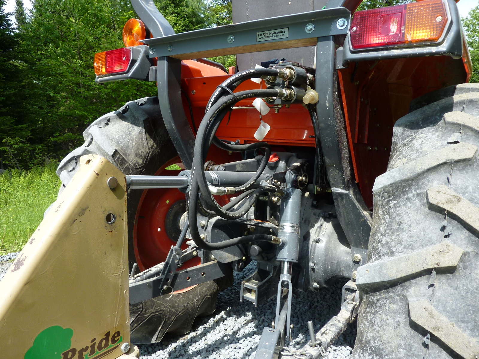

This is the installed kit which I am very happy with and in hind sight wish I got it sooner
