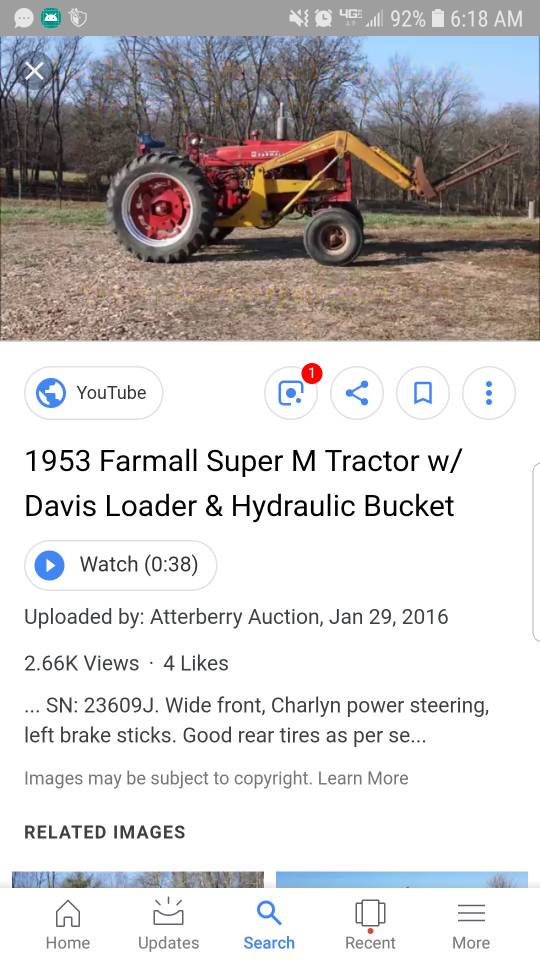

Look for a loader off a farmall. They have a good subframe that attaches to the rear axle and are good heavy duty loaders. You will have to convert it to hydraulic down pressure and add cylinders for curl function. They were gravity down and trip bucket. Screenshot_20190418-061858_Google.jpeg

Look for a loader off a farmall. They have a good subframe that attaches to the rear axle and are good heavy duty loaders. You will have to convert it to hydraulic down pressure and add cylinders for curl function. They were gravity down and trip bucket.View attachment 600833
I started thinking along these lines. I suppose even an old one from the late 50's would be fine. So long as the design is good, rams can be replaced and steel can be welded. Is that your farmall in the picture? What kink of loader is that? looks newer than the tractor.
Thanks for the idea and letting me know that it would be a pretty easy project. By the way, where would I run the hydraulic juice from? Is there a power beyond point in this ol' 454.?
