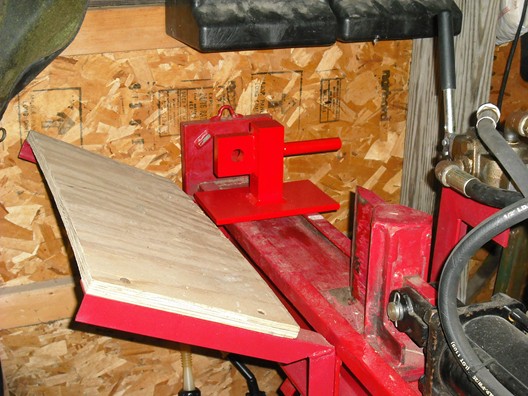

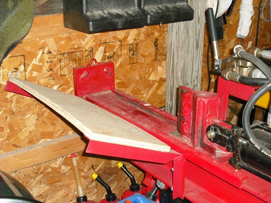

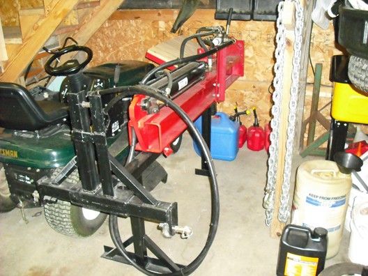

Don't get me wrong, it can be done. I did not want to sound like a jerk. The reality is you can buy one for the same price or cheaper that works right and will hold its value for resale. I built my own 3 point splitter for my tractor and it cost me just as much as a store bought unit but the problem was I did not like any store bought units so that is why I built. I also made an adapter to use my splitter as a shop press that you can see in one of the pictures. My splitter goes horizontal and vertical also.
Chris
