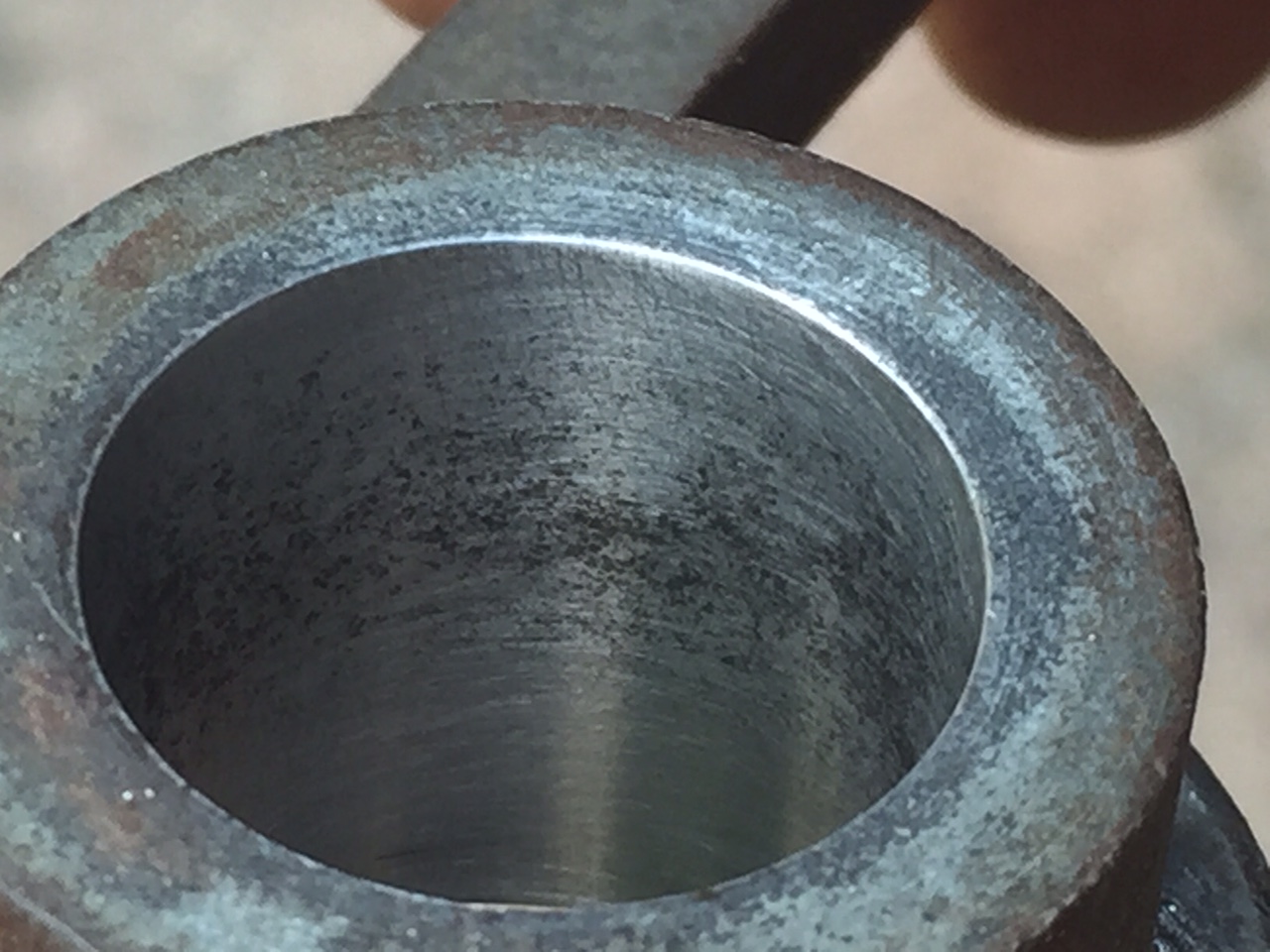

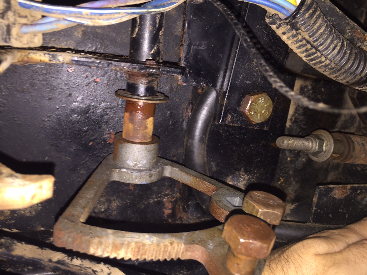

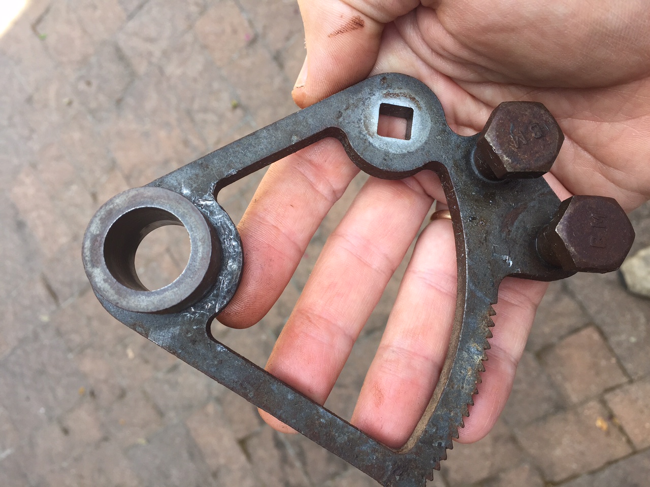

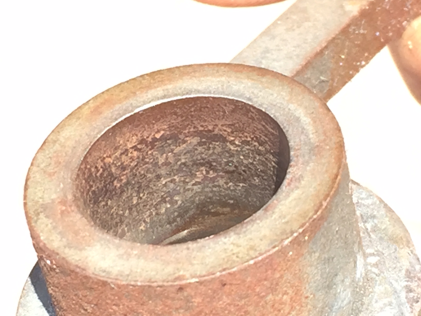

Took most of the linkage apart this weekend until I found the sticky pivot point. It was the pie-shaped pivot piece that the cruise gear locks into - item 8B & 22 in the parts catalog pic. I have a later model ('96) machine, so no bushing, just the part that slides on the shaft which is a fabricated part of the frame. Took a lot of PBBlaster, some emery paper and elbow grease to get it off and then more of that to get the surfaces polished, but it's super smooth and working great now!
   / F935 forward/reverse/neutral linkage and lift power #5
This thread saved my bacon. I bought a used F935 and it had pedals that required serious leg muscle to go forwards or backwards. I thought the tranny was shot, but it turned out to be the before mentioned pie shaped piece that had rusted/corroded onto the shaft. Pictures below. I had to let the piece sit overnight after soaking it with Blaster and then was able to hammer it off with a screwdriver. Pictures below for reference. Once the pie shaped piece was off, wrap a piece of fine sandpaper around your finger and spin the pie shaped piece around your finger (and the sandpaper) to clean it up and it works perfectly now.
