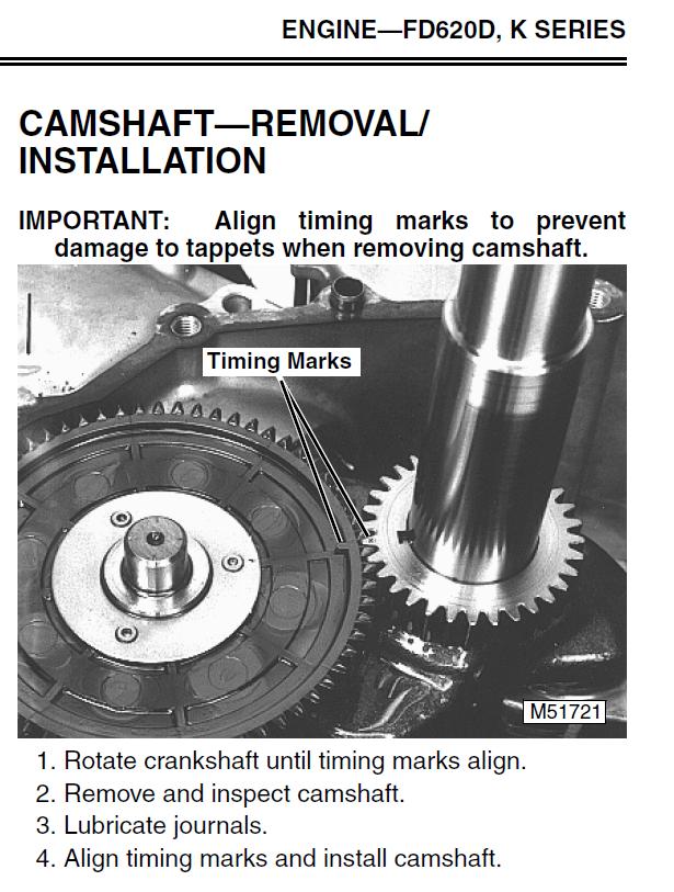

anyone know what the timing marks are on the cam gear of the kawasaki motor?
   / f911 timing marks #2
Should be a small dot on the side of one of the teeth on the camshaft & crankshaft gear. It is a small round dot, might have to shine a light on it to see it.
   / f911 timing marks #3
:welcome:
Is the engine being rebuilt?
Fuel injection?
Not sure which Kawasaki engine you have, but for my 425 with Kawasaki, the tech manual shows these timing marks.
   / f911 timing marks
that is what I thought, but it doesnt run right. replaced blown head gasket and new seals on front. must have done something wrong. thanks fopr the info.

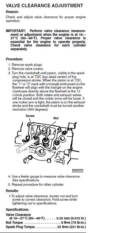

by the way ,what is the clearance for the valves? this is a 22 hp 2 cylinder
   / f911 timing marks #5
This is what I found.
   / f911 timing marks
thanks for that info. checked plugs and gap was a little tight out of the box. runs ok now. thats what u get for being in a hurry
