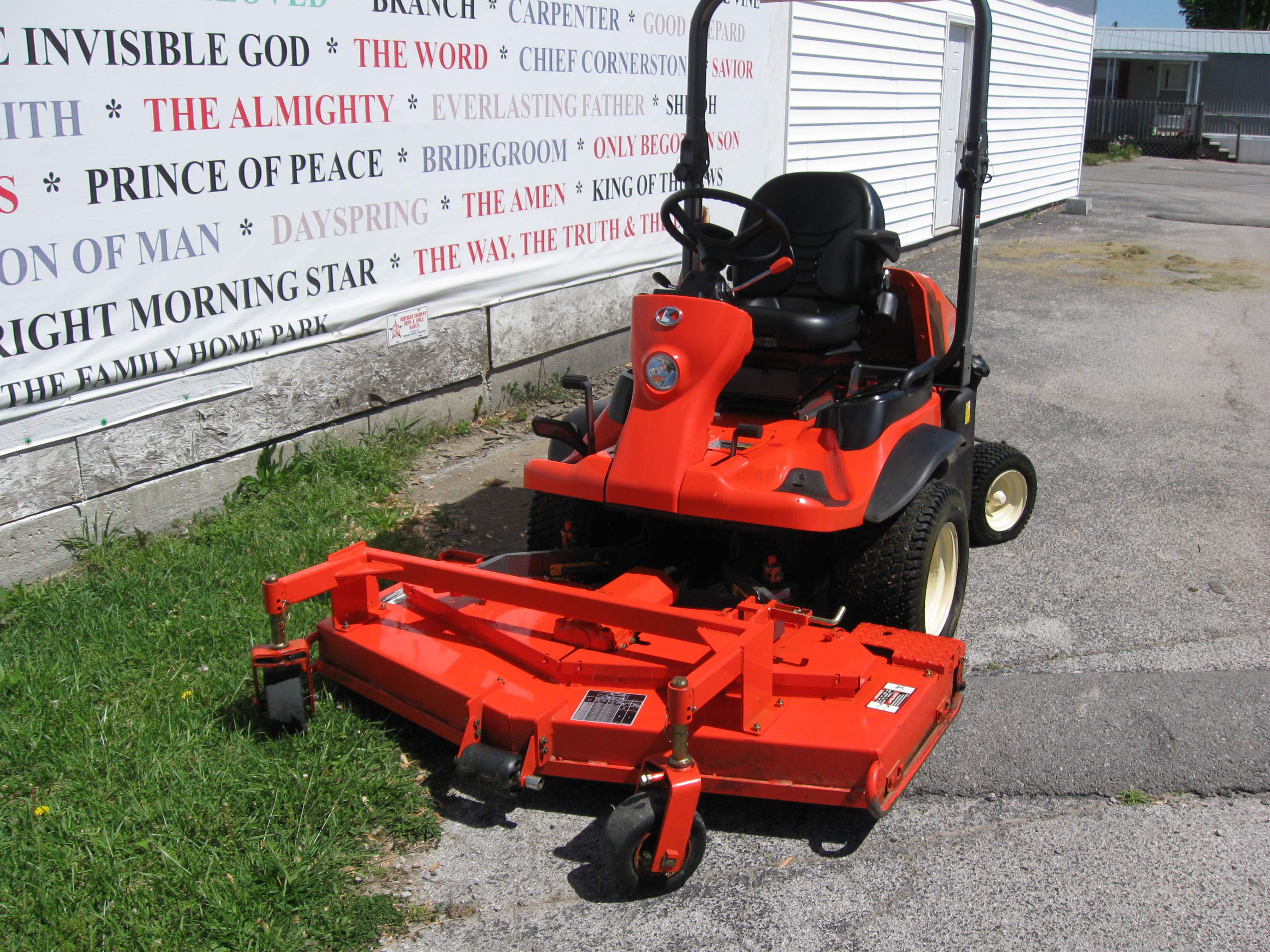

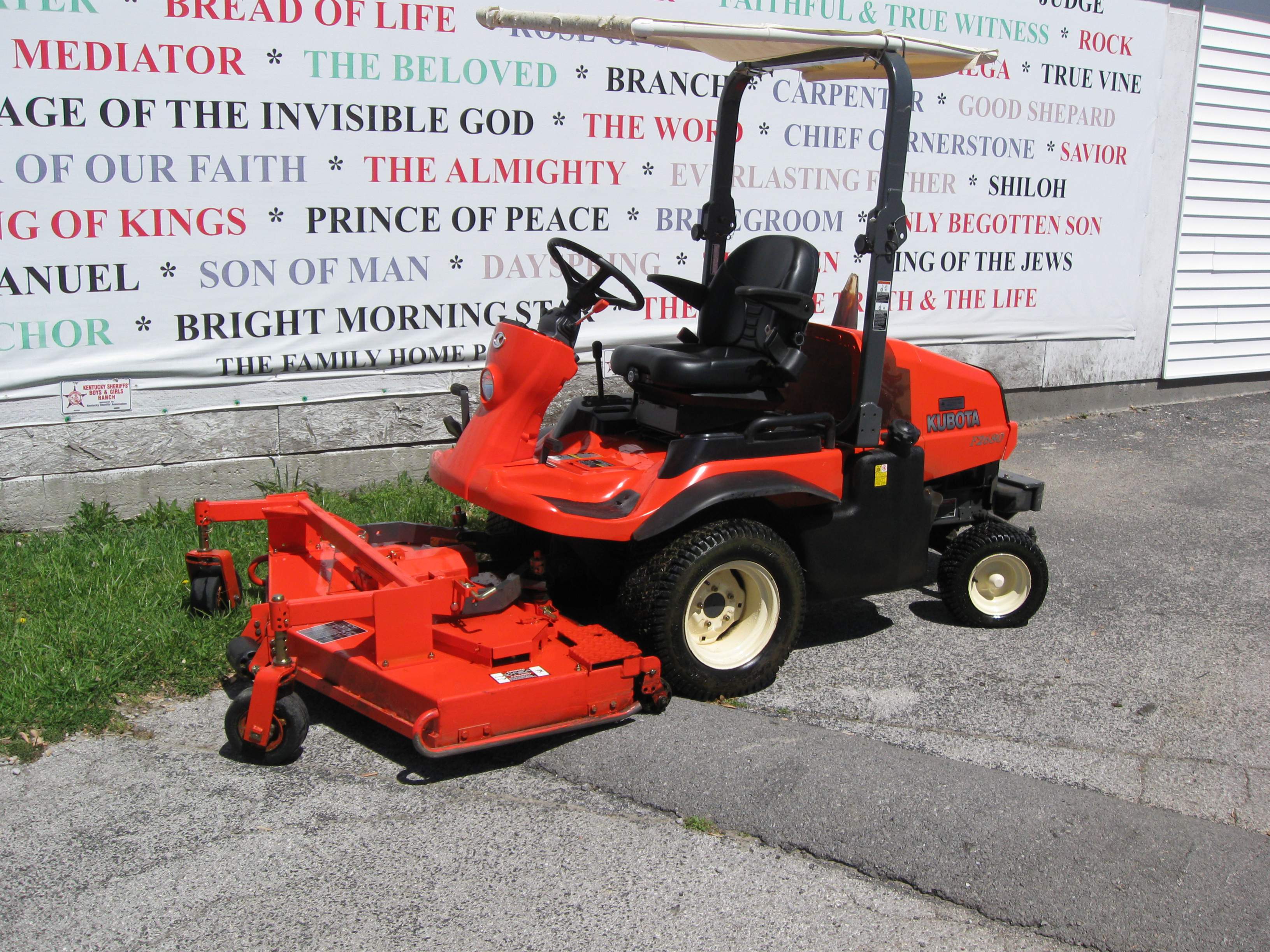

I have an F2680 (For Sale) and a F3080. The deck height on both of mine is done by lowering the wheels on the decks. Just lift the deck with lever, pull the ring that holds the pin that sets the wheel height, let wheel drop or raise to desired height, stick pin back in hole thro wheel shaft and then put clip back thru pin. So simple and so easy.
