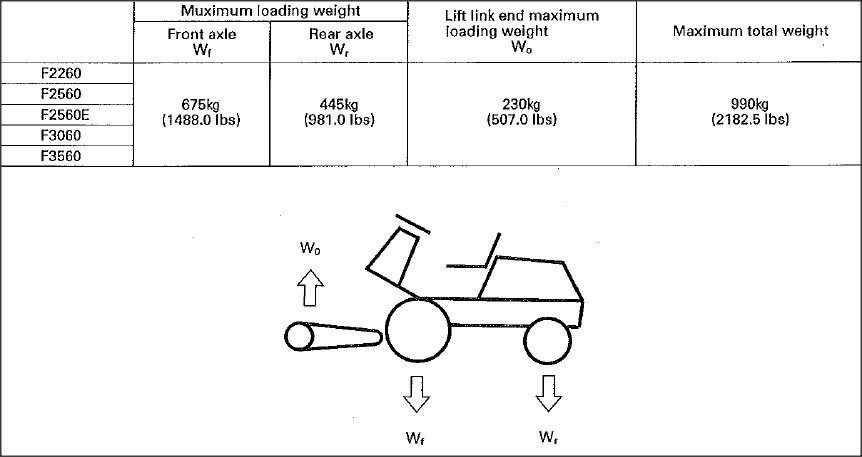

Ive got a ball hitch on my F3060 4x4 and i need to move my Witte MD12 diesel electruc powerplant. Its mounted on a small trailer. The engine is above the axle but the generator is mounted towards the front of the trailer. I think the whole thing is about 4000 lbs and absolutely no idea of the tongue weight. Anyone ever tried putting any kind of weight on the rear axle of their F 3060?
The computer went out of my truck and i sent it off for repair so no truck and the 3060 is all i have to move the Witte right now. Its in a small shed and there is a tree in the way so im not sure i could get a truck backed up to it anyway. I dont want to cut the tree. The 3060 will get to it though.
Any advice is appreciated.

Well in case this comes up for any other members it handled it ok. Didnt even need 4wd. Thanks for the help.

The rear axle max loading weight is 981 lbs per manufacturer.
However I will not even try loading or pulling anything with my F3060, but I am sure it can since it's basically a small compact tractor driven backwards :cool:
For me it's a nice 4x4 lawnmower!
