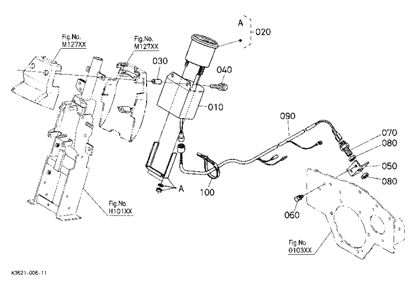

I have been cleaning up and checking everything. I have ordered filters and fluids as I don't know when it was serviced last. The tachometer is not working. I thought I found the problem with a black ground wire broken on the connector for the speed sensor. Checked around for a replacement pigtail and got a shock. They wanted $88 for a replacement connector. I went another route and de-pinned the connector and soldered the wire back together. Problem is the Tach still doesn't work.
