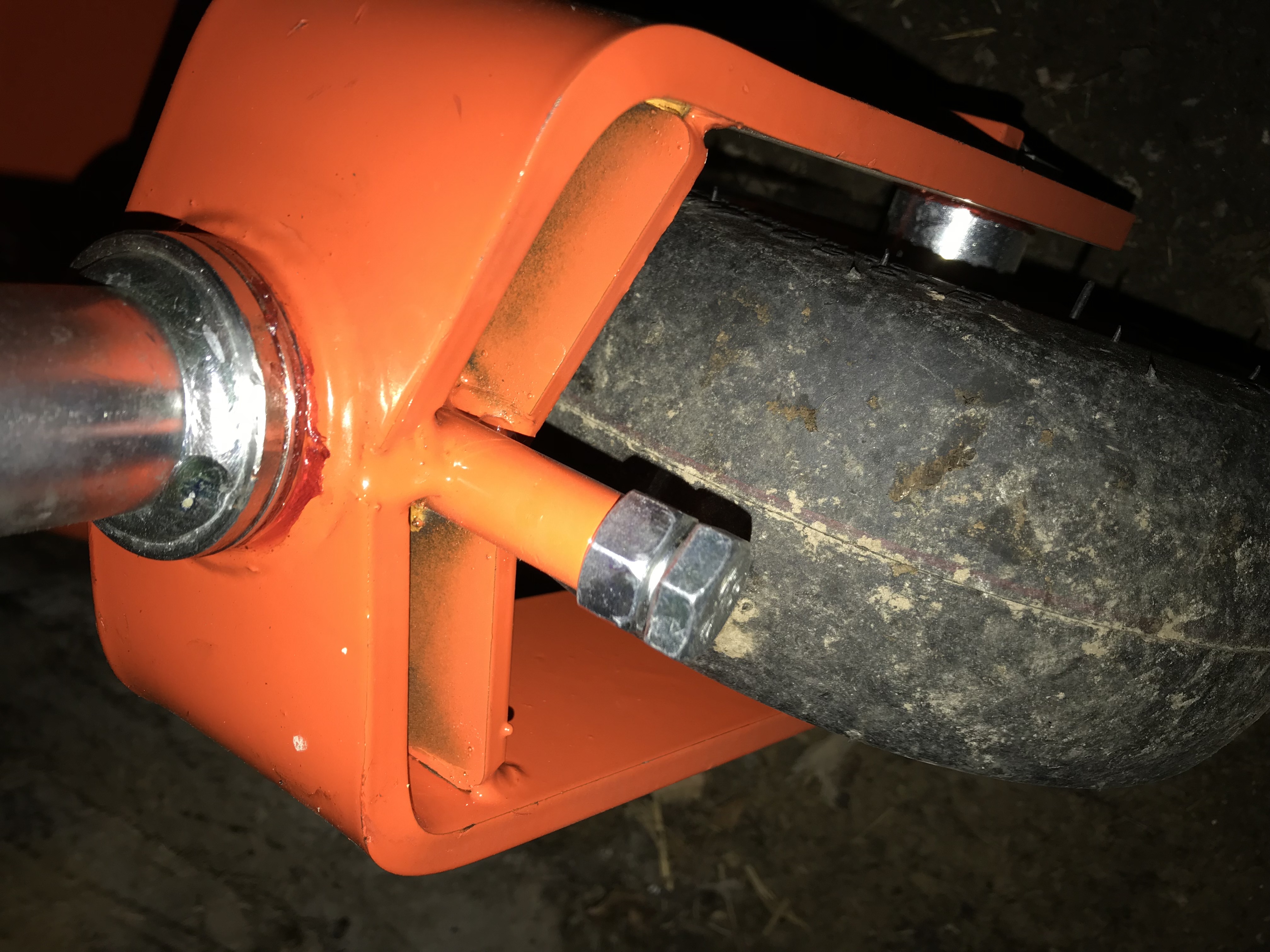

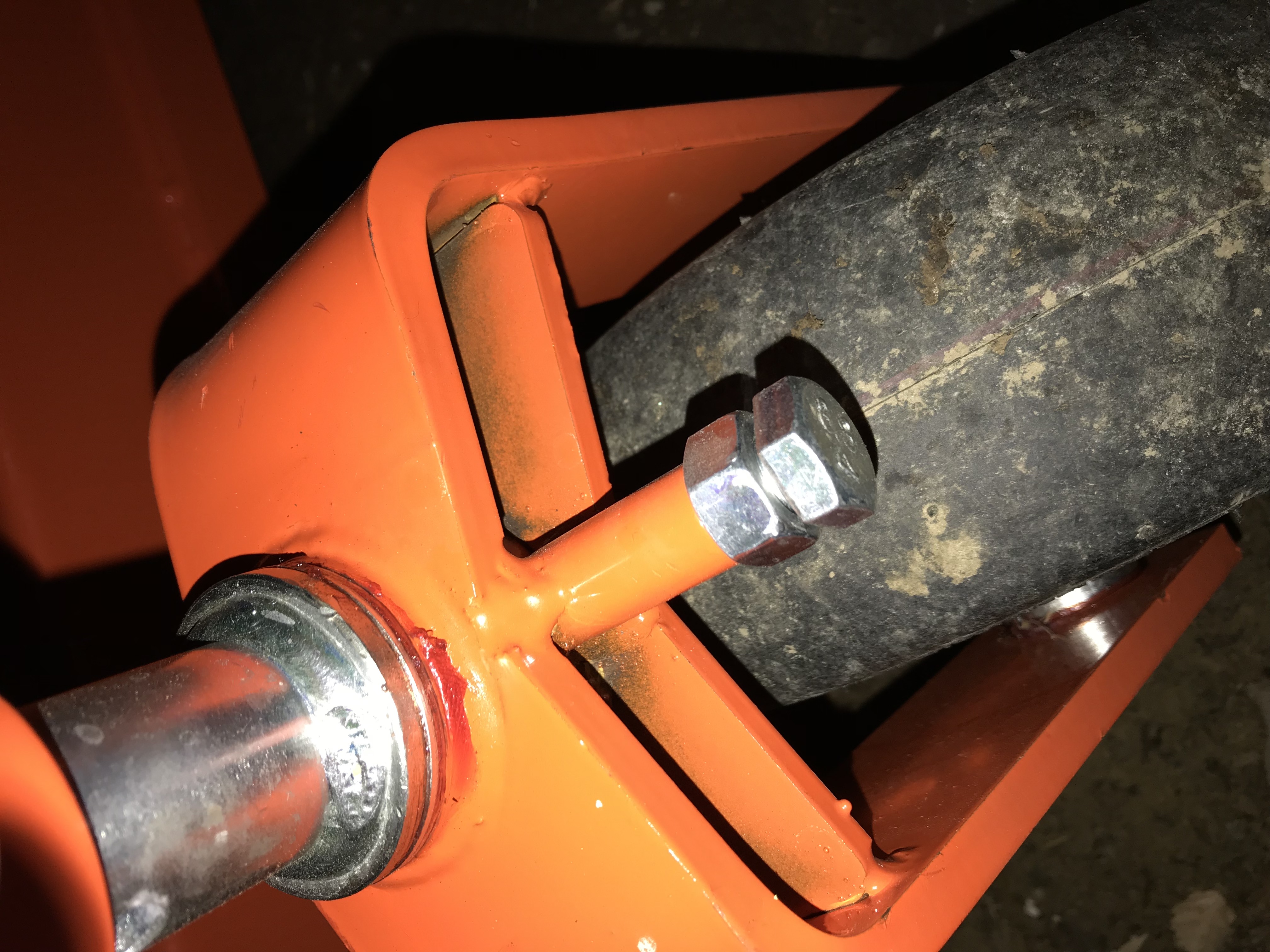

Picked up a new F2690 a few days ago and can't wait to give it a workout.
It's a 2018 F2690, 2 wheel drive, with 60" RD deck.
Too cold here for now, but won't be long before I will need to use it.
Just familiarizing myself with controls and operations and found this thing on the front wheel is? Looks like a "detent" for the wheel?? Is this something new? Came from a ZD326, and nothing like this on that deck? No need really, and can't see a need on this one either. What am I missing?

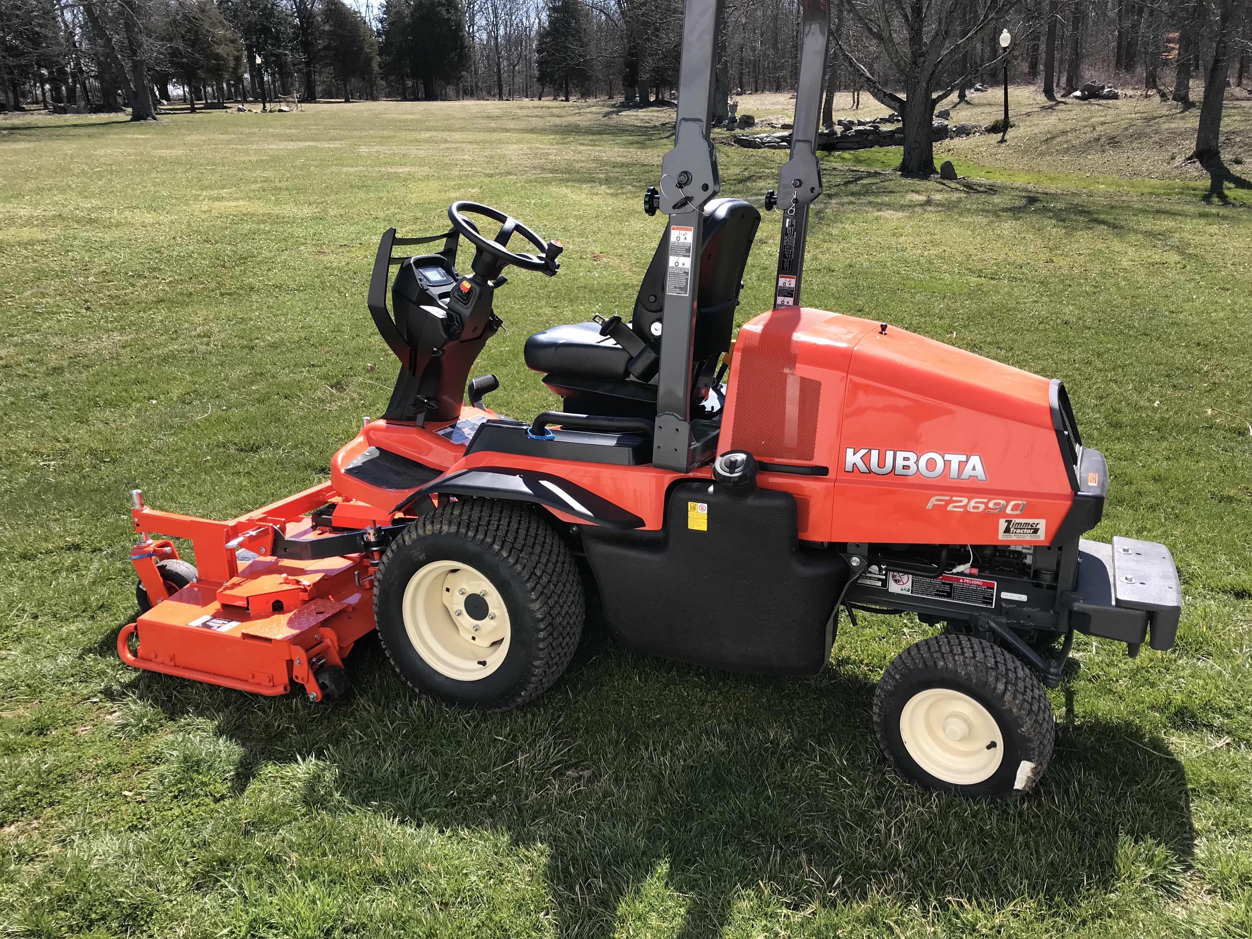

First off welcome to the "F" club. You won't regret it. I came from a ZD326 also. If the picture reflects what you will be mowing looks like you could of handled a 72 inch mower. I looked in my manual couldn't find what the bolts were for, I thought someone said what they are for on the forum, but didn't see it.

It is in my manual: page 19. I have a F2100 It is a set bolt and is supposed to be adjusted when the front wheel starts to shimmy. You adjust the bolt to 7 mm from the base of the prominence to the bottom of the bolt head. I have been mowing with my deck for 29 years and have yet to have to adjust it.

And yes, I thought long and hard about the 72" deck, but in the end went with the 60" as I know it will fit everywhere I need it to go.

Corl: Thanks so much for your answer. I assumed it was some sort of detent arrangement, but I couldn't find anything in my manual (what there is of it) and I have been through it several times. Seems pretty elaborate arrangement for something so miner as shimmy. Glad to hear I won't be making adjustments for some time. Appreciate it.
