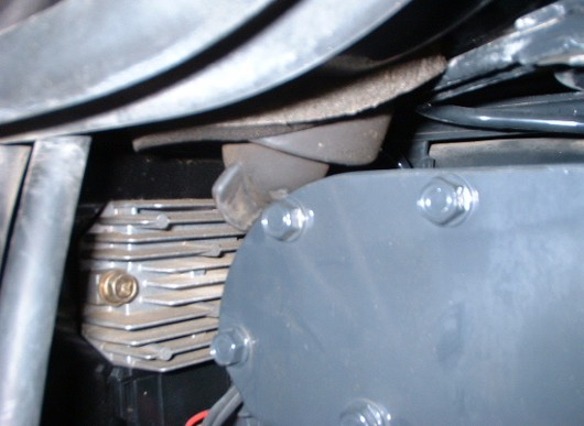

Thanks to all the help contained in this forum I have now established that the regulator / rectifier is toast (alternator works).
Can someone tell me where the regulator is on the F215 and what it looks like? I have attached a photo of the thing I think it might be.

That's it! Takeoff what is in front. Much easier, usually, than fighting the inside bolt.
