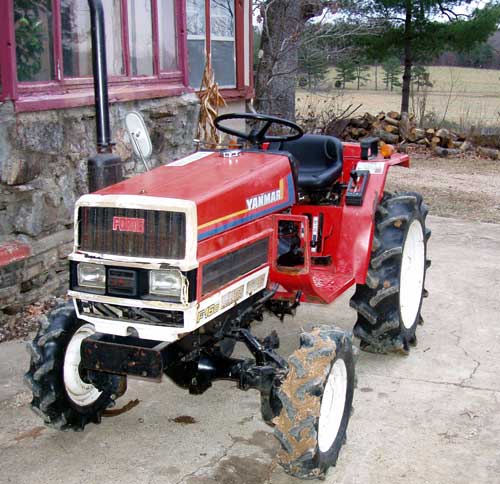

Here is view of my tractor. Don't look like much, but believe me it will get the job done. Have only put a couple hours on it. And it ain't hard to tell that it will do anything I ask it to. And just in case anyone is interested. Here is an update on my tractor "saga". Have mostly finished except for a minor electrical problem. I finished changing the last filter today (fuel). Lets see replacing the ring gear, as ya know. What a challenge! Replaced the seat and decompression cable. Had a local welder fabricate a 3 point mount for me. Changed all the fluids and filters. Gave it a good greasing. Reversed the tires, seems to give more firm of a base. And boy do you need it around here, lots of rocks and hills and hollers. Frustrating at times, but then rewarding when accomplished. Took me longer than most. But guess I can blame that mostly on being a tenderfoot to being a tractor owner. And having to wait on parts. One of the "luxuries" of living 25 miles to a town of any significant size. Anyhow, got it done with the help of a good buddy and enlightenment from this great group of minds. Thanks guys! Still have one minor problem with my dash lights. Can't seem to run it down. Turn signal, dash lights, fuel and water temp gauge all work, but no idiot lights.

Check your ground wires for the lights /forums/images/graemlins/wink.gif Neat looking tractor!
   / f16d update
Hey thanks, I checked the ground wires I could find. Some were corroded so cleaned them and still no lights. Nice looking vette. The first one I drove was a '74, senior in high school so I was thrilled. I own a '84 300ZX.
   / f16d update #5
Most lights, etc. have no ground wire and use frame ground. Use your volt/ohm meter, check for 12 volts and trace back from there, (piece of cake).
