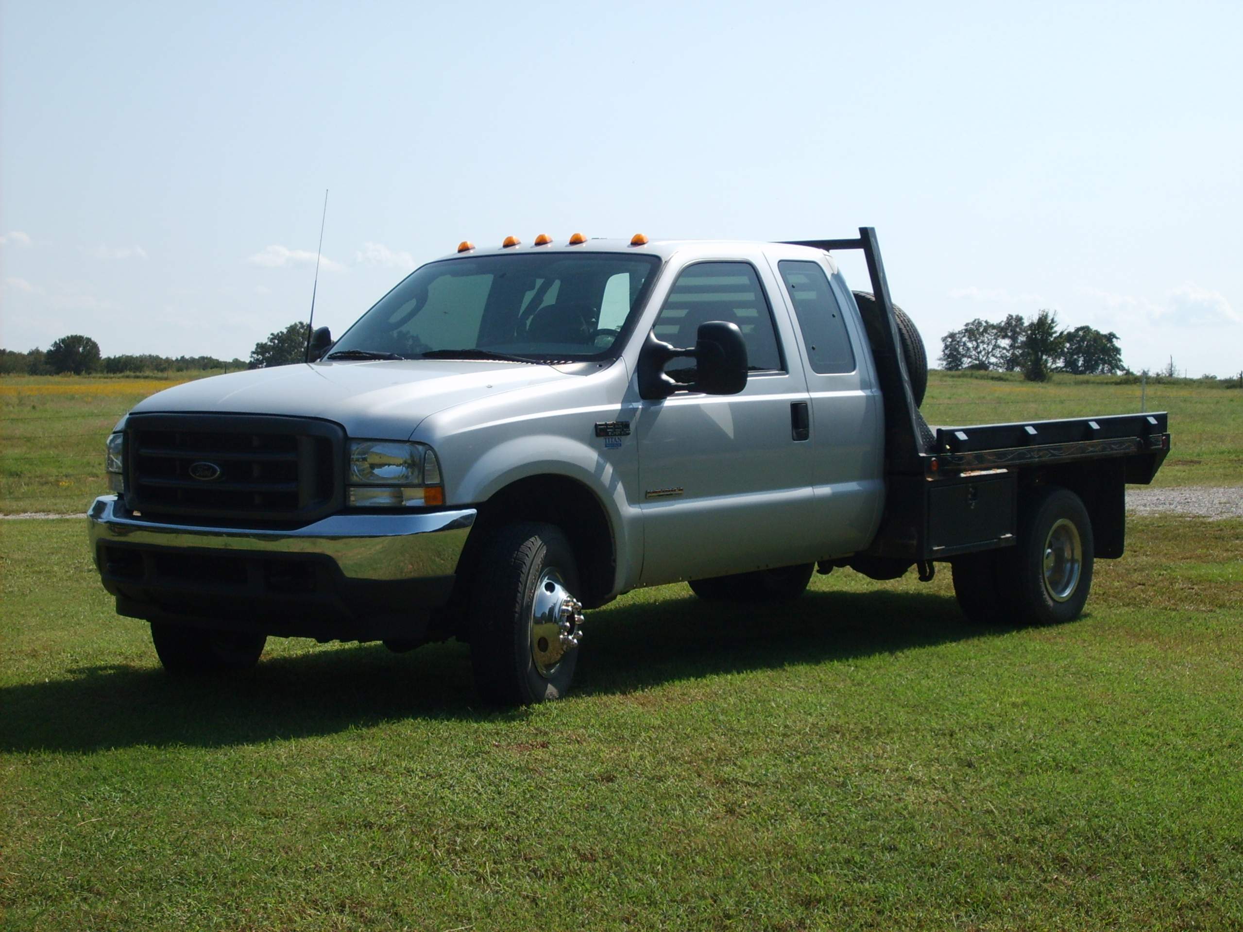

I've got a torqueshift in my one ton. It's the one you've seen here before. After I got used to the way it operates and the RPM's that it and the 6.0L put out I was pretty pleased. I was used to my '99 with 6 speed manual so it took a little while to get comfortable with the way it shifted. Anyway, no complants here. I'm not sure of my weight but usually pulls a 20 gooseneck full of some sort of old contankerous animals!

Your truck is really neat. Gotta get me one of those.
Now that is what a truck is supposed to look like. I love the color it is similar to mine it doesn't show dirt. Now tell me it has rubber floor mats......:D
My dealer had to do a dealer trade with a dealer 400 miles away to get me a one ton diesel truck with an extended cab, 8 foot box and rubber floor mats. Dam city slikers always buy carpet he told me........why would you want that in a truck? I also wanted a manual transmission but he couldn't find one anywhere at the time.

Yes sir, Steve. Rubber floor mats and crank windows and manual locks. First thing to go on my '99 was the door lock actuators! Anyway, when I bought this one I grimaced a little at the auto trans because I really wanted the 6 speed manual but once I got used to the torqueshift I've been fairly pleased.
