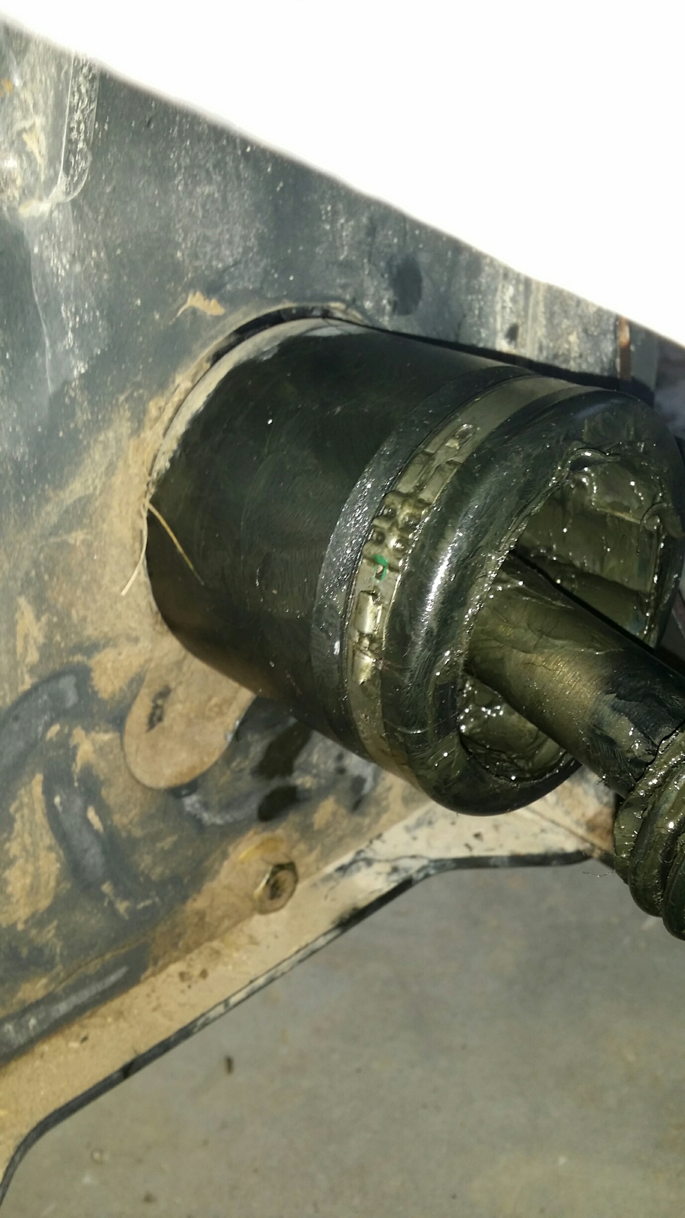

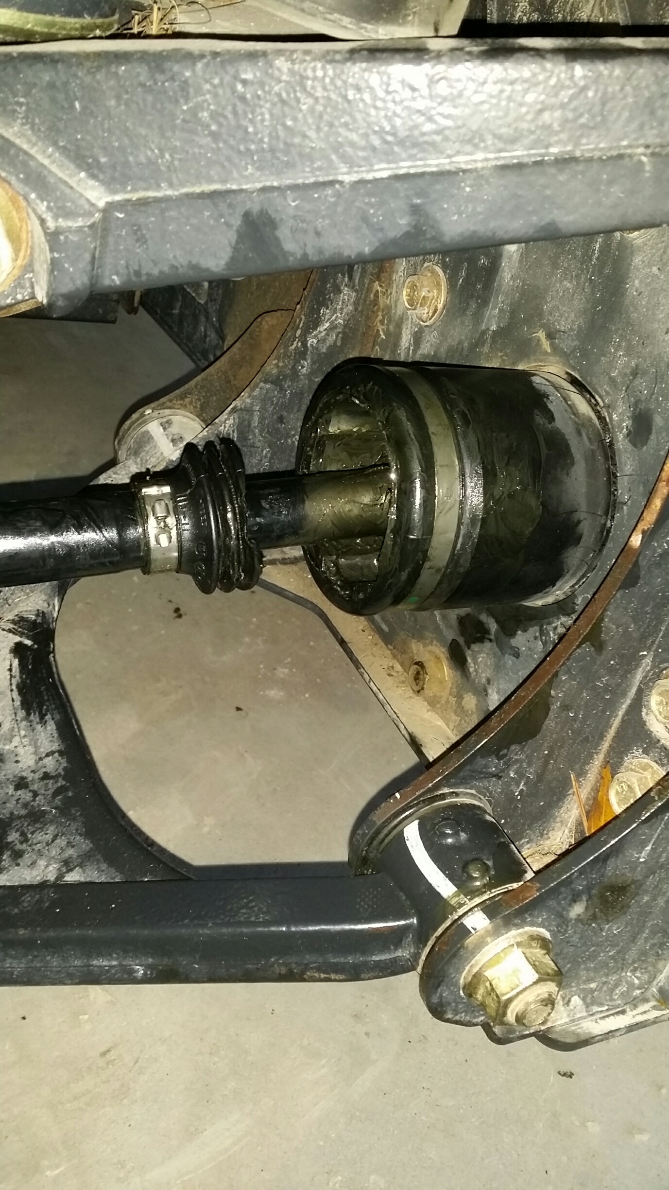

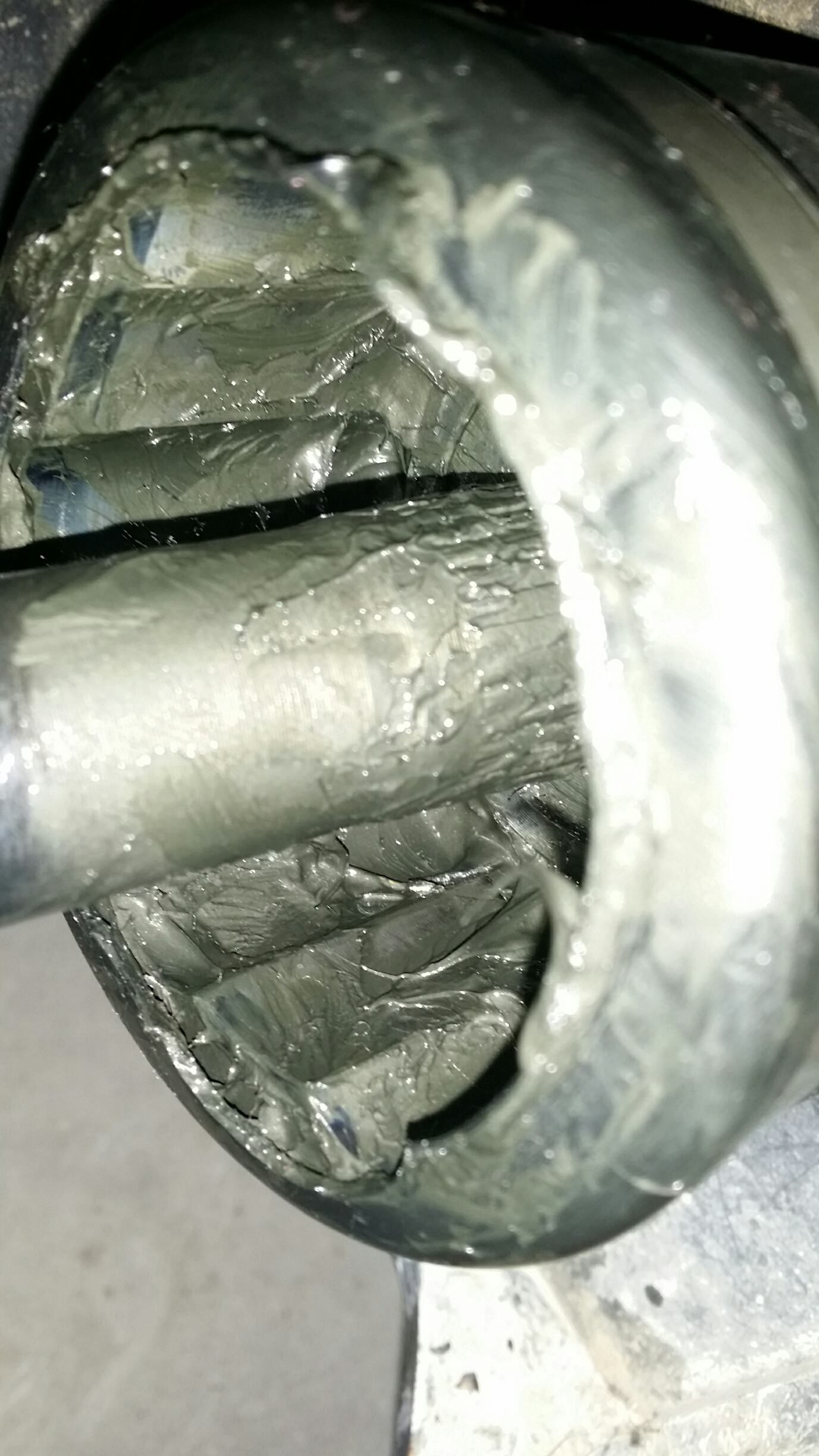

I've got a 2014 F series 5600 (one of the last f series made) and lost traction to my left, rear tire. When I looked, the cv boot was torn and the drive line was out of the hub or whatever it's called. Has anyone seen this? I can't tell if there was a bearing in there or if it's just pushed back. There's a place for the drive line splines but I can't tell if it's the bearing in there. The drive line is too short to reach it which makes me think the bearing is pushed too far in. I have not had this issue before so I'm at a loss as to how to describe but maybe the pictures will help.
Any help or ideas would be appreciated. I'm pretty sure I don't have the tools to fix but I need to be able to describe what the problem is. 20151205_173634_resized.jpg20151205_173508_resized.jpg20151205_173709_resized.jpg
   / F Series drive line #2
Looks like the clip came off the end of the shaft and the spider slid inward. You will need to remove CV shaft to inspect it closer and repair it.
