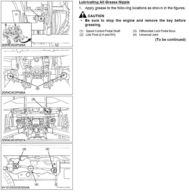

Not sure if this is what you were looking for?
   / F mower squeaking?
No, I have that.
I don't see anything in either manual about general "oiling and lubricating" metal parts (on the mower) other than mentioned per my first post (seat adjuster and throttle cable).
