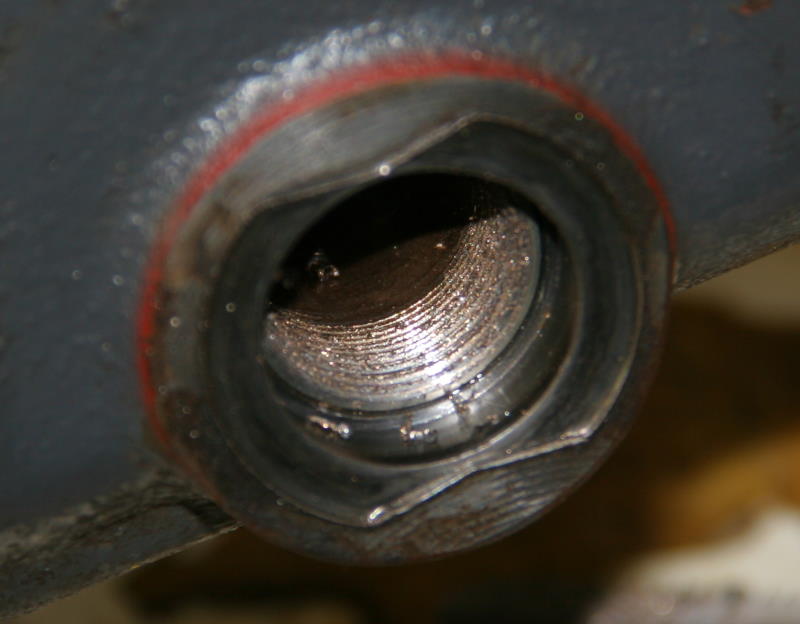

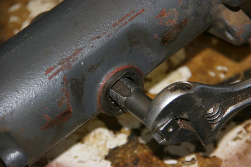

To extract the bushings I first threaded them using a 1/2" pipe tap. The first photo shows the tapping. I put grease in the flutes of the tap to catch shavings, then ran it in, backing up every half turn or so, until it would not go any further without lots of force. The second photo shows the threads about 5/8" or so into the bushing.

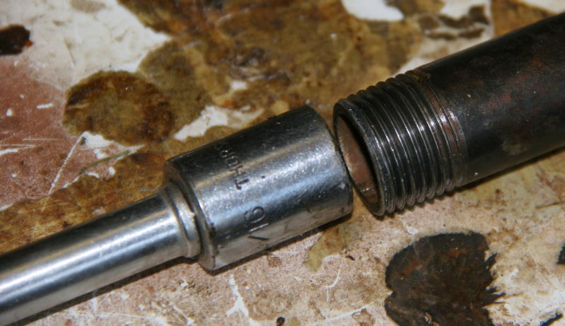

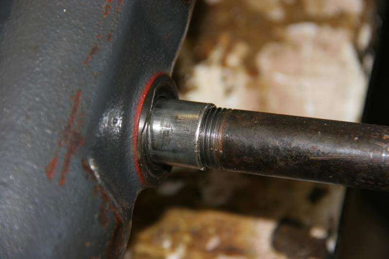

The third photo shows a piece of 1/2" pipe and a socket for a driver. The socket fits just inside the bushings but butts against the pipe. I screwed the pipe into the threaded bushing until tight, then backed off 1/8 turn so the tapered pipe thread did not excessively expand and jam the bushing even tighter. I then inserted the socket and extension through the opposite bushing and tapped with a hammer. Presto, the bushings were easily driven out, 4th photo. The job took just a bit over an hour.
