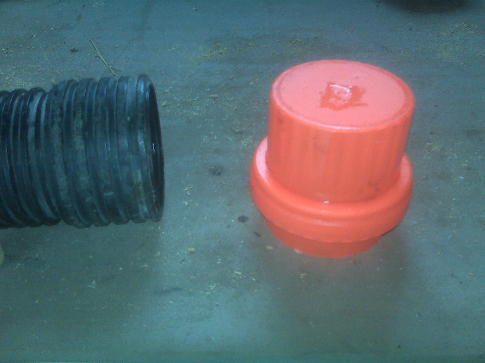

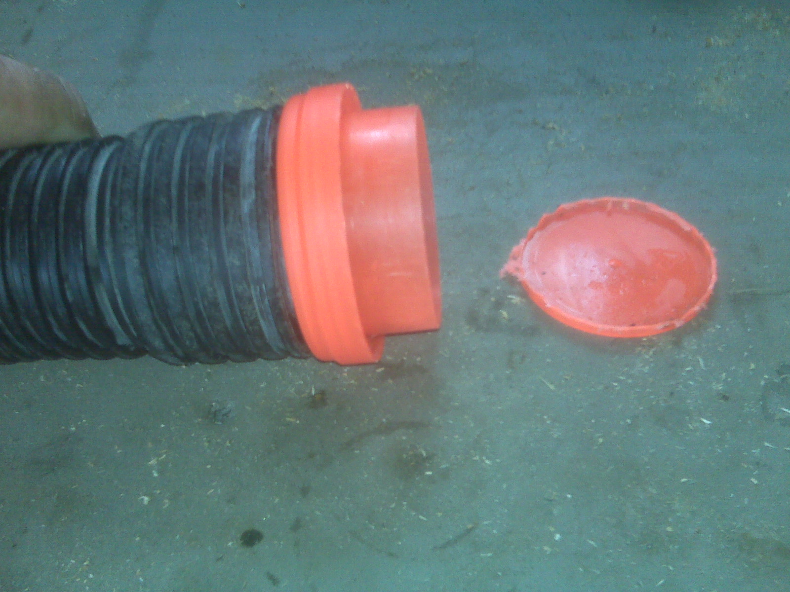

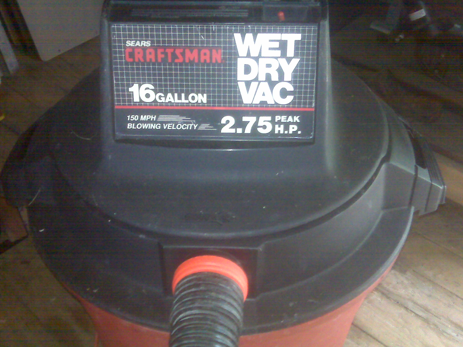

I am sure many of the TBN members have a shop vacuum with a 2 1/2 inch hose, if you are like me, you will sooner or later break the hard plastic swivel end on your "crushproof" hose. Of course you cannot buy just that part, they want you to buy a new hose instead.
I fix mine with caps from an empty bottle of Clorox Stain Fighter and Color Booster. Cut the very top off the cap, and odds are it will be a press fit in both the end of the vacuum hose and the vacuum port. No, it will not swivel, and no, it isn't color coordinated. But is it ever a fast and cheap repair.....:thumbsup:

Nice fix ! Gotta love the no cost fixes !:thumbsup:

Does this mean I now need to start taking stains out of my clothes and try to make the colors brighter? There is always a downside to everything!:laughing:
Seriously, good tip and thanks.
