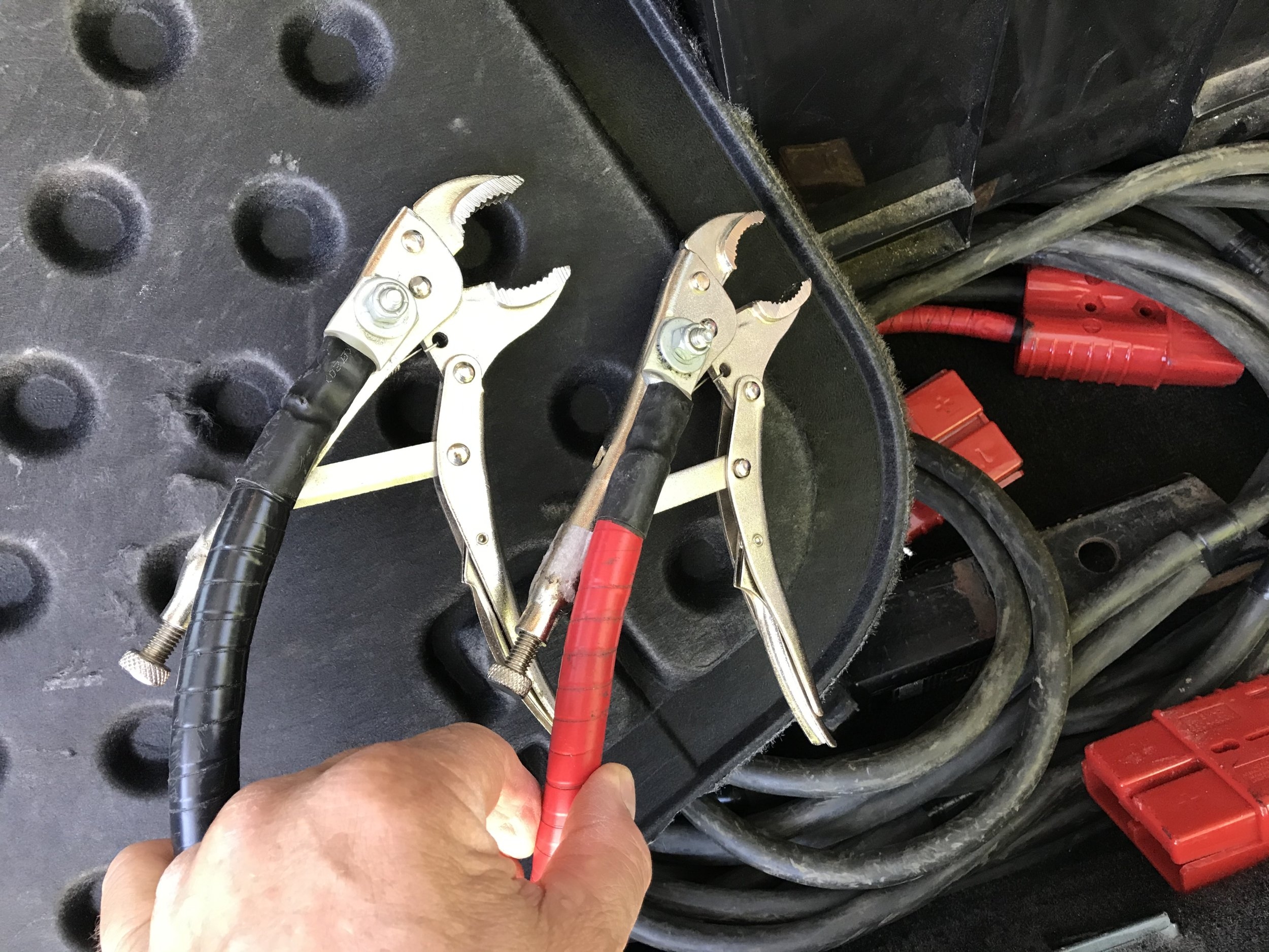

I got tired of having to pop the hood every time I wanted to connect alligator clips to the battery. Cigarette lighter sockets used to be a convenient place to tap into 12V power, but many new vehicles don't have them. They are also limited to less than 10 amps and often controlled by the ignition switch. This simple, cheap adapter makes it a snap to hook up portable compressors, 12V tools, battery chargers, etc. without having to lift the hood.
It works on any vehicle with a 7 pin trailer wiring harness connector, and provides a convenient place to connect alligator clips. Most pickups and SUV's have a 20 - 40 amp trailer auxiliary circuit which is always on and not controlled by the ignition switch.

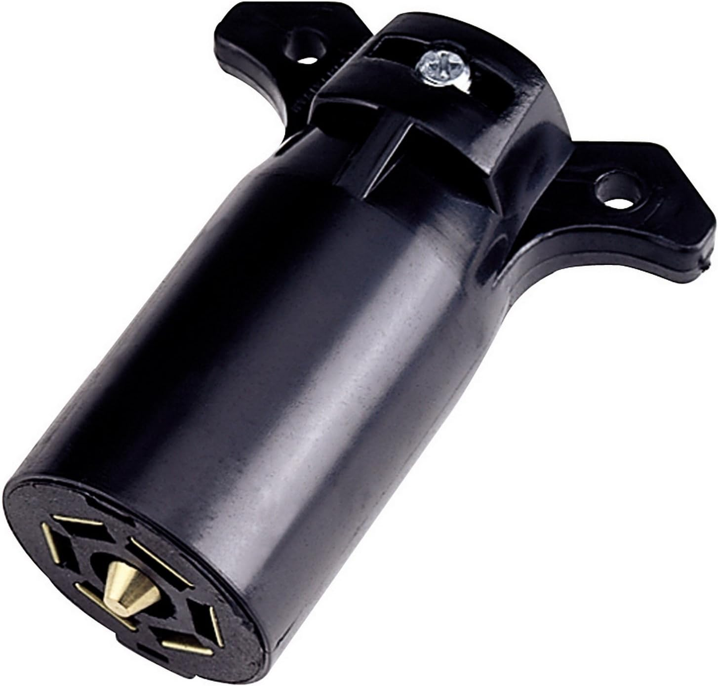

It's made from a trailer harness plug such as this one:

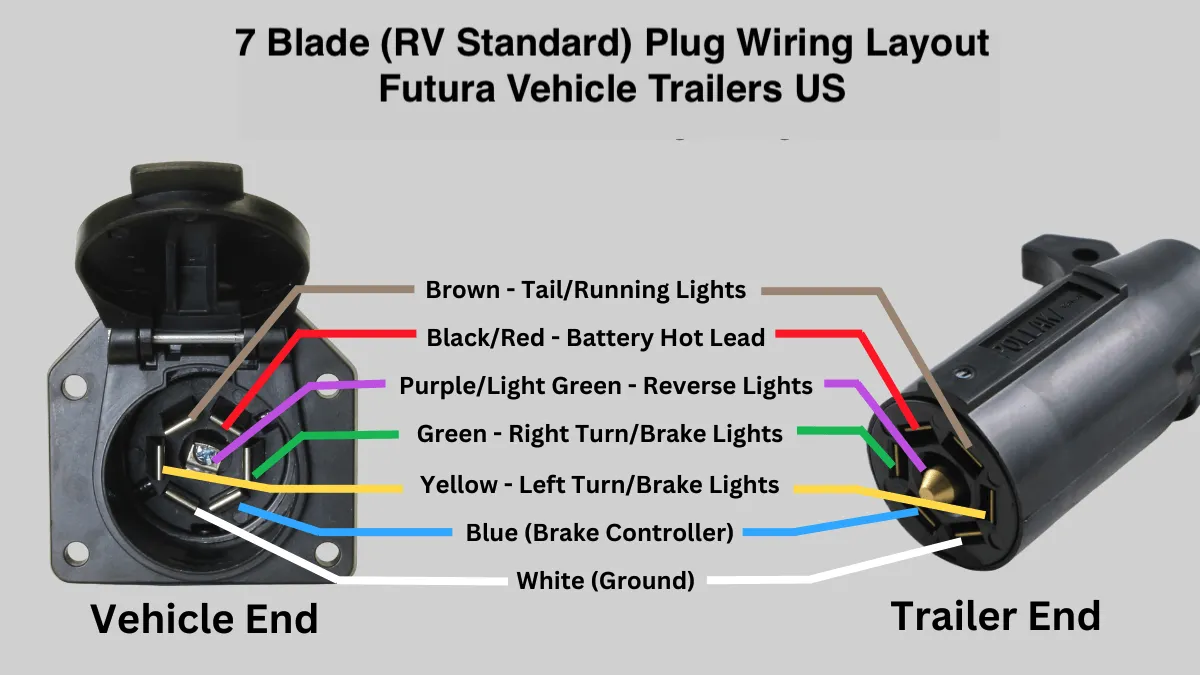

Using #10 wire, connect the appropriate connector pins, usually red & white in the diagram, to bolts placed thru holes in the handle. The bolts make a convenient place to connect alligator clips.
It took about a half hour to put together and cost less than $15.
