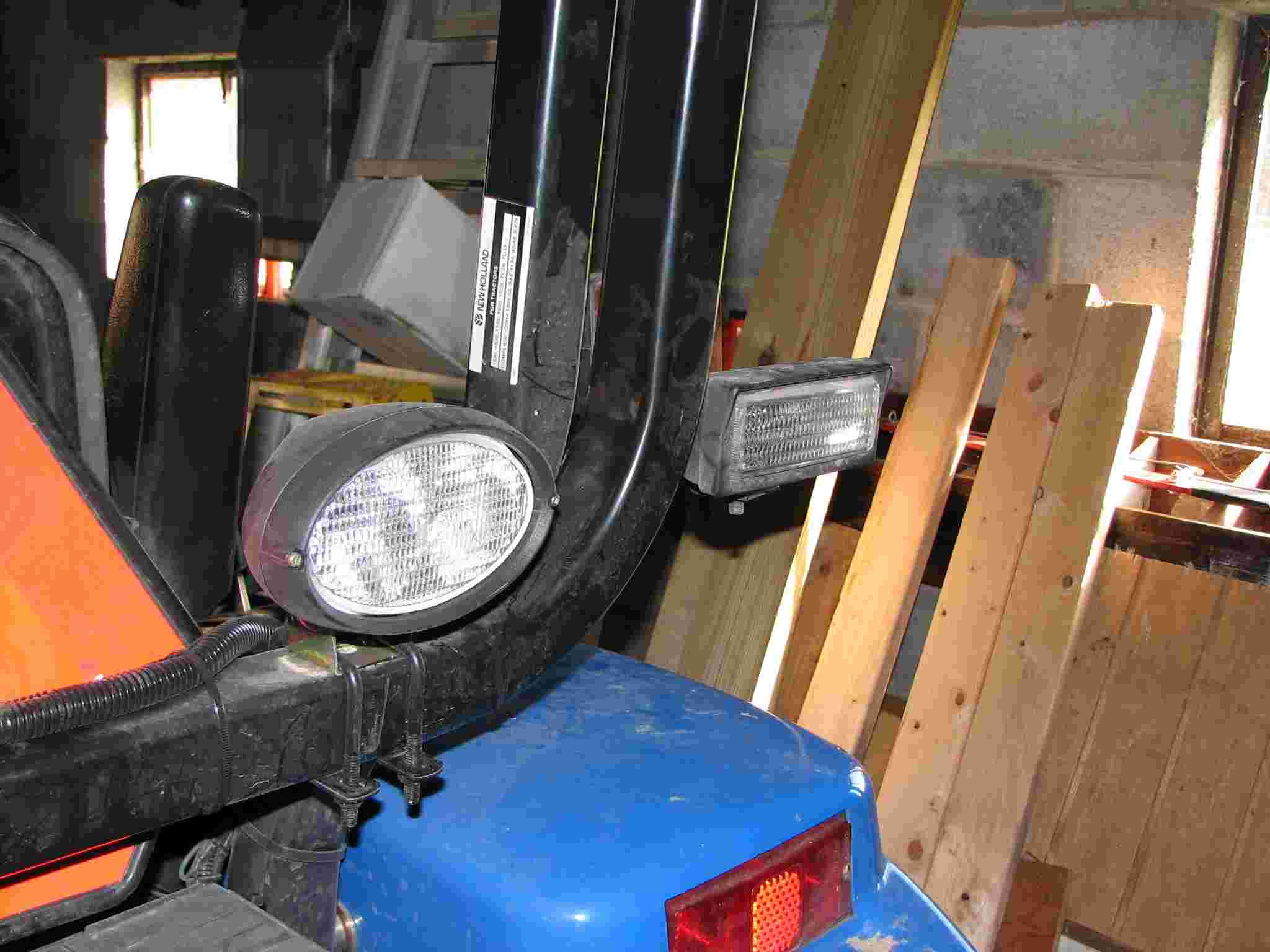

SOS said:
Are there any optional lights that NH sells or are there any good 3rd party providers of lights?
Here's what I have installed on my tractor. The same set of lights are on the left side.
Each set of lights are on separate switches. The rear facing square lights are connected to the factory work light wiring. I ran a separate, fused circuit for the oval ones that face front when the ROPS is up and can be aimed to shoot out above the FEL. Invaluable when plowing snow in the dark, not to mention making the tractor easier to be seen when on the road. The rear facing lights can be angled to illuminate the area behind the tractor, including the 3ph.
The square lights are attached, with a bracket, to the same bolt that holds the orange lights to the tractor. The oval lights are attached with square U bolts I painted black to match the ROPS.
Both sets of lights are actually aftermarket automotive lights.

You also need to purchase the mounting bracket, and you have to be creative on how you mount the bracket to the ROPS. I ran a smaller diameter stainless machine screw/bolt through the welded on "mounting" nut on the ROPS and bolted it in behind the welded-in nut. In my initial purchase "exhuberance" I also bought two lights and brackets. The bracket is "right handed", but it really does not matter. I have plenty of rear lighting now :D! At some point I am going to attach lights to my FOPS. Jay
