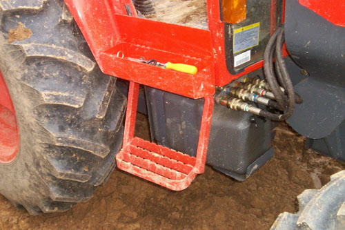

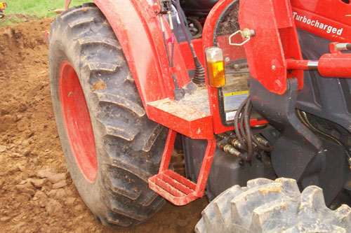

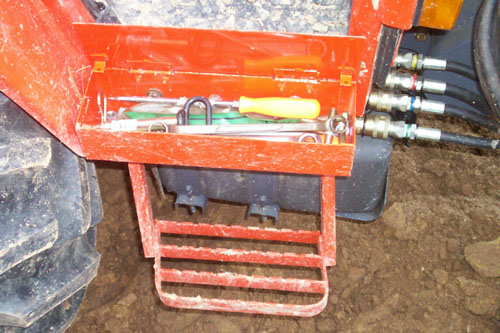

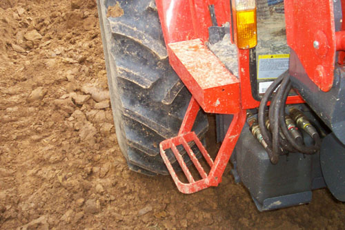

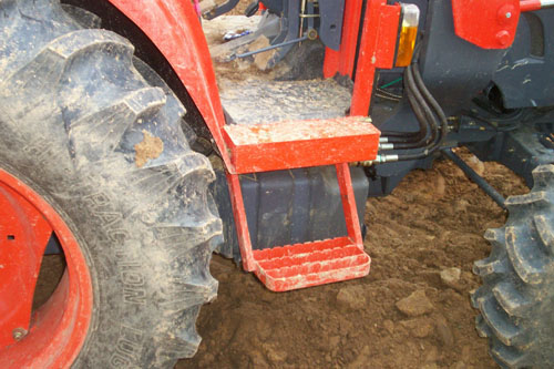

Ordered a replacement tool box from dealer....drilled two 1/2" holes in it on back side......then drilled tubing that runs across the right hand step....and tapped the two holes for 7/16" x 14 threads....bolt.....had to use 3-4 washers between the box and the frame , so that the lid would open....works great!....
and is not in the way attall...can still use step and top is about even with floor mat......
This set up is much more convenient than toolbox behind the seat.....as for drilling and tapping the holes, it doesn't weaken the framework.......at all......if anything will make it stronger.....Mike

I mounted a replacement one above the step on the right side..the top is slightly higher than platform floor...but it goes from the right rear fender to the upright where the glass is....It is almost completely out of the way..one could stand on it or use it as a step....
Now for the size....
15" long
4-3/8" wide
from 3"to 4-3/8"deep
the bottom slopes.....
also has two places to put springs on lid to keep it closed...
One behind the seat has 2 and I think that I will take one off and put it on the extra toolbox.......

Here are some pictures of toolbox installed on right side of DK55 Tractor..
Somehow it got muddy before I got to take pics.....
Will upload a wider view, later...Mike
