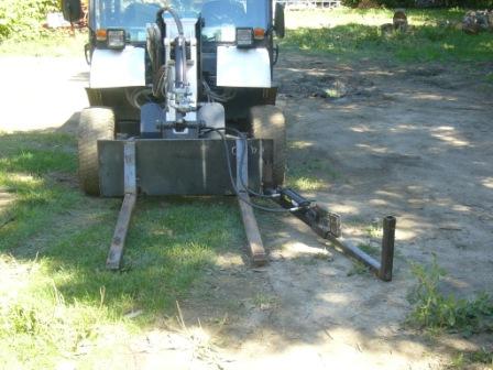

I had some extra parts and steel laying around the shop and with 10 cords of wood to split ... I welded up the toolcat fork and woodspliter combo.
The tc powers the spliter and then i can stack the wood on a pallet for later. Really handy and it works quite well.

very cool.
I have an extra tree shear cylinder and an I beam I would like to set up for a splitter. Need to figure out how to mount it, though. Was thinking of using my forks or buying a quick tatch blank.
