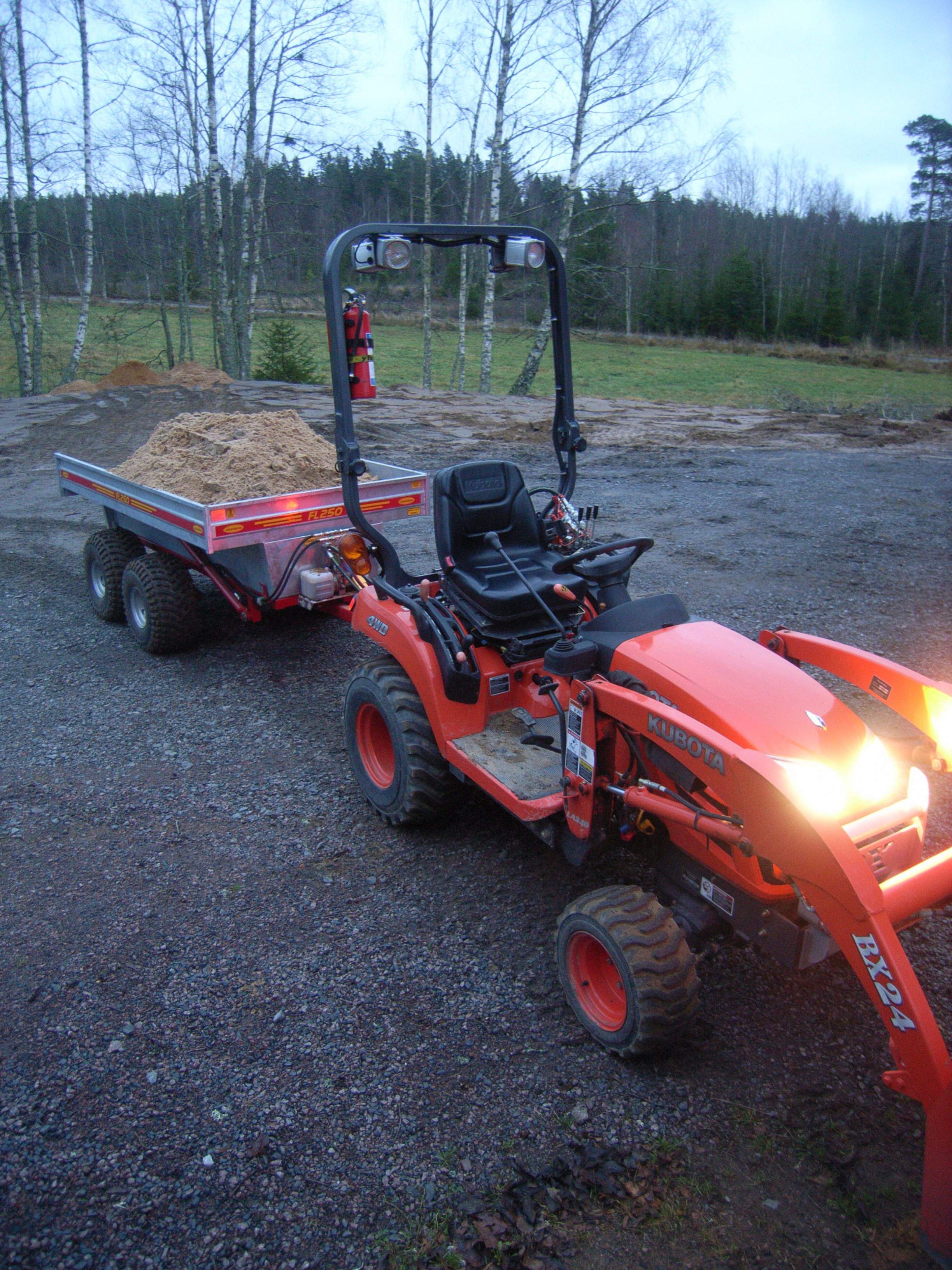

Hi just want to post some pics how I did to solve the problem with no extra hydralic on my BX. Now I have two dubble acting circuts and one single acting.
Please excuse bad spellling (I from the other side of the Atlantic).
Now I can run my Dumper trailer:thumbsup:

Nice setup! I have selected the same area for my next project. I already have a single spool and was planning to make a mount to connect to rops bolt posts like you did. Did you run into any problems or wish the handle was lower and more forward ?

Nice - You have hydro lines and lights running everywhere - How much time and money have you invested - Would love to set my tractor up like that!

Radioman, It works good with this setup, I havnt noticed any handling problem conserning speed travel. I done the same setup as kubota does with the backhoe setup as long as you dont use the hoe/extra hydralic the oil passes throu the block. But if I conect the backhoe I use the orginal setup, its easier to do it that way.
Funwithahoe, thanks I love this little tractor, and Im very impressed with what it handle, I do use my BX24 in my part time landscaping buiness. Dont know how much I spent but I would say, not so much money, more time in building/welding etc. I do mostly everything by my self. Of course I spent some money on diffrent application.

Sam where did you tap into for the hydraulics?? Pics if its not too much trouble

Thats what I have been thinking about but wasnt sure if it would work. Thanks Sam.
   / Extra hydralic on a BX24
Simple solution, and you can still conect the hoe. Send some pics when you have done installation.
