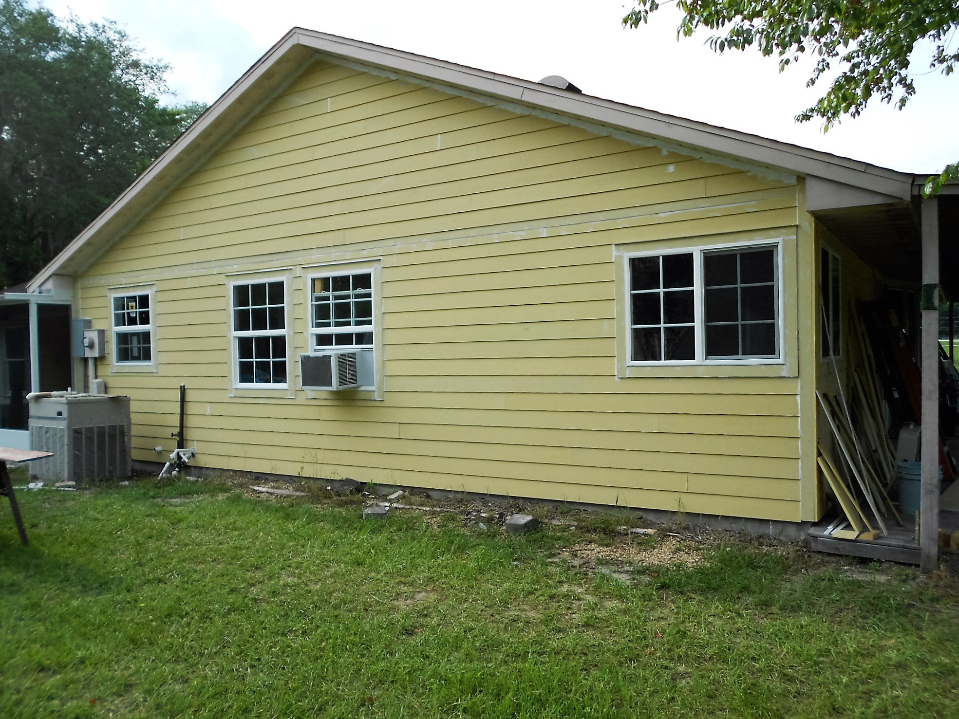

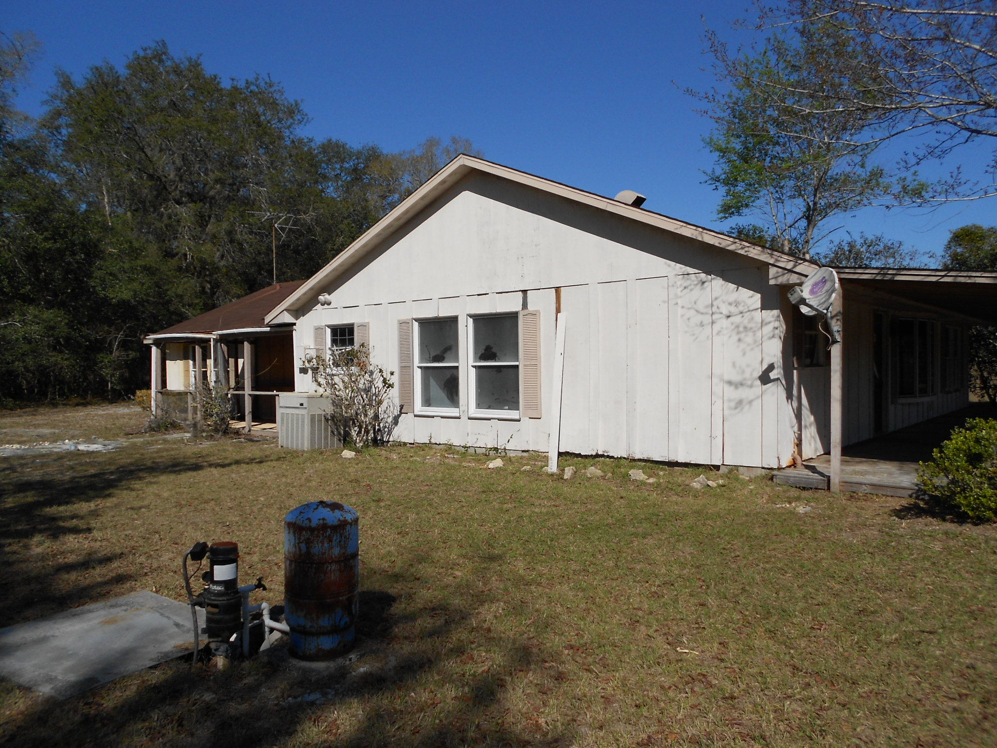

Here is before, after primed and after painted Hardie Lap Siding on my 2564 sq ft house.
I sided the WHOLE house by myself 2 years ago.
And I had to use Hardie Backer Screws on the whole house because it has metal studs.
Just read the instructions and follow them.
