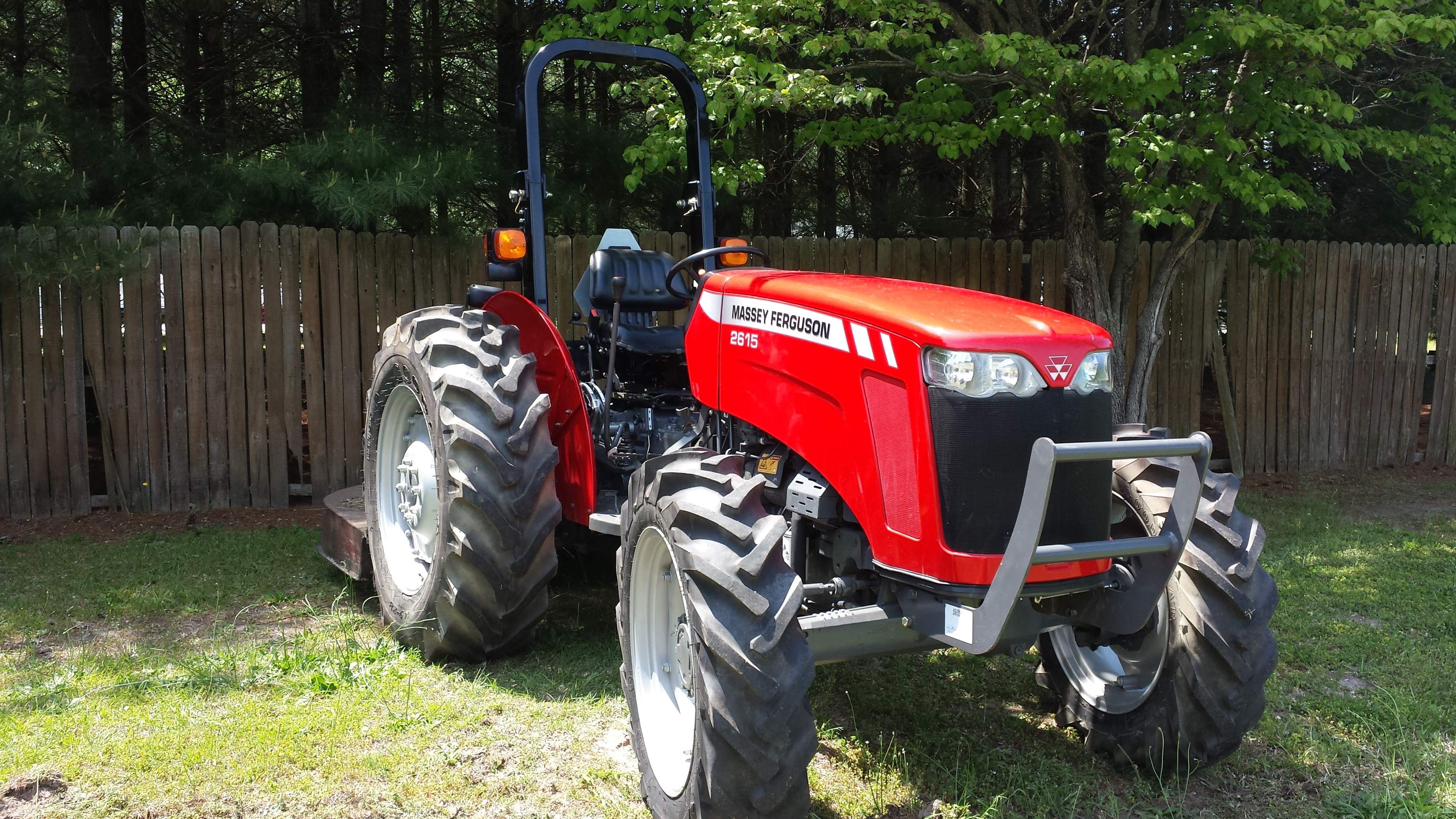

I just purchased a 2014 2615 with approx. 500 hrs about a month ago. Bare in mind that mine doesn't have a FEL and I don't have much seat time yet... but I can say that this is a very stout, easy to use, no frills tractor. Mine has the 8x8 shuttle shift with 4WD and independant PTO. So far all I've done with it is bush hog my pasture and it has been great! So far I am very pleased with my purchase.
