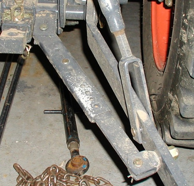

Telescoping = pop a pin, lift arms swing freely. Pic attached.
Turnbuckle = as name implies, twist one way to lengthen, other to shorten.
It's a lot easier to swap implements with telescoping bars. Telescoping bars require no tools. Telescoping maintain their length setting. Telescoping can be set to limit or allow a bit of play by selecting round or slotted holes to drop the pins through. Using the round holes limits the sideplay almost entirely. With telescoping, it's a snap to shift the implement's position behind the tractor.
Telescoping disadvantage, let me think. OK, you can lose the pins?
I have one tractor w/ turnbuckles, and another w/ telescoping. IMHO, telescoping is a dream compared with turnbuckles...................chim

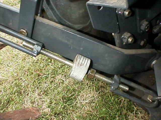

I still have turnbuckles, but I have added an assist to make it easier to turn them.
I cut off the big end of a quick hitch adapter, knurled it for a better grip, welded it to the nut that turns the turnbuckel.
Now I can turn it easy with my fingers, no wrench needed, and I keep it lubricated to avoid rust.
Not as easy, but simple and free. you could weld a bar, or a square, or a large nut and do the same thing
See attached photos.
Jim C

OK Here is the 2nd photo
