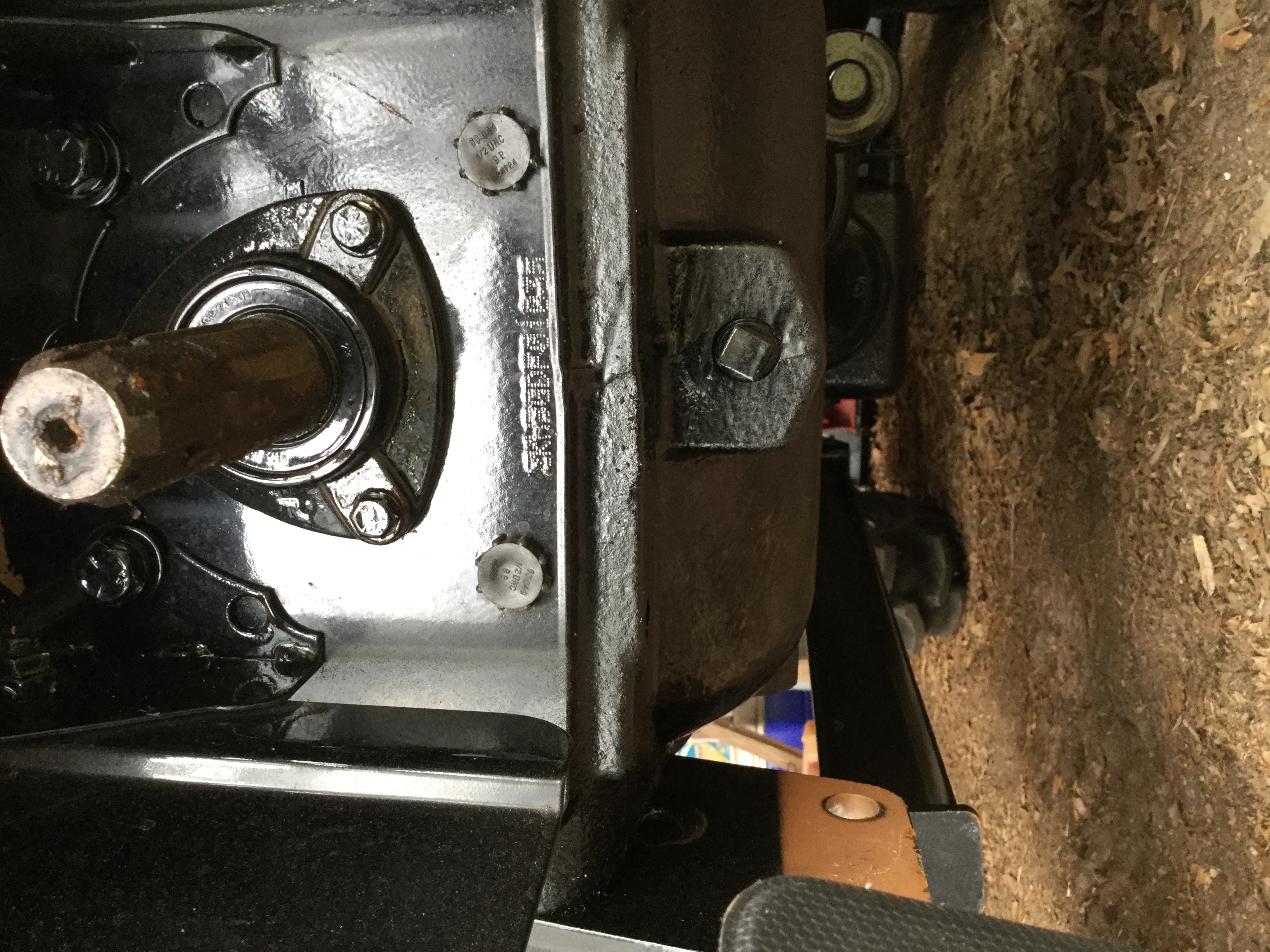

In my owners manual on page 79 top of the page it states that the oil reservoir is common for the transmission, hydraulics and steering. A little farther down the page it shows a picture of the transmission drain plug, labeled C.
It seems to me that it would be a little more convenient to use the drain plugs rather then disconnecting the hose that goes to the screen.
There seems to be a slight problem on this however. Close inspection seems to revel that the drain plug is ABOVE the screen so that when you take the screen out you are still going to get a lot of oil all over the place.
I have found another drain plug, I think. It is located below the PTO shaft, and seems to be the lowest point on the tractor. I can not find anyone that knows what it is for however. I guess I could take it out and see what drains out. Perhaps someone could help us out.
   / Experiences with cleaning 4540/4550 transmission strainer #5
My 4025 has two, a rear plug like your pic, that drains just the rear end, and one on the belly of the trans. Only about 1/2 gallon came out of the suction screen housing after draining the belly plug.

I checked my owners manual because of your post, and on page 105 (the Lubrication and greasing Chart 4540/4550 4WD) item 19 (lower right hand corner) is the plug you mentioned. It is indeed a Transmission oil drain plug.
