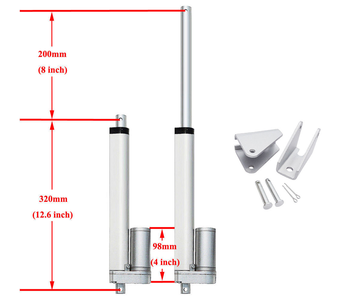

My neighbor got a round baler for his tractor (quite used, I have no idea the brand because there weren't any markings I could see today looking at it.)
His problem is that he says his tractor hydraulics are strong enough to lift the gate on the back of the baler, but that's pushing them to their limit, so he can't also operate the hydraulic piston that actuates the baling cord mechanism (which I guess cuts the cord off?)
He is therefore looking for an electric linear actuator, but says all he found in Czech Republic was 500€, which is kind of steep. I told him I'd have a look, as knowing English gets you a lot further in internet searches.

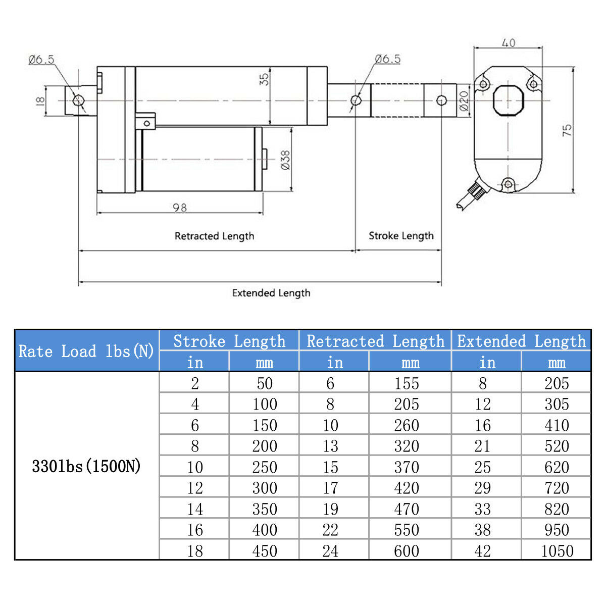

I've seen before and found now linear actuators on eBay, of course Chinese, which are even stocked in German warehouses, which are the right dimensions for him (320mm retracted, 520mm expanded), but I just wonder if they aren't "too good to be true"? They claim an IP68 rating, which means waterproof, which I'm supposing is optimistic, but I just wonder if anyone has fooled with such things?

How much force are you trying to replace? Do you know the size and pressure of the cylinder? What’s the stroke length?
   / Experience with electric linear actuators instead of hydraulics?
These are all unknowns, except that the stroke length is 200mm and overall length 510mm, so this is basically a drop in for length.
The mounting points for the cylinder were clearly welded later, so whatever cylinder was on it was certainly not the original.
Now I'm googling, and I found a youtube video where someone is using a linear actuator on a round baler, but their baler has a 100mm stroke length, and the electric actuator is ~250kgf
I'm going back over there to see if I can find out the model of it or some other info. The mechanism swings real easy right now, but there's no baling twine in it.

The one question that should be answered in the consideration of a linear actuator is stroke speed.
For those used to hydraulic cylinders they can seem slow.
Electrical is simple to connect up unless your tractor is well equipped for remote hydraulics.

I used some on my wife's chicken coop & https://www.tractorbynet.com/forums/customization/321704-linear-actuator-power-ssqa.html
They are cheap & reasonably strong, but nowhere near the same caliber as hydraulics. It's probably up to the task if there were within the strenght rating & speed requirements. A linear actuator has lots of small fragile parts in them & doesnt have a great duty cycle. Not always a great combo on a vibrating machine But at under $50-100 a pop they can be reasonably disposible.
