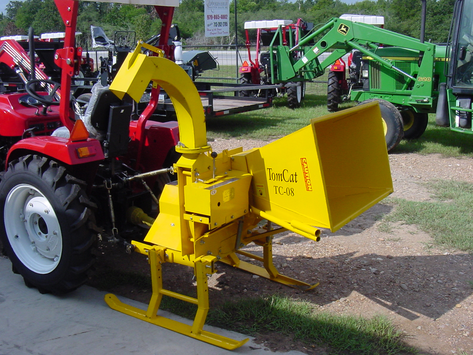

I have sold hundreds of the Jinma woodchippers over the years and they are a great value,last year I started having a chipper made that is similier to the Jinma but has some items that Jinma did not want to include such as, 360 degree discharge chute,adjustable leg height,upgraded heavy duty feed driveshaft (weak point on the Jinmas) 8" capacity.
They both have a 135 lb flywheel, 5-drive belts and 2-reversable 10" blades
All the parts for the Jinmas and the Tomcats are on the shelf and can ship the same day in most cases
The chinese chippers are going to be half the cost of other chippers on the market,and most will agree that they are worth it .Most chipper owners (reguardless of brand )use there chippers a few times a year then they sit for the rest of the year,you have to decide what you want to pay for this type of equipment
Here is a pic of our TomCat chipper

Tom, what's the HP requirement on that chipper?

I bought one of the Tomcat chippers from Affordable last fall. Despite some initial teething problems - partly due to user error- the chipper has worked well for me and seen a lot of use already. It's substantial in construction and I think will hold up in the long run.
Tommy @ Affordable was easy to deal with, stood behind his product and a man of his word. Things to take into account when you buy long distance. (I'm in Vermont and Affordable is in Texas)
I see the new model Tom Cat has redesigned what I feel was one of the poorer features of the chipper. That was the lever arrangement that disengaged the feed roller. A series of rods and arms that have a lot of play in them. Kind of flimsy. Looks like the new model has done away with all this in favor of a straight throw out lever right at the drive transmission. I think this will work better.
I run the chipper with my MF 1433 (33 hp).
We have put them on 25 hp tractors up to 80 hp tractors,if your tractor is over 50 hp you will need to purchase a longer PTO shaft,the one that comes with the chipper is short.If I know what tractor the customer is using I can tell if the PTO shaft will work or not,if you do need the longer shaft ( $ 150.00 max at local farm stores) I will give a $ 80.00 discount to not ship the short shaft with the chipper which will just about pay for the longer shaft
