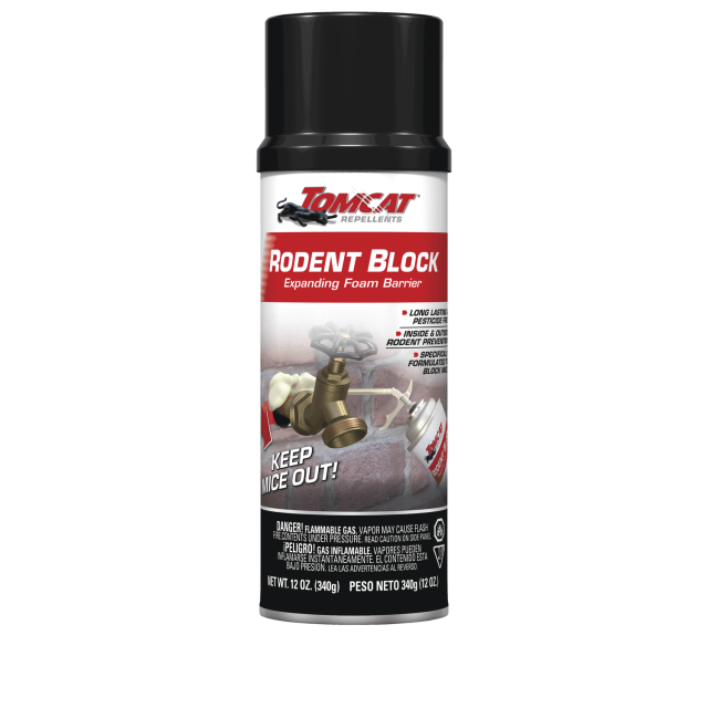

There's an expanding foam which is supposed to deter rodents, I don't know if it will work for birds.
