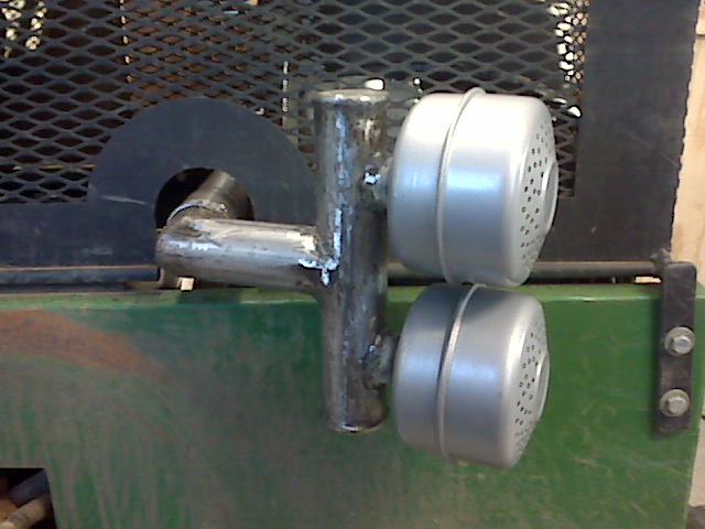

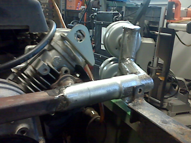

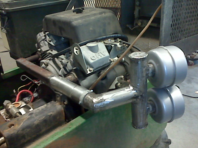

It's cold as heck down here in South Louisiana, some folks think **** is freezing over cause the Saints may finally go to the Super Bowl, so I am pulling my winter maintenance. I'm doing mostly routine stuff but one thing I am doing is overhauling the exhaust on my 422. I got really tired of the excess heat generated by the standard PT exhaust system and the noise so I'm trying a little custom stuff.
What I landed on is a piece of 1 5/8" exhaust pipe, two 1" nipples, and two generic 1" screw on mufflers, the big round ones. What I am doing is cutting the PT square tubing just past the second cylinder and will sedge up the 1" to the 1 5/8". That runs out the same notch that is cut in the cover. Once outside the cover I built a manifold with the two nipples welded into it and the mufflers will attach there. I figure I am at least doubling the exhaust path by doing this. I also picked up some exhaust wrap and plan to wrap the whole exhaust manifold out to the mufflers.
I should have pictures in a day or two and will post them. I'm hoping for a much cooler and quieter 422. Wish me luck!

OK, I did a bit more today. Here is what I have so far. With a bit more welding I'll be ready to try her out. So what do you think?

Looks good.
That's alot of weight out on the end of that, you thought about some type of support ?
   / Exhaust overhaul #4
It probably weighs quite a bit less then the OEM PT 1/4" steel box muffler he took off.

You need some volume, preferably something with some fiberglass inside to take the edge off. Take a drive to the exhaust shop and try a 3 way muffler, and if possible add an outlet pipe 2 feet long. If the muffler can be connected to the engine with flex hose, this allows the muffler to be hard mounted on the frame, perhaps with a vertical stack.
Alternatively, look at places like smallenginewarehouse.com for mufflers off the Honda and Robin engines. They have better mufflers out the box.

Well I finally finished this up over the weekend and tried it out. It is a bit quieter but not as much as I had hoped. The tone is much better and I must say the engine runs better. It is easier to start, seems to run cooler and has no backfires! I'd say it was worth it.

I had to build a muffler for a 6 wheel swamp buggy I had one time. We used pipe stuffed with metal shavings. I believe they were SUS. The over size & shavings dropped the pressure & the shavings cooled th gas flow a little. Worked pretty good. The engine was quieter than the drive chains. The shavings might last longer than fiberglass.
