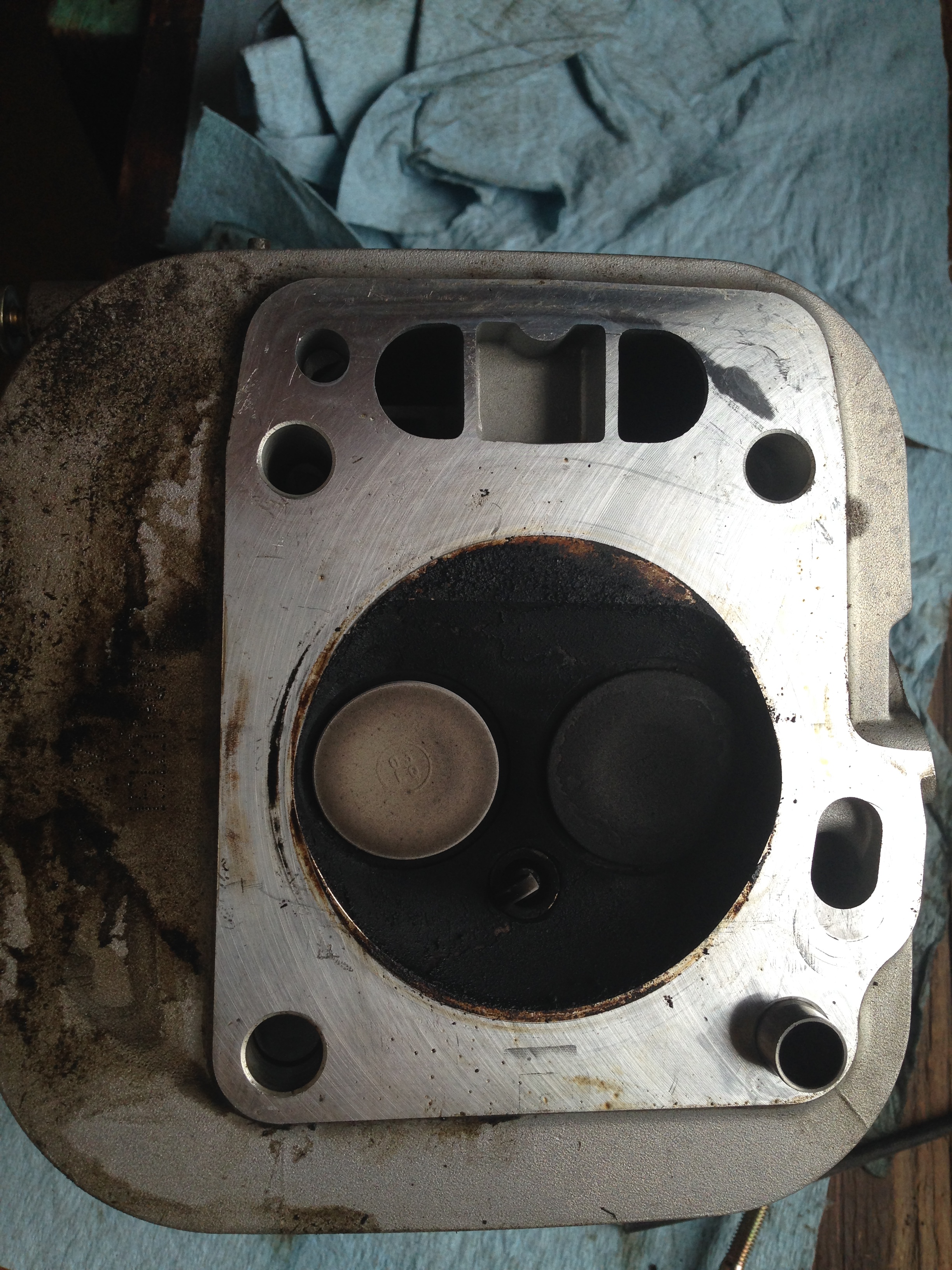

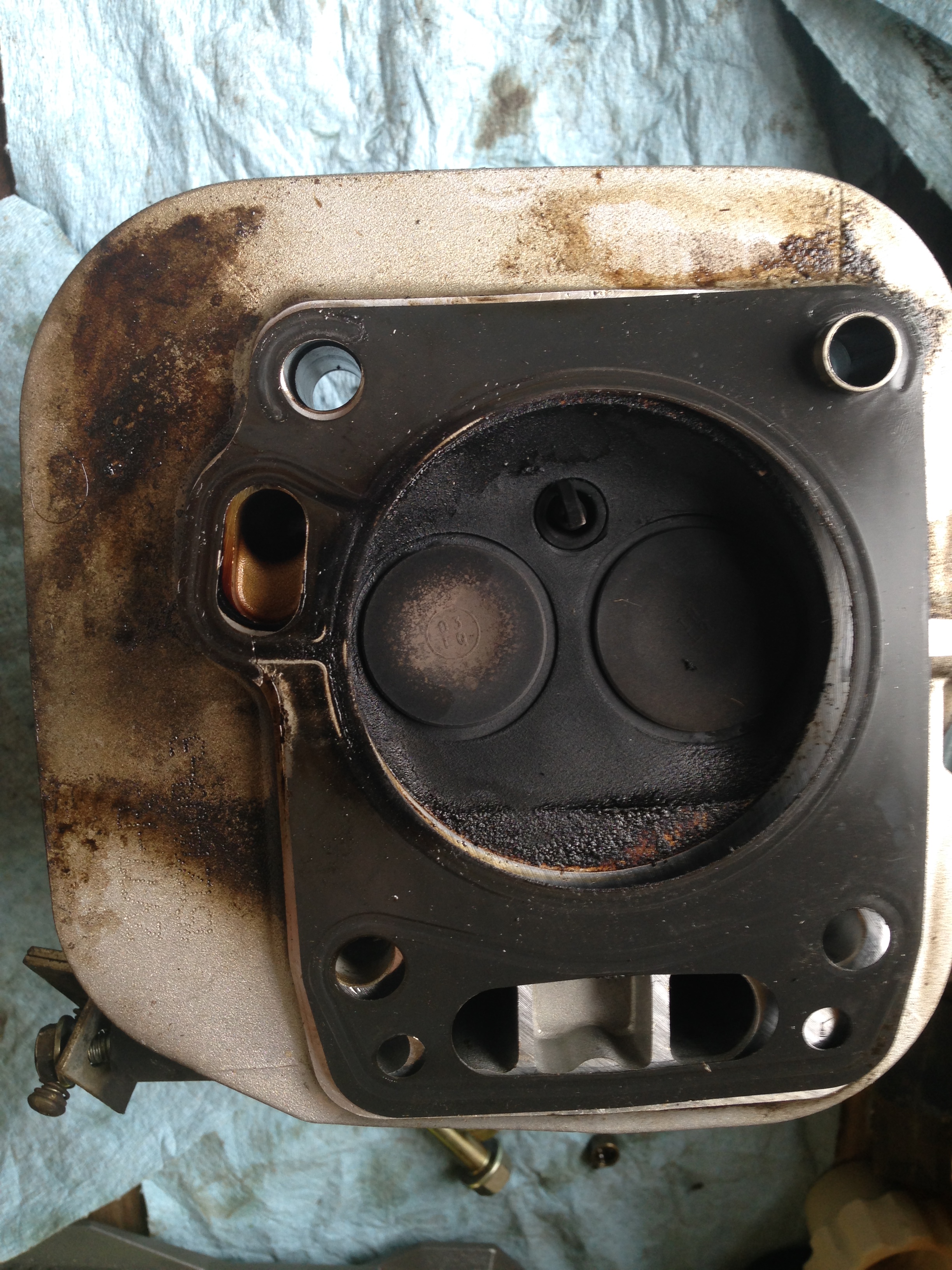

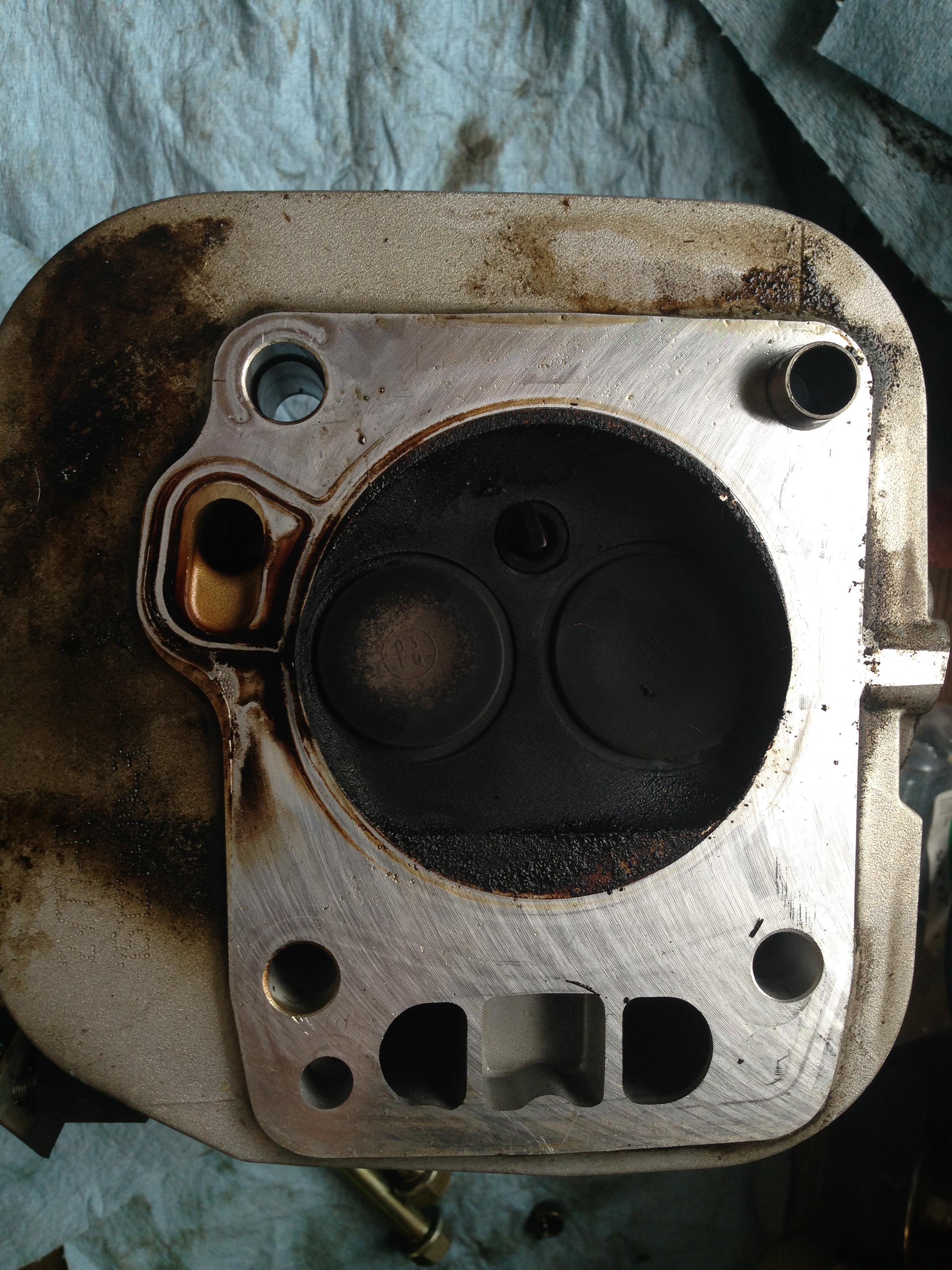

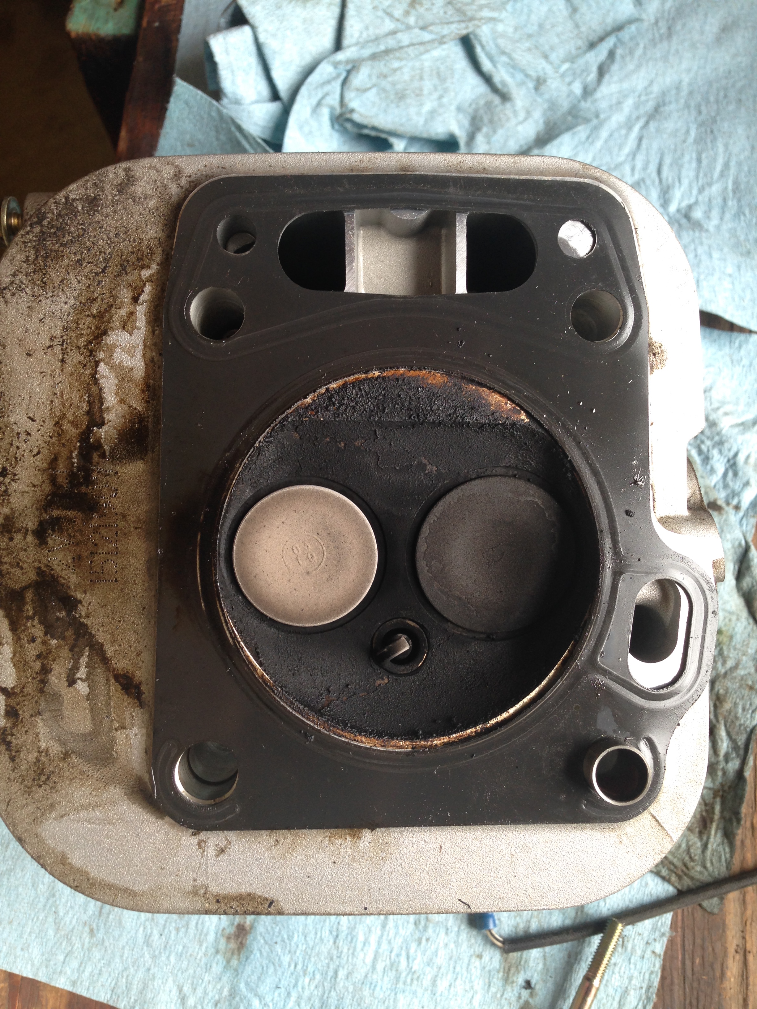

I then moved on to suspecting blown head gaskets and/or worn piston rings creating a large amount of blow-by, resulting in increased crankcase pressure. I don't have a cylinder leak-down tester, and since the mating surfaces between the heads and the block were indicating gasket leaks anyway, I simply tore it down to the block to see what I could find. In the course of the tear-down I found that in each case, two of the four bolts for both cylinder heads were only finger-tight. Both spark plugs were a little loose as well. The head gasket on cylinder #1 looked fine, but there was visible oil residue marking the block mating surface between the combustion chamber and the oil return passageway leading back to the crankcase. This happened to be on the side that both head bolts were loose.
2019-07-16 Deines 1800 KT Launtop 620 Engine Head & Combustion Chamber 018.JPG2019-07-16 Deines 1800 KT Launtop 620 Engine Head & Combustion Chamber 020.JPG2019-07-16 Deines 1800 KT Launtop 620 Engine Head & Combustion Chamber 019.JPG

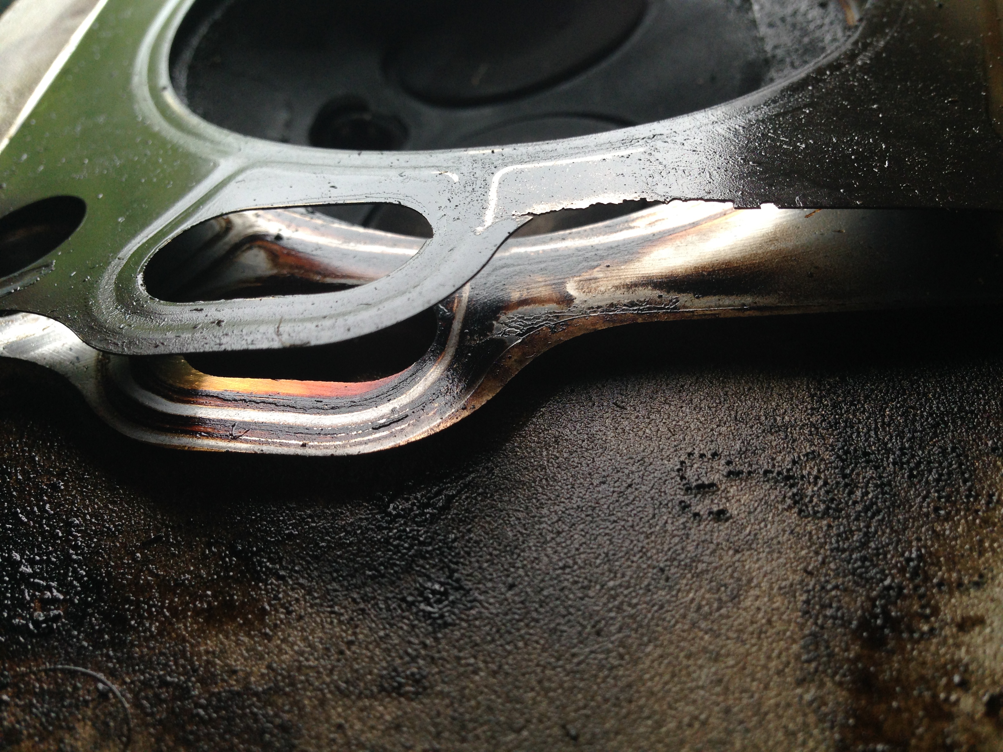

The head gasket on cylinder #2 was blown between the oil return passageway to the crankcase and the outside edge of the gasket, with blackened oil residue indicating there was oil leaking into the combustion chamber as well. Again, this was the side on which both head bolts were loose. I was happy to find the blown gasket on cylinder #2, as I was hoping that combustion leaking into the oil return passageway was the cause of my blow-by and not simply a symptom of it. I cleaned up both surfaces of the combustion chambers, installed new head gaskets, and torqued to spec.
2019-07-16 Deines 1800 KT Launtop 620 Engine Head & Combustion Chamber 022.JPG2019-07-16 Deines 1800 KT Launtop 620 Engine Head & Combustion Chamber 007.JPG2019-07-16 Deines 1800 KT Launtop 620 Engine Head & Combustion Chamber 024.JPG2019-07-16 Deines 1800 KT Launtop 620 Engine Head & Combustion Chamber 025.JPG
