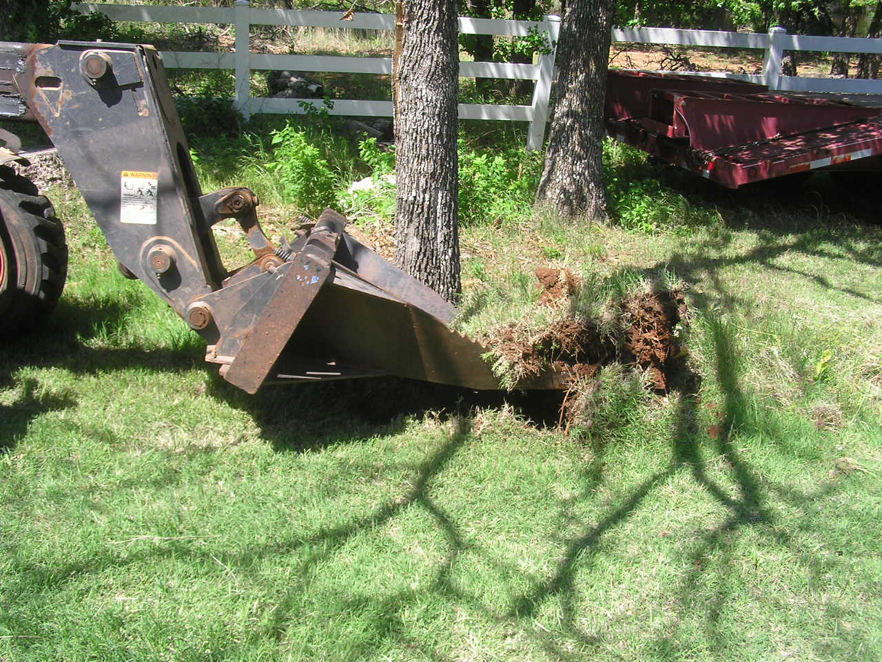

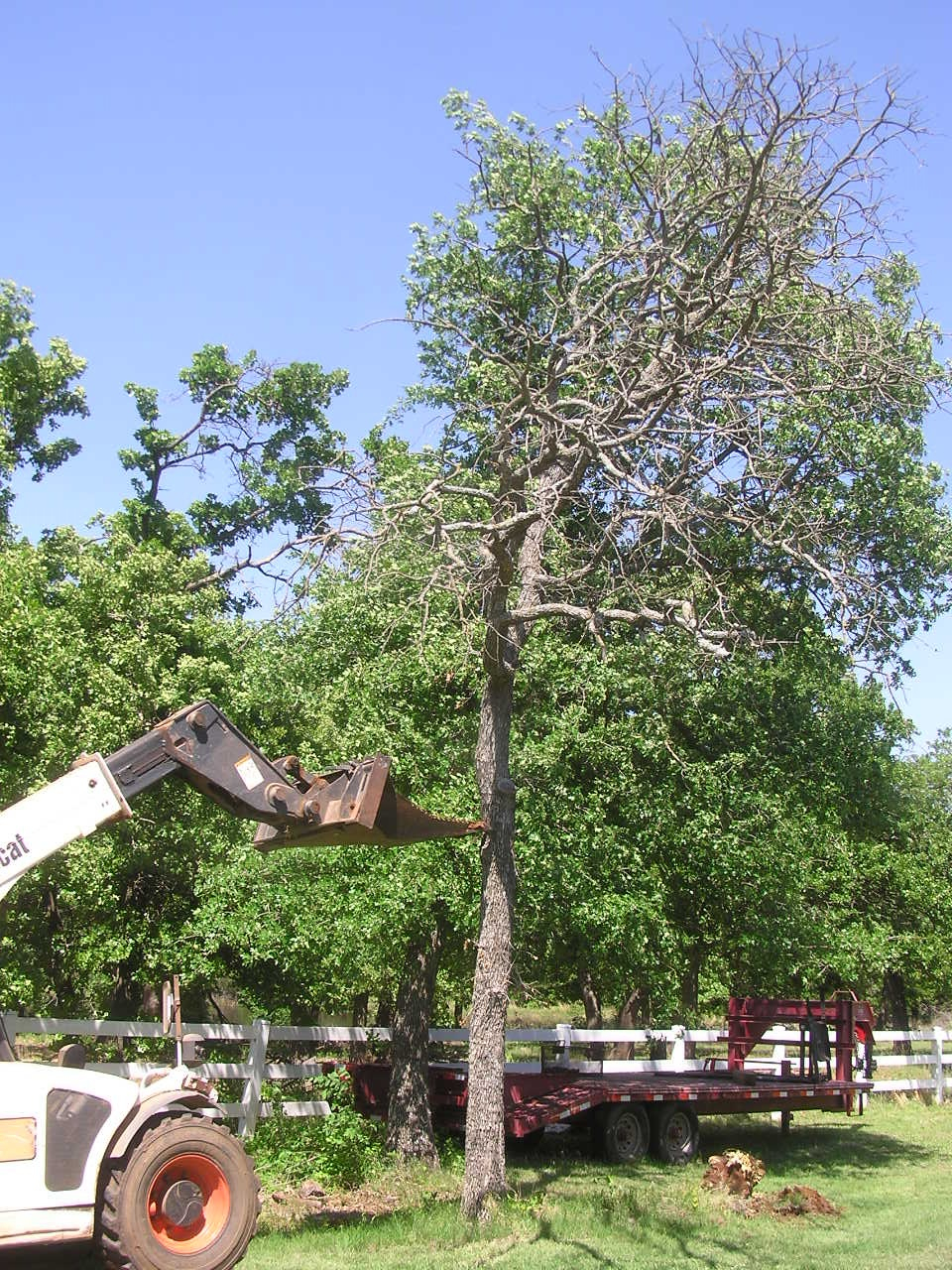

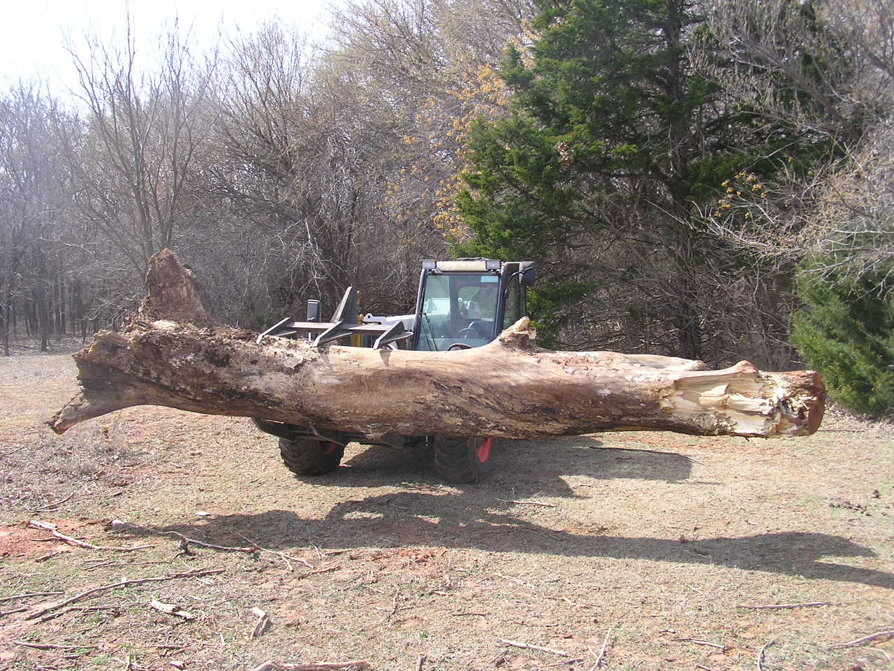

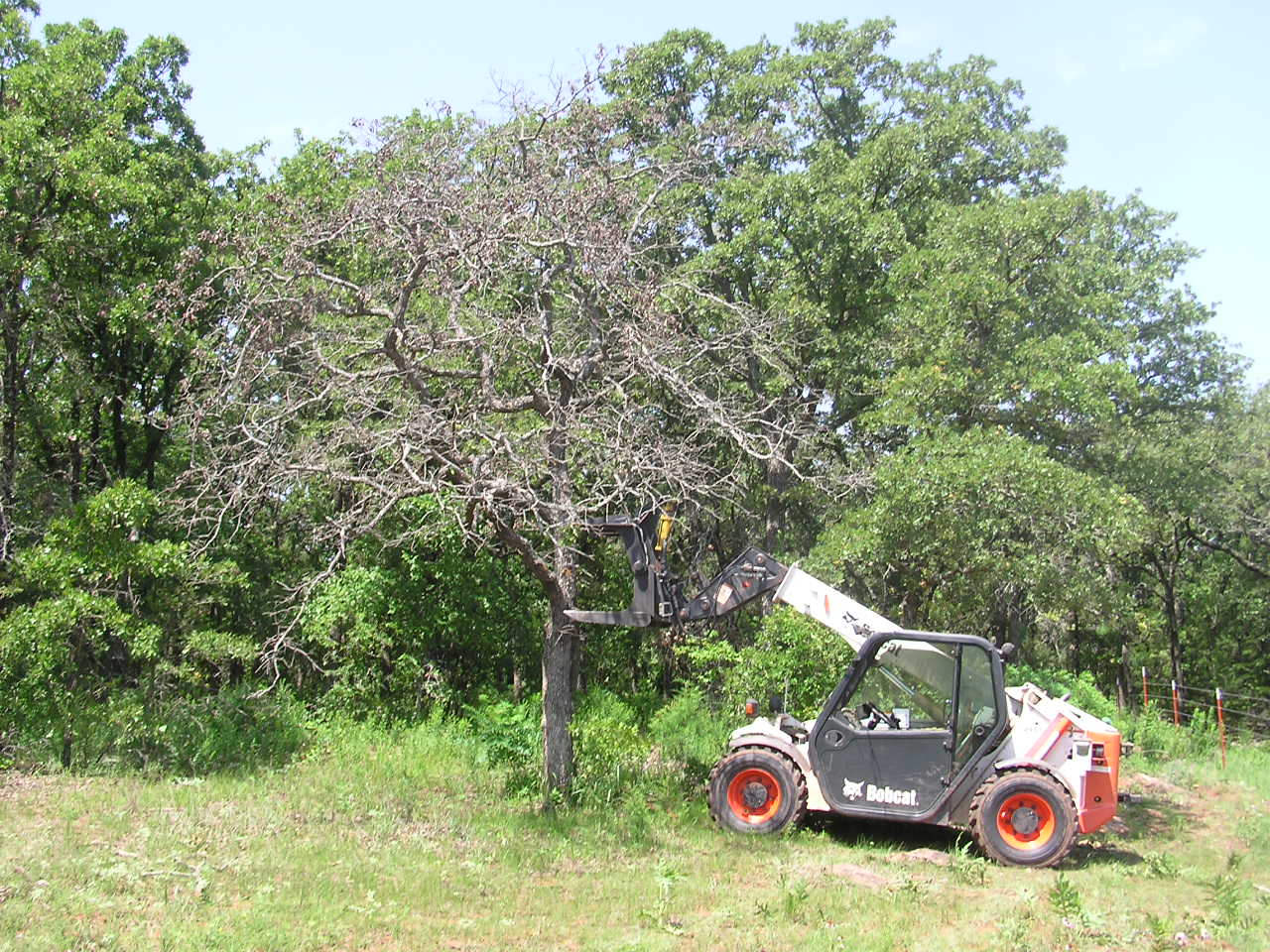

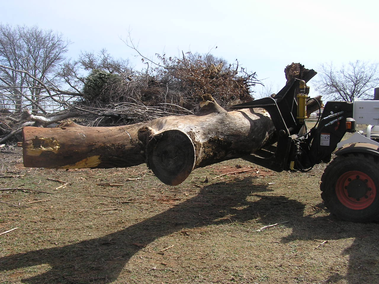

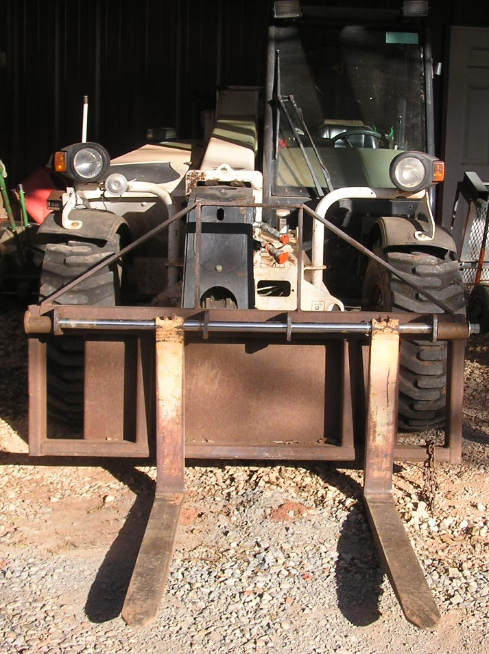

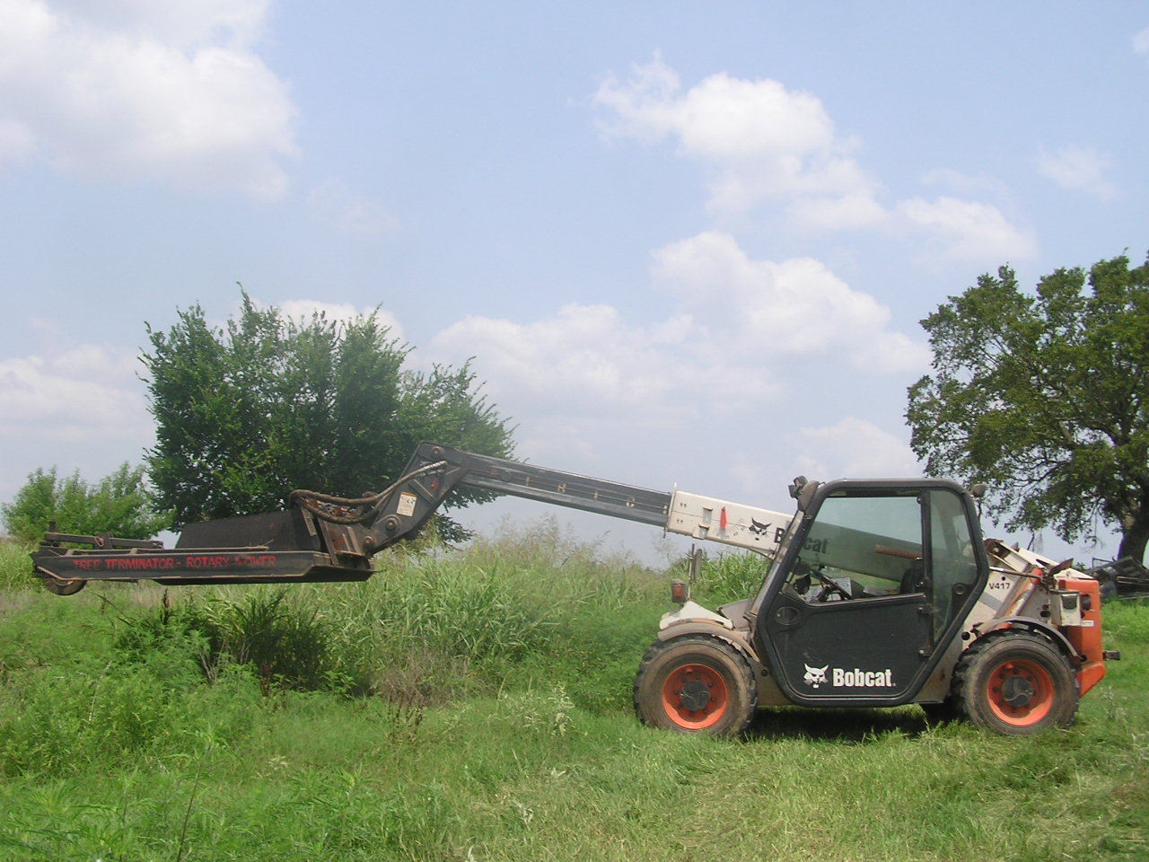

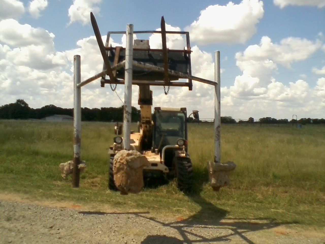

Have you seen what a compact telehandler can do? Click this link:Compact telehandler
Get one and sell the tractor like I did. (y)

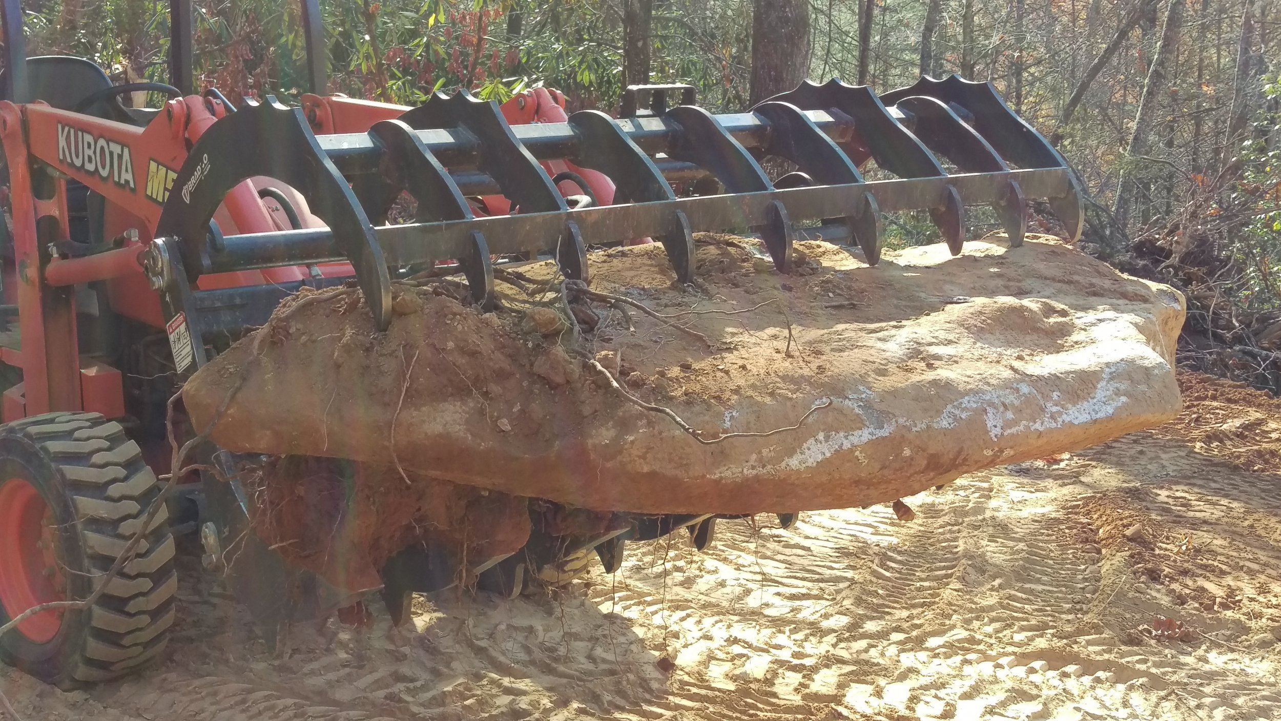

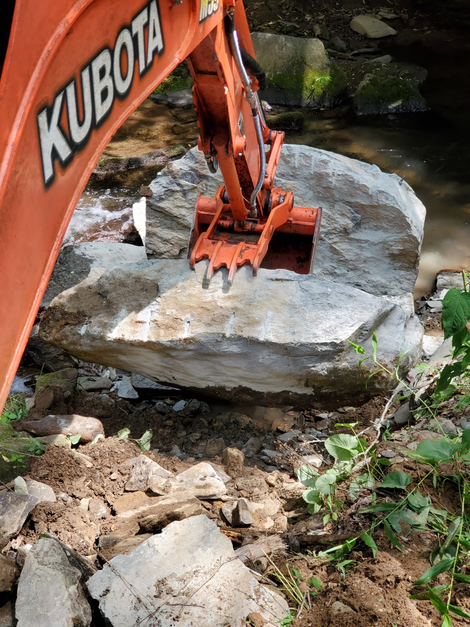

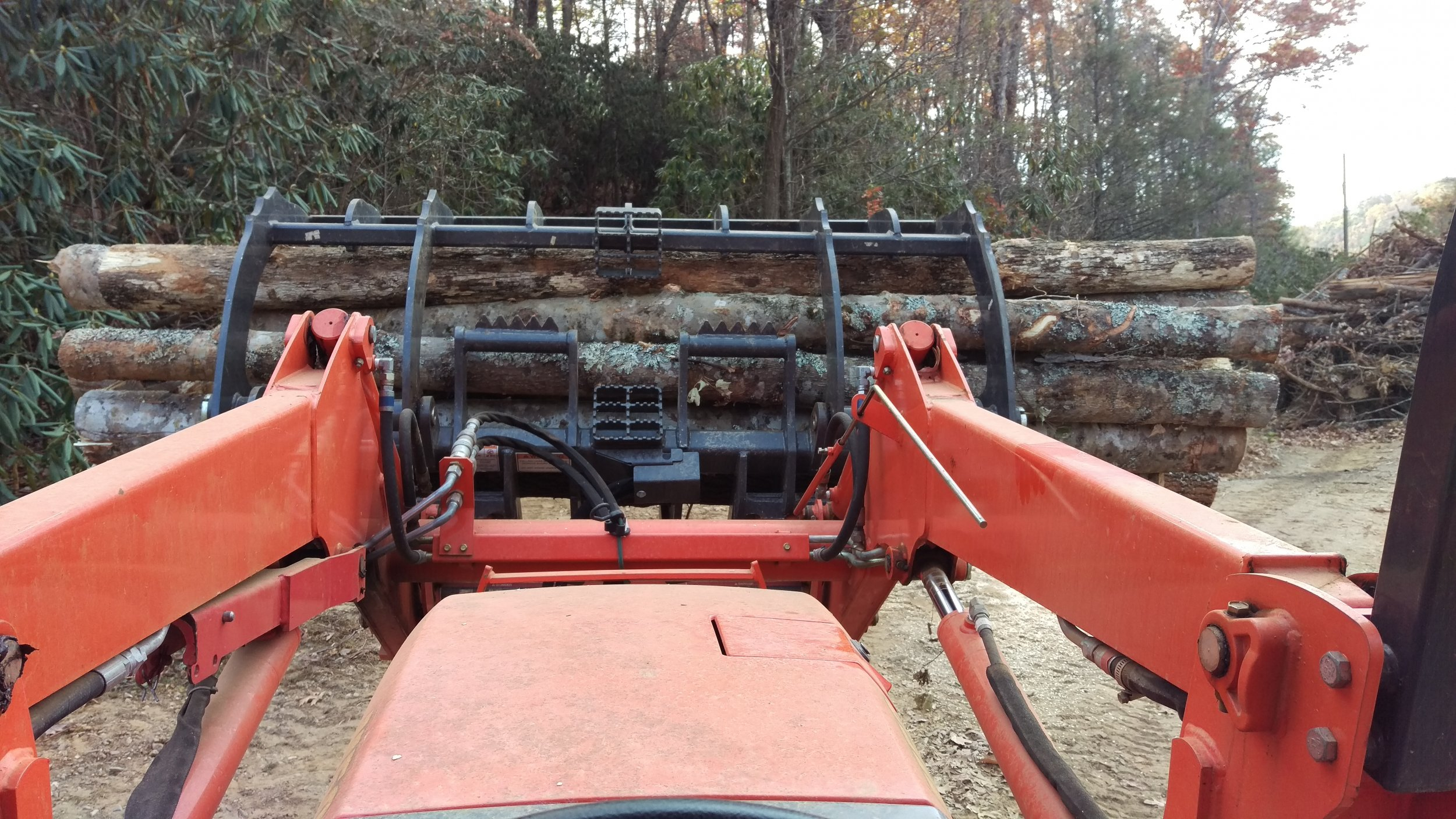

No machine whether it is a tractor with loader or tractor loader backhoe ( TLB ) or backhoe or skidsteer, or trackloader, or excavator or telehandler is going to do everything you want and do it well. Excavator's ( mini and larger ) and larger TLB/ backhoes have good digging and lifting power and reach ( being able to work at distance ). Skidsteers and trackloaders are good for lifting and carrying things and are agile but both require adding a hoe to their SSQA to dig and the reach is much shorter.
My personal preference for all around capability to do work was a Kubota M59 as it had sufficient weight for stability while working and sufficient horsepower to run a wide range of tools of the front and back of the machine. I have SSQA forks for moving pallets and a SSQA McMillen auger for planting posts and trees, a SSQA grapple for moving pretty much anything, a Power rake for cleaning rocks and debris from ground while leveling it in preparation for planting grass, a backhoe with thumb for pulling out trees up to 6" in dia and digging root ball of the rest. Thumb also move rocks and build walls and steps. Also pull a box blade for leveling pretty much any dirt pile or driveway. Near term addition is a trenching tool for laying pipe and power line into a trench.
In a nutshell, I looked for a machine that gave me the greatest range of capability because it could use the greatest range of tools for maintaining and upgrading property in hilly NC.

That telehandler is really something. Makes me wonder if they have dented the market appeal of skid steers.
If they’re prices were closer I bet they would. Last time I looked there was a pretty big difference.
