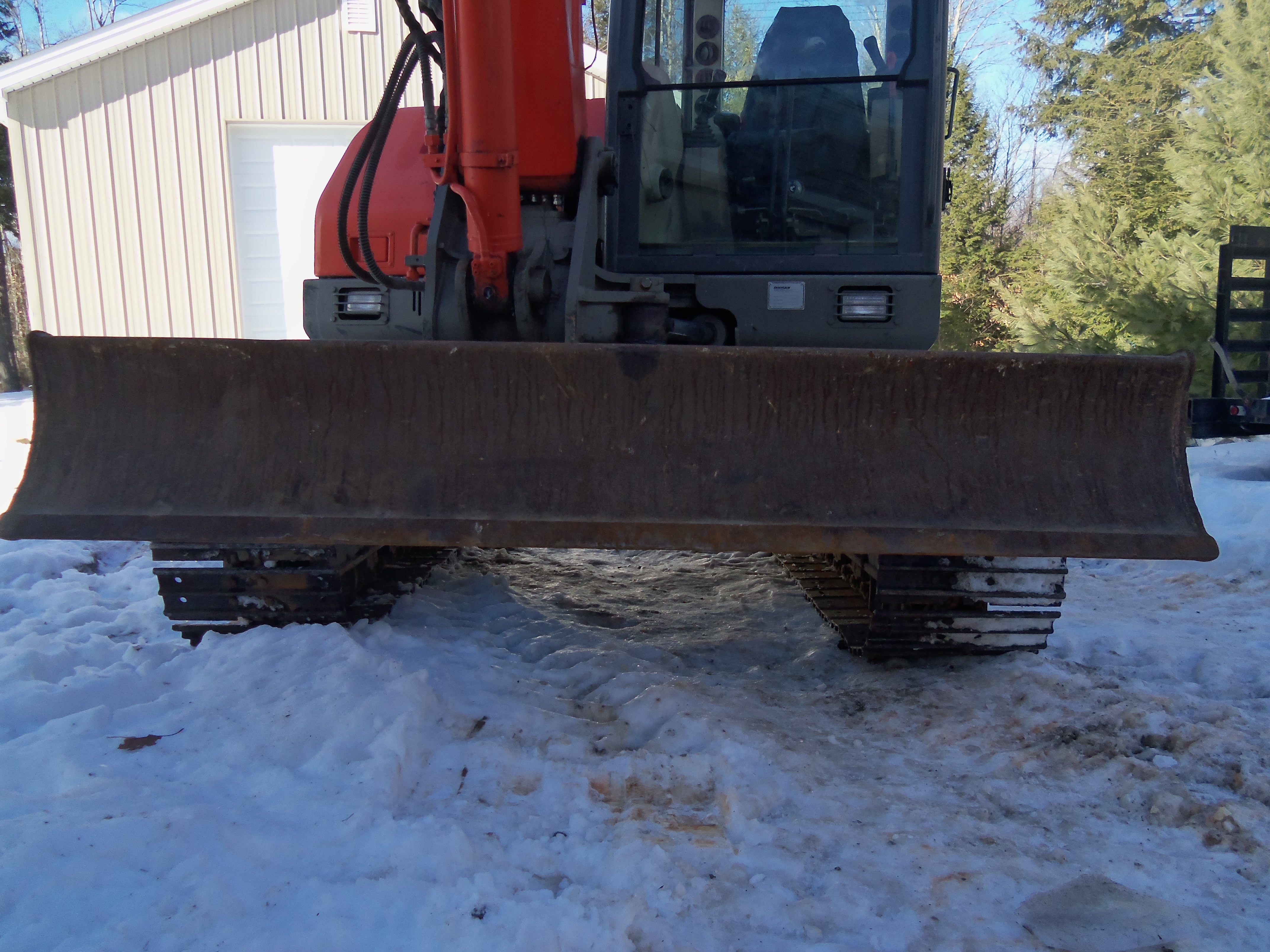

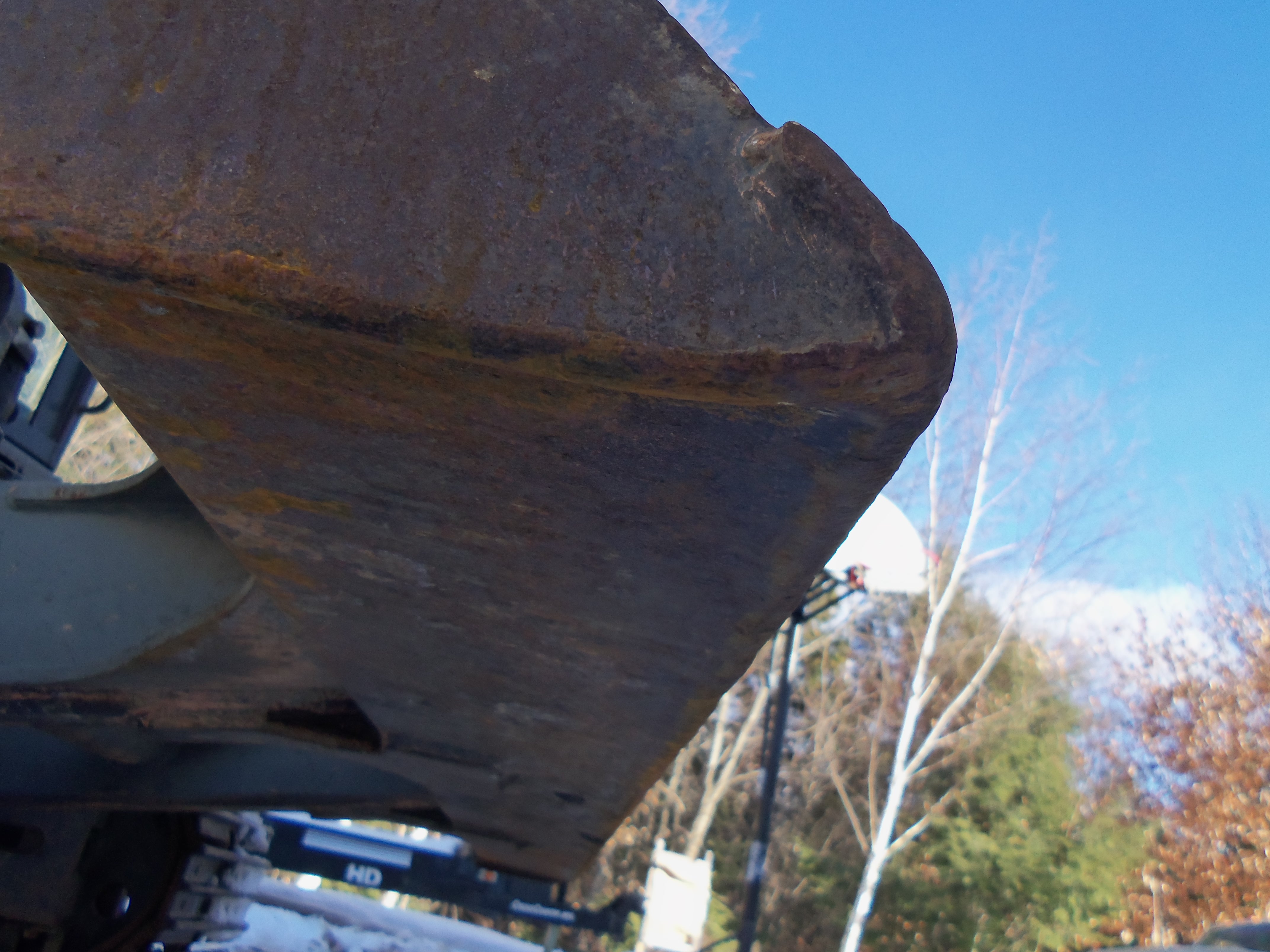

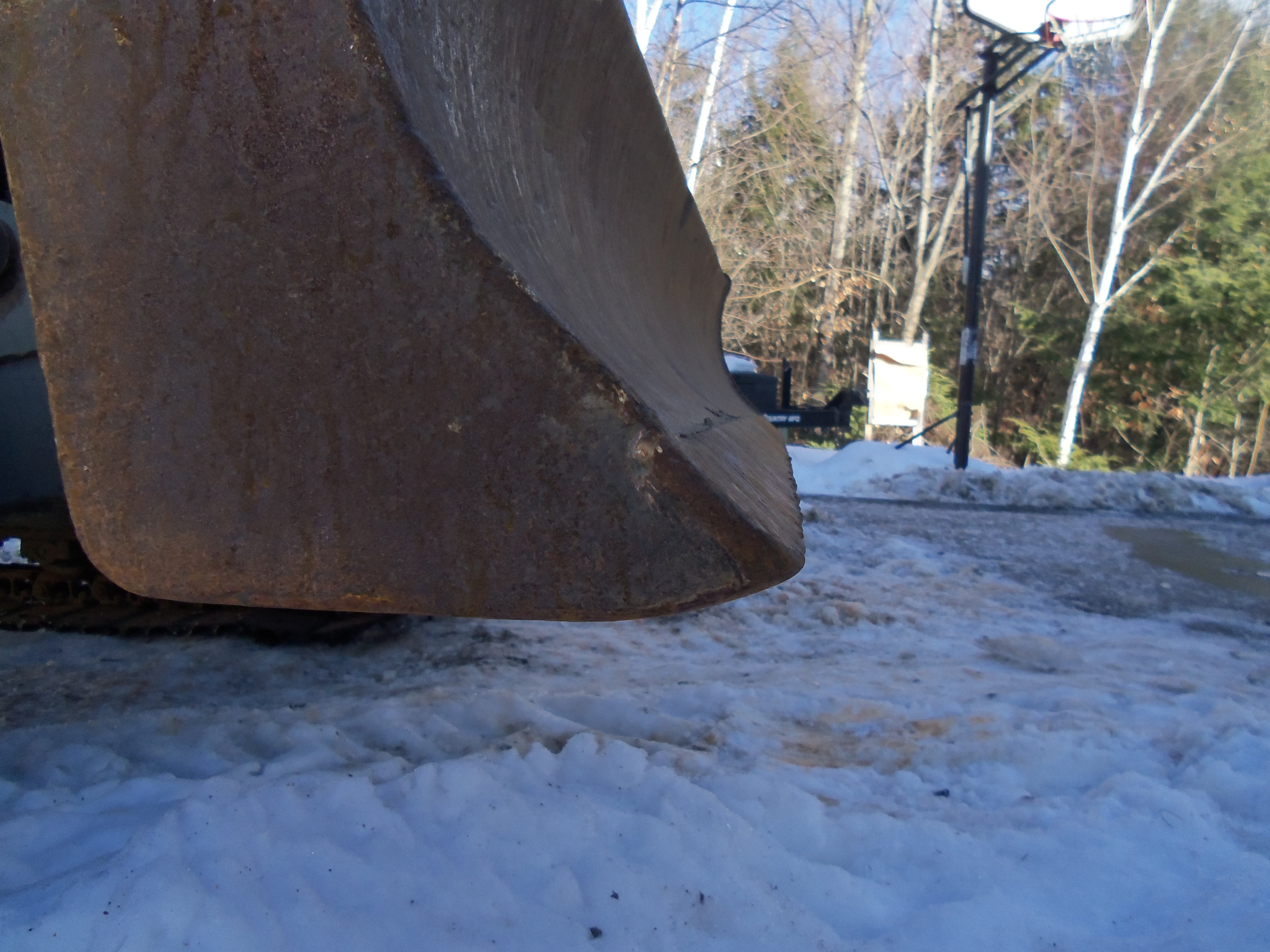

Dec 20, 2017 / Excavator blade wear #1 L liberty2701 Platinum Member Joined Sep 8, 2011 Messages 602 Location Lakes region,NH Tractor Kioti Dk50se hst Here are some pictures of my excavator blade. I know bulldozers have replaceable blades. Does this blade look normal to you? Attachments 103_3311.JPG 2.6 MB · Views: 383 103_3312.JPG 2.4 MB · Views: 371 103_3313.JPG 2.1 MB · Views: 374

Dec 20, 2017 / Excavator blade wear #2 Peter 315 Super Member Joined Mar 28, 2016 Messages 5,019 Location NH Tractor Kubota L3800 HST Kubota L47 TLB Its ok when it peels open on the bottom its time to weld a new edge on

Dec 20, 2017 / Excavator blade wear #4 T Tomtint Elite Member Joined Apr 12, 2011 Messages 3,091 Location Boston Tractor L3700SU I had a 1/2" thick blade welded onto mine.
Dec 20, 2017 / Excavator blade wear Thread Starter #5 OP L liberty2701 Platinum Member Joined Sep 8, 2011 Messages 602 Location Lakes region,NH Tractor Kioti Dk50se hst I am just wondering how much lower the blade was when it was new.
Dec 20, 2017 / Excavator blade wear #6 Peter 315 Super Member Joined Mar 28, 2016 Messages 5,019 Location NH Tractor Kubota L3800 HST Kubota L47 TLB My boss just put a new edge on one, I think its was 3'' wide
Dec 20, 2017 / Excavator blade wear Thread Starter #7 OP L liberty2701 Platinum Member Joined Sep 8, 2011 Messages 602 Location Lakes region,NH Tractor Kioti Dk50se hst I do have a 7ft piece of plow blade that is 1/2" thick. I could probably weld that on.
Dec 20, 2017 / Excavator blade wear #8 Thomas Epic Contributor Joined Apr 6, 2000 Messages 31,188 Location Lebanon,NH. Tractor Kubota B2650HSD w/Frontloader & CC LTX1046 & Craftman T2200 lawn mower. Normal wear tear to me,like others said new edge be almost brand new.
Dec 20, 2017 / Excavator blade wear #9 Peter 315 Super Member Joined Mar 28, 2016 Messages 5,019 Location NH Tractor Kubota L3800 HST Kubota L47 TLB I would leave it alone pushing dirt it will last a long time ,your not on pavement that wears them out faster
