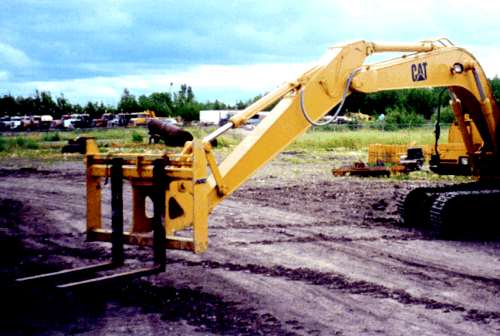

I know hydraulic excavators are used as cranes often, but has anyone replaced the bucket on an excavator and used it as a high lift fork lift?

Probably have to build it... I've never seen one. It would work ok I guess... Would need a lot of room to manuver and would be hard (guessing) to keep the forks levelish.

I have never seen or heard of such a thing. It would take a lot of practice to keep the forks level as you raised the load, which is why I assume nobody has built one. But you could be the first

I made a forkset to go on the end of a 300 Komatsu excavator, very hand with a quick coupler. We used the one i mad in and alley where our telehandler o nthe job couldnt turn around the corner to get into the alley. its not that hard to keep it level well front to bacl level. Wed hook the bucket on the excavator and fix a small area to getinto the alley and level the pad up then drop the bucket and get the forks. It was good to load pipe as well. Its just the fact of the 360 degree and the 40 foot lift of the machin and terrainability of the machine that make it handy. Try Imac.com they make such an attachment for and excavator.

I have a picture of the IMac that i used to make the one for the hoe where i used to work. THere handy ever drive a telehandler on a 2 to 1 slope lol thats one thing about the excavtor it can got alot of places becacause of the 360 degree swing and tracks. Im making some now for a mini excavator to be used on a retaining wall im builing at the lake a skidsteer with forks wont reach far enough out on the trails well have to cut to make the wall on. its not too hard to keep the forks level after running a hoe for a few years. im attaching the Imac links
