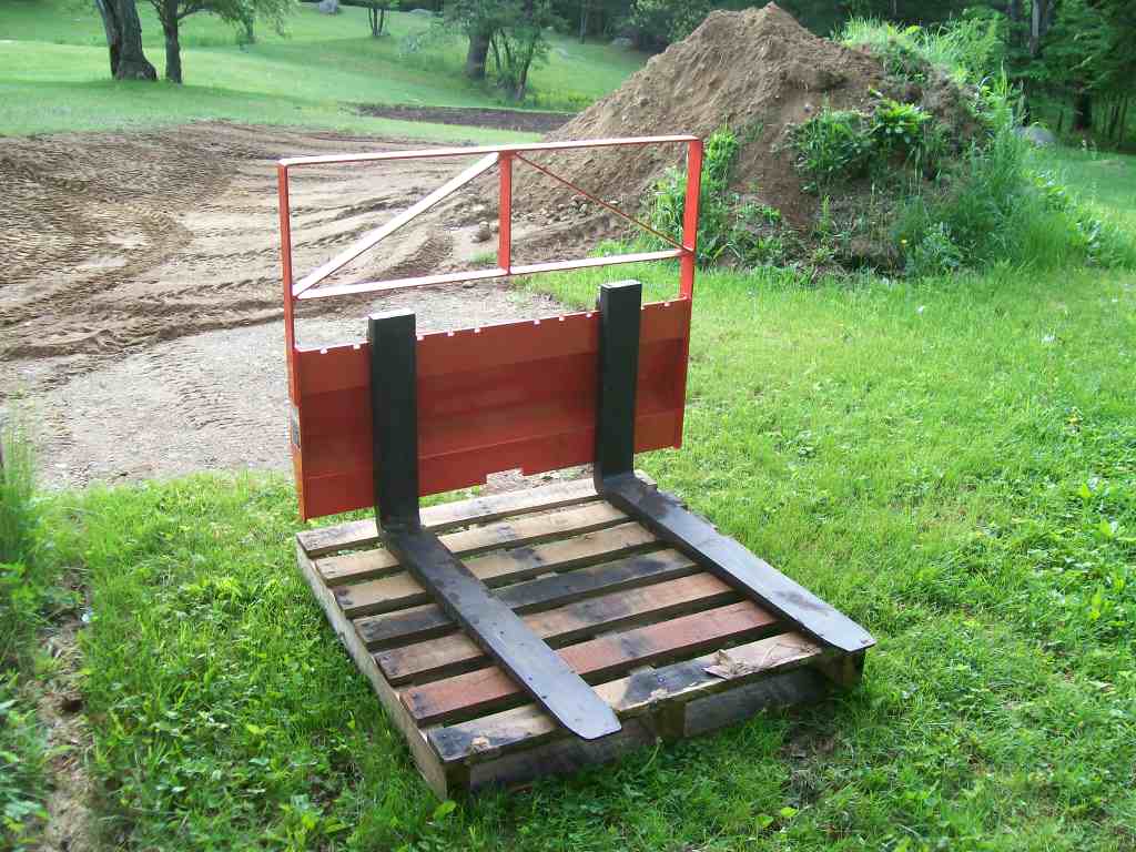

Remember when thinking about establishing grade with an FEL that the bucket is always level with the back tires. Often, the only way to establish a new grade is to create it by digging at 90 degrees to the planned grade until you establish a place for the tractor to sit. The next problem is maintaining that grade. On the other hand, a box blade can be tilted to an angle that is different than the grade the tractor is on, and the angle of attack can be adjusted to dig more in the high spots than in the low spots by tipping the box ahead until the front of the side edges contat the soil before the blade does. In just playing with a small swale, I found it much easier to establish, and maintian a grade with the BB than with the loader, and I am a newbie with it. The box will pull an even layer along until you get a load, or reach the end of your grade, and then you can easily scoop it up with the bucket. This little swale is only about 50' long, and you can get an idea how much soil you will move. (Actually some of it has already been used in other places on my land)
