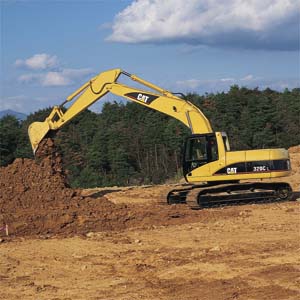

Daveiaff, welcome to TBN. You can definitely do the driveway and trenches and probably the whole foundation if you have enough time. I wonder if the wear on your 2710 would be worth it vs. bringing in a bigger machine for the foundation.

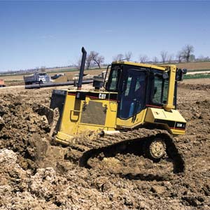

Dave, being in SW PA myself I attempted the same thoughts as you when I built my log home back in the 80's. The only difference was at the time I had a Bobcat skidloader. Making a long story short, and speaking from my own experience if I were doing it today...I'd start out doing what I ended up doing...hogging out the foundation with a JD 555 crawler loader and doing all the slag movement. french drains and the million other projects with the smaller machine. An added benefit is the crawlers tracks can pack your driveway base slag in nice and tight, then you just spread the topcoat limestone or 2b with your tractor. Building the house is enough of a major undertaking, and you'll spend enough of the "till the wee hours" pounding nails and such. Don't try to do it all and burn yourself out too early in the game.

For the road project might I make a suggestion...

And for the foundation might I suggest this...
In all seriousness, I think that you will have plenty of smaller projects to keep you and your tractor busy, but digging things like foundations, clearing and or rough grading for roads, and digging lakes (how many threads have we all seen on this one) are best left up to larger construction equipment. Yes it can be done with a small compact tractor, and it is also possible to drive railroad spikes using a finish hammer, but sometimes there is no substitute for the "Right tool for the job"
