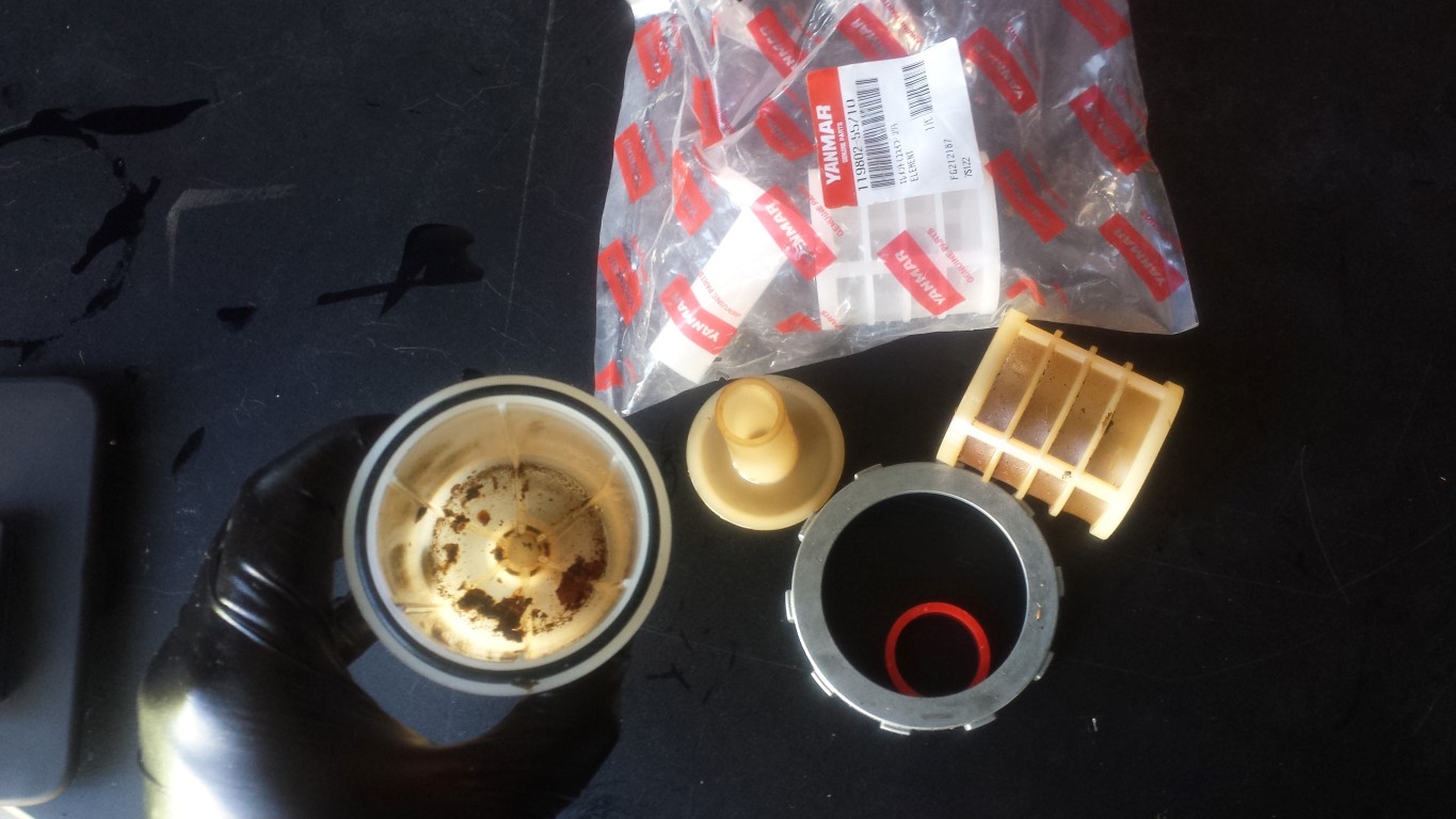

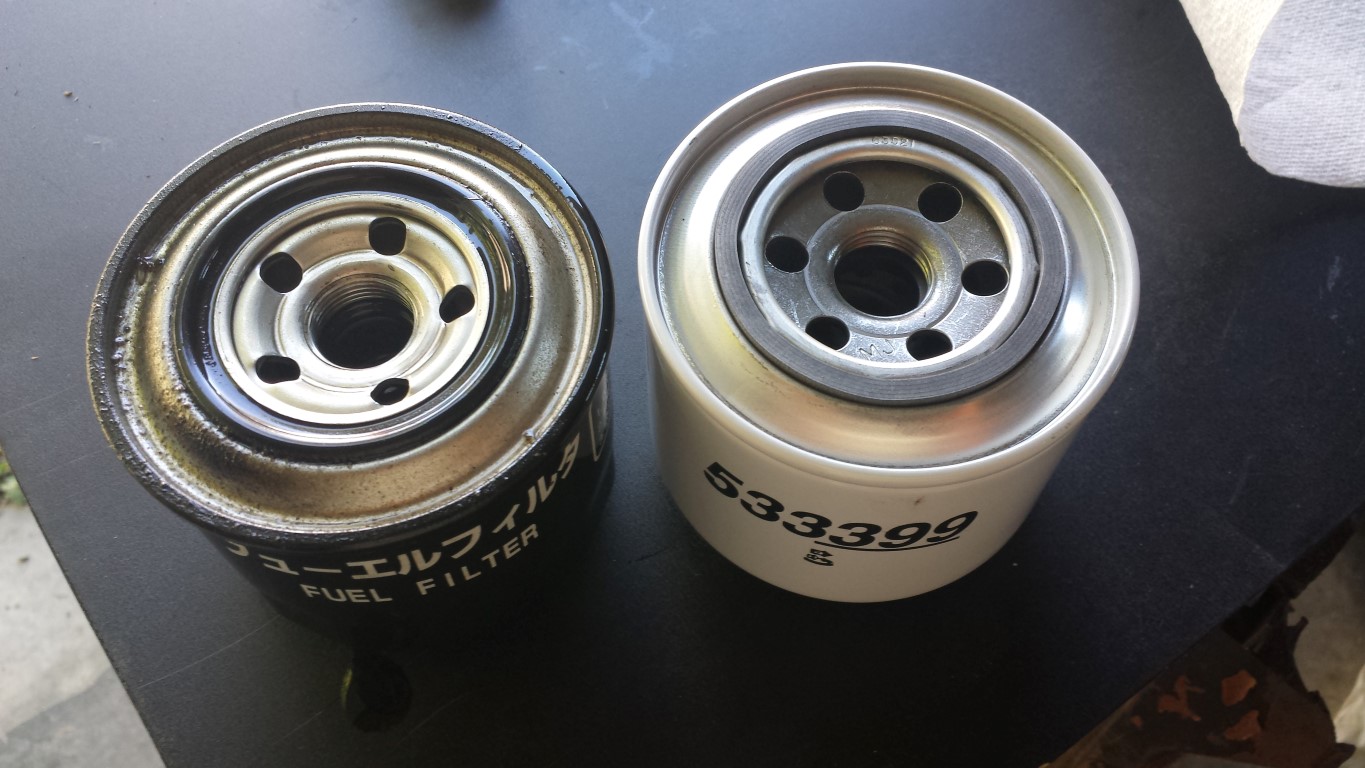

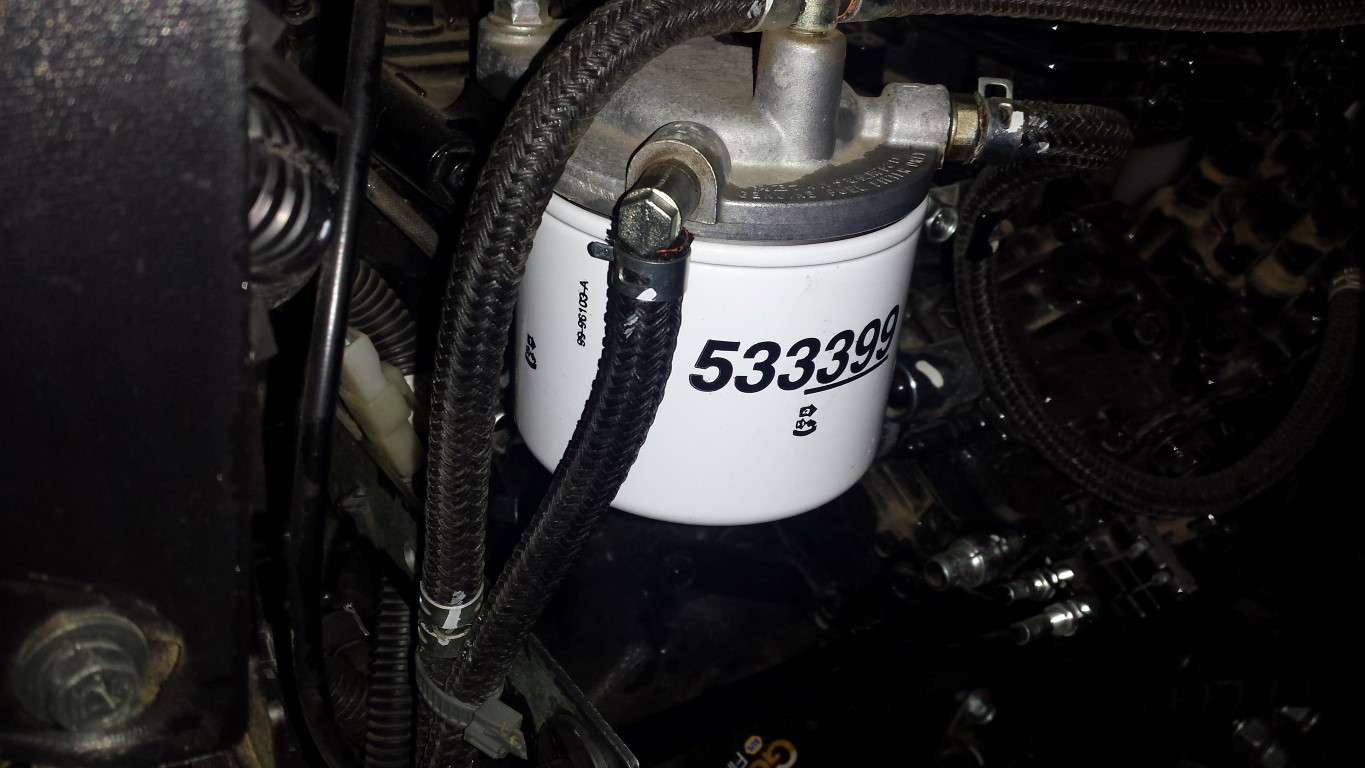

All this talk of clogged fuel filters and preventative maintenance inspired me to change my filters as well. Here's some pics of the parts we're talking about....the only mishap in my process was I dropped the fuel separator o-ring somewhere and had to run to the local hardware store to replace it. I had the filters on-hand already. Better to change them now then in January when the water and algae trapped in the filters ices up! :thumbsup:
20140914_153725 (Medium).jpg20140914_142019 (Medium).jpg20140914_155306 (Medium).jpg
PS. As I understand it, that red ring in the water separator is supposed to float as in indicator water is in the filter. The ring does not float in fuel.
Also fyi, WIX Filter 533399 (shown) is the same as NAPA filter 3399.

Got the filter changed, and seemed to solve the problem. Worked it pretty good yesterday, and it ran fine. Boy was that spin on dirty on top - much worse than your pix. Pretty rusty in there too. 356 hours, guess it was time. There's another in-line metal filter mounted just below the spin on. Did you change it too?
