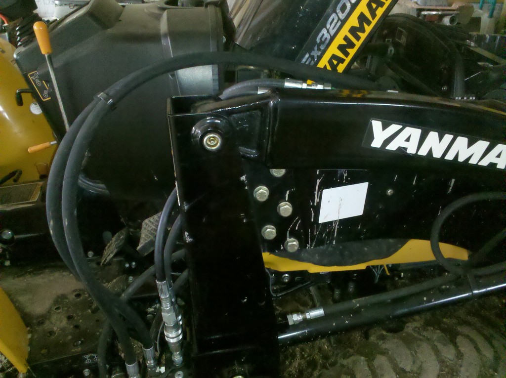

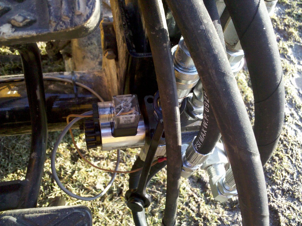

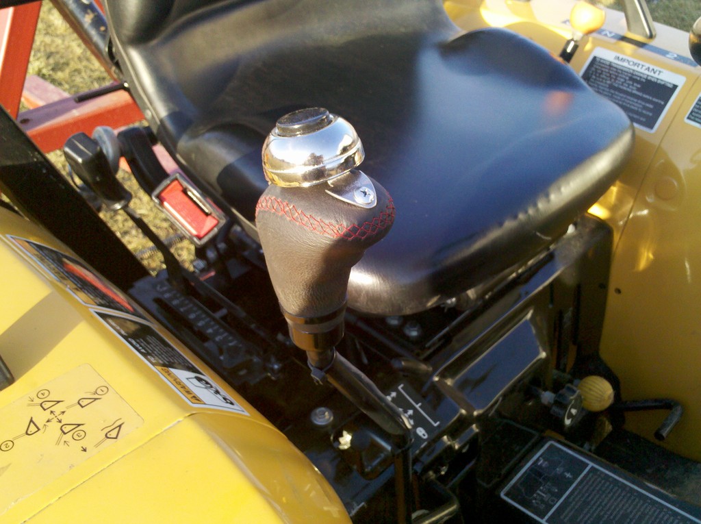

I decided to add 3rd function to my EX3200. After doing a little research I decided to go with a diverter valve. I purchased the valve and most of the fittings from Baileys. The rest of the fittings and hoses came from my local Family Farm & Home. In all I have about $350 into it. I expect to by a grapple for it in the near future. Don't laugh at the button on the control lever. Something had to be redneck engineering.:laughing:
The wiring for it goes from the battery positive, with an inline five amp mini fuse, through the button to the valve. Ground wire for the solenoid also runs to the negative side of the battery with the chassis grounded to one of the mounting bolts.

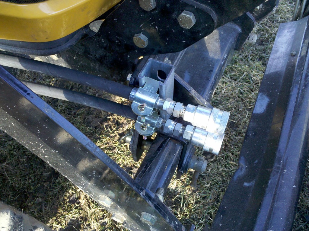

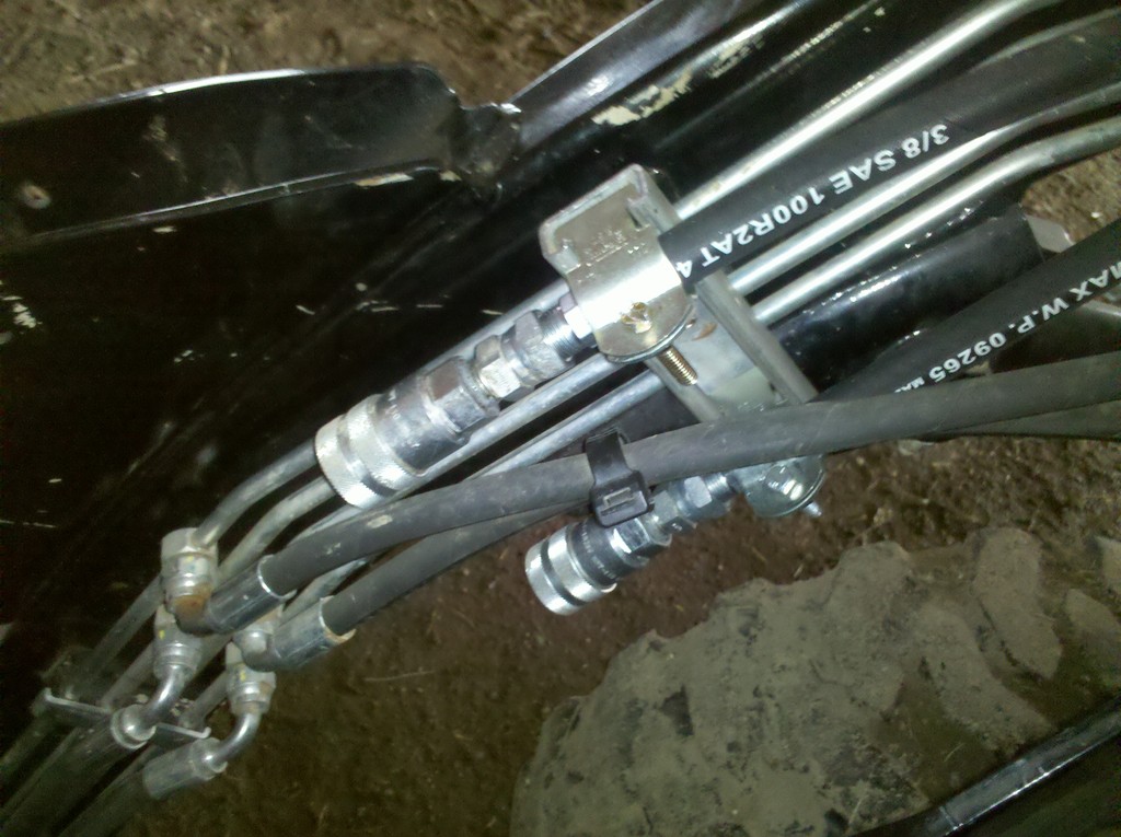

The only thing I may have to do is move the connects so they are mounted on the loader arm. I was thinking I wanted then to stay on the tractor so if I removed the loader they could still have some use. That's going to require some extra long hoses though for a grapple.
   / EX3200 Third Function Control
Update. Moved the hoses and disconnects to the bucket arm.
