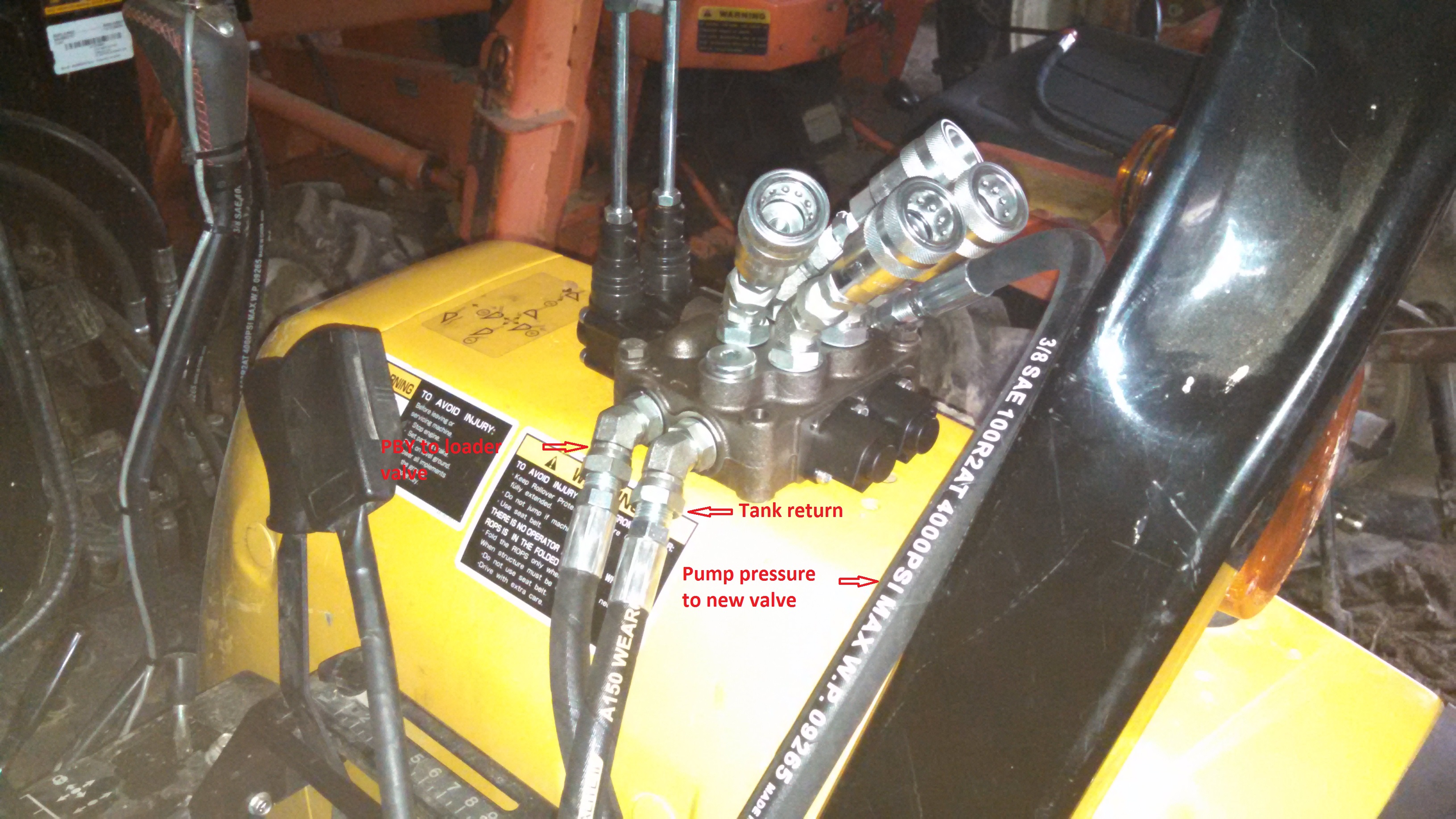

After doing a lot of research and not being able to locate a PBY kit, everyone seemed to have it listed as no longer available, I just bought the parts and did it myself. I was able to do it with out pulling the seat, with the help of a sacrificial 7/8" wrench to make a stubby out of, I started out by mounting the two spool, open center with power beyond valve to the fender using a couple of 5/16" stainless bolts 2 1/2" long.
The pressure from the pump is shown in the photo above. All hoses where 3/8" with 3/8" male pipe thread ends. The quick disconnects are 3/8" ordered from Bailey's Hydraulics.

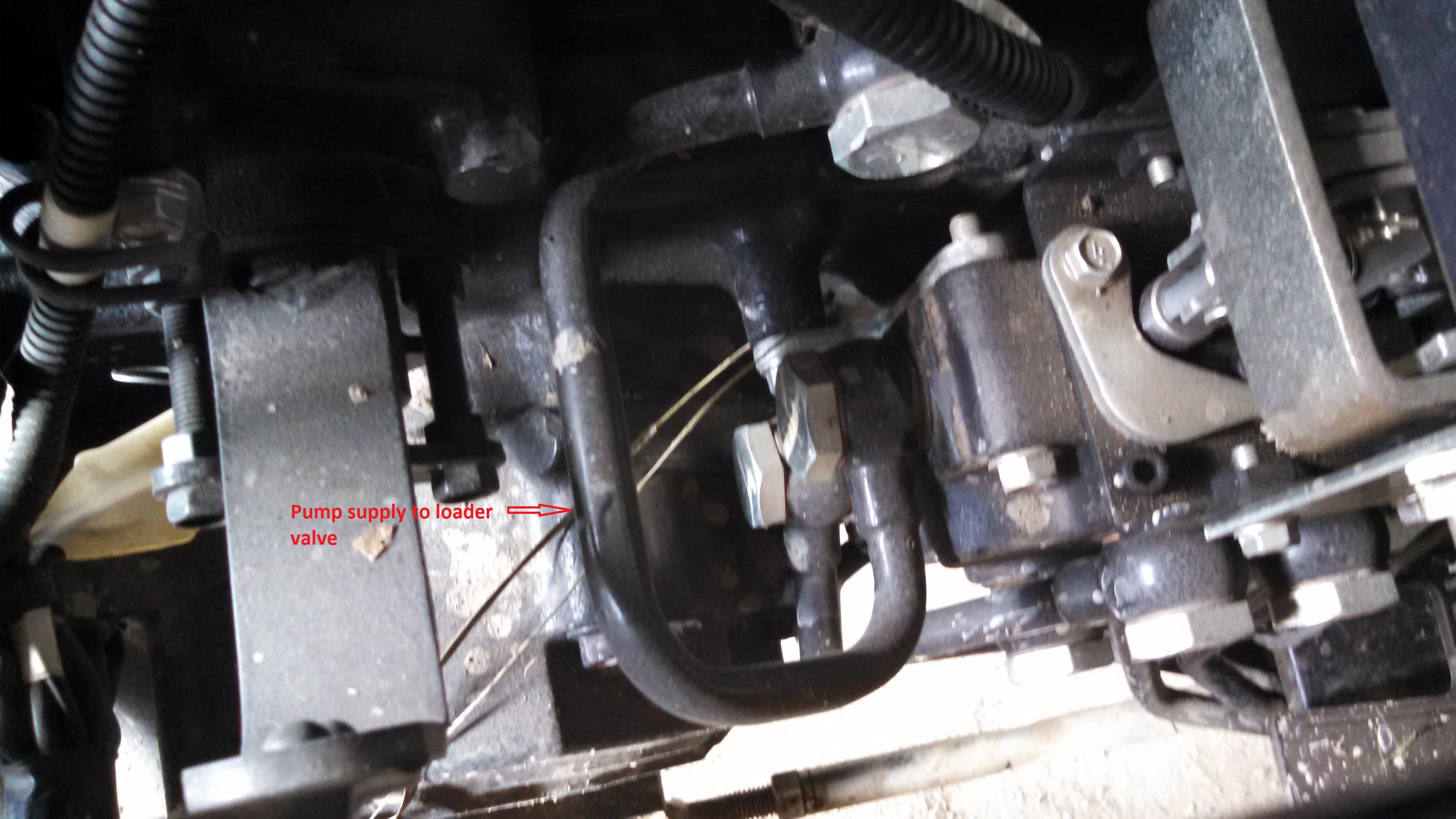

I removed the metal line that used to run from the pump supply to the loader valve.

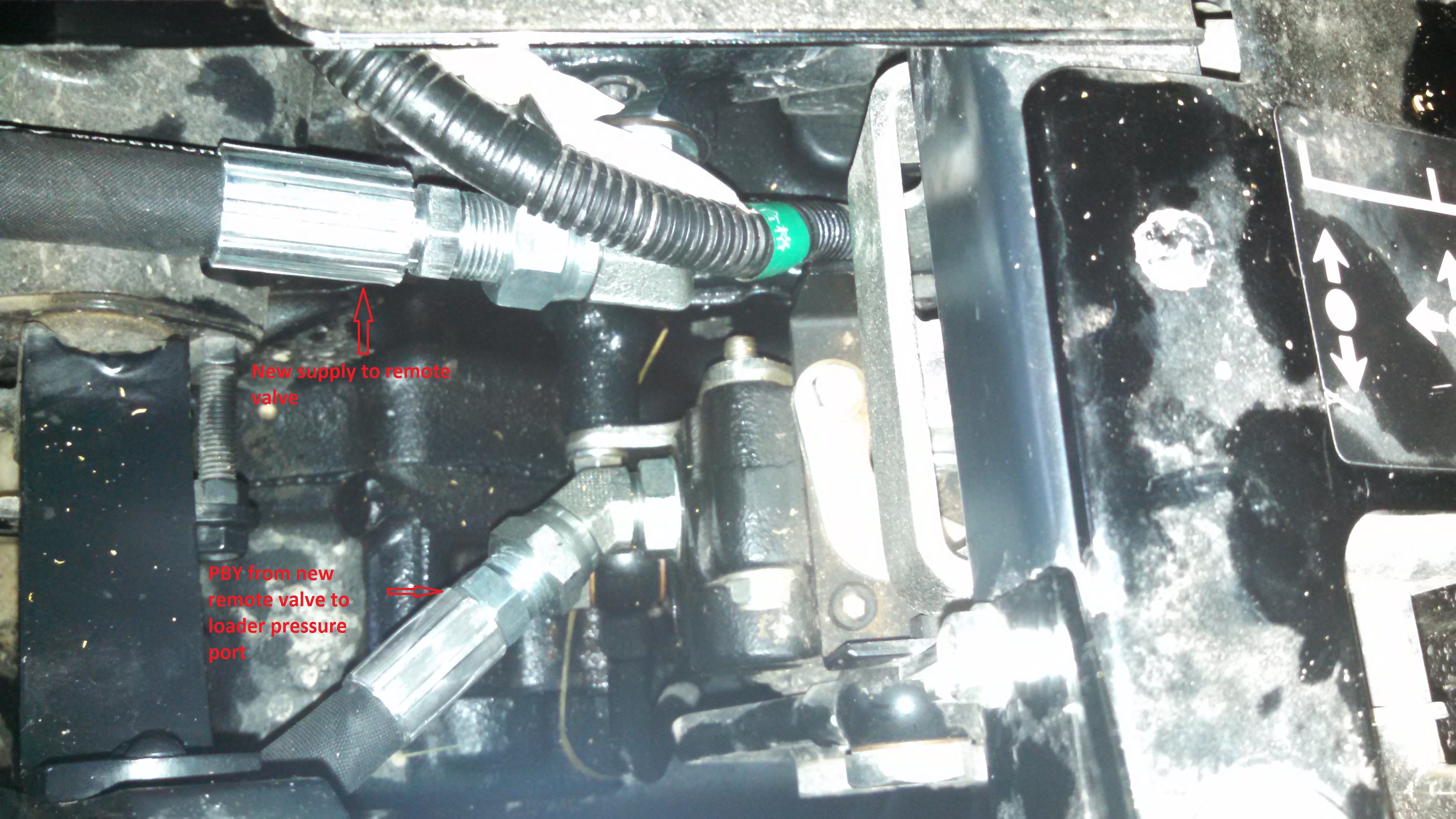

I then installed the #8 mob fittings with 3/8" FPT fittings and attached the new supply hose to the new valve and the PBY hose from the new valve back to the loader valve.

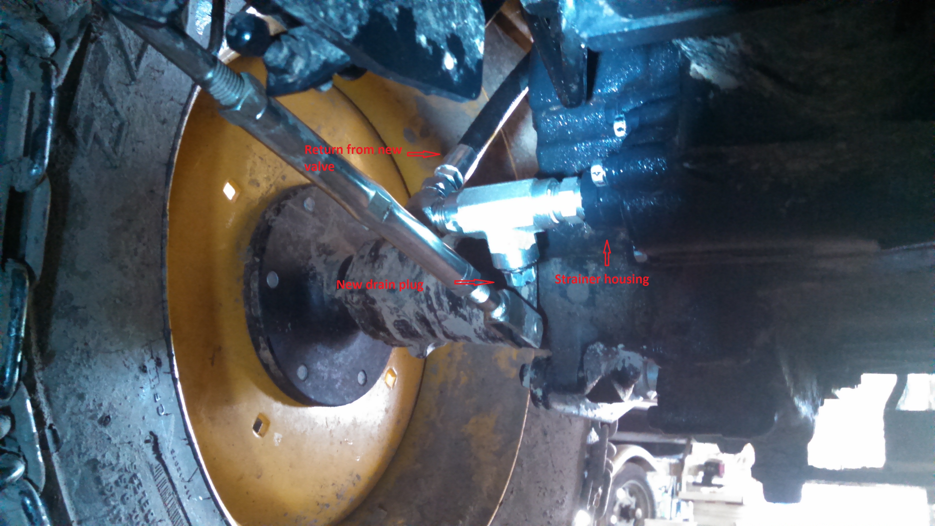

I installed the tank return line from the new valve down to the strainer which had a 1/2" pipe plug in it.
I installed a tee and used the pipe plug so I would still be able to drain most of the fluid from the transmission. The plug now points down so it will make it easier to drain in the future.
