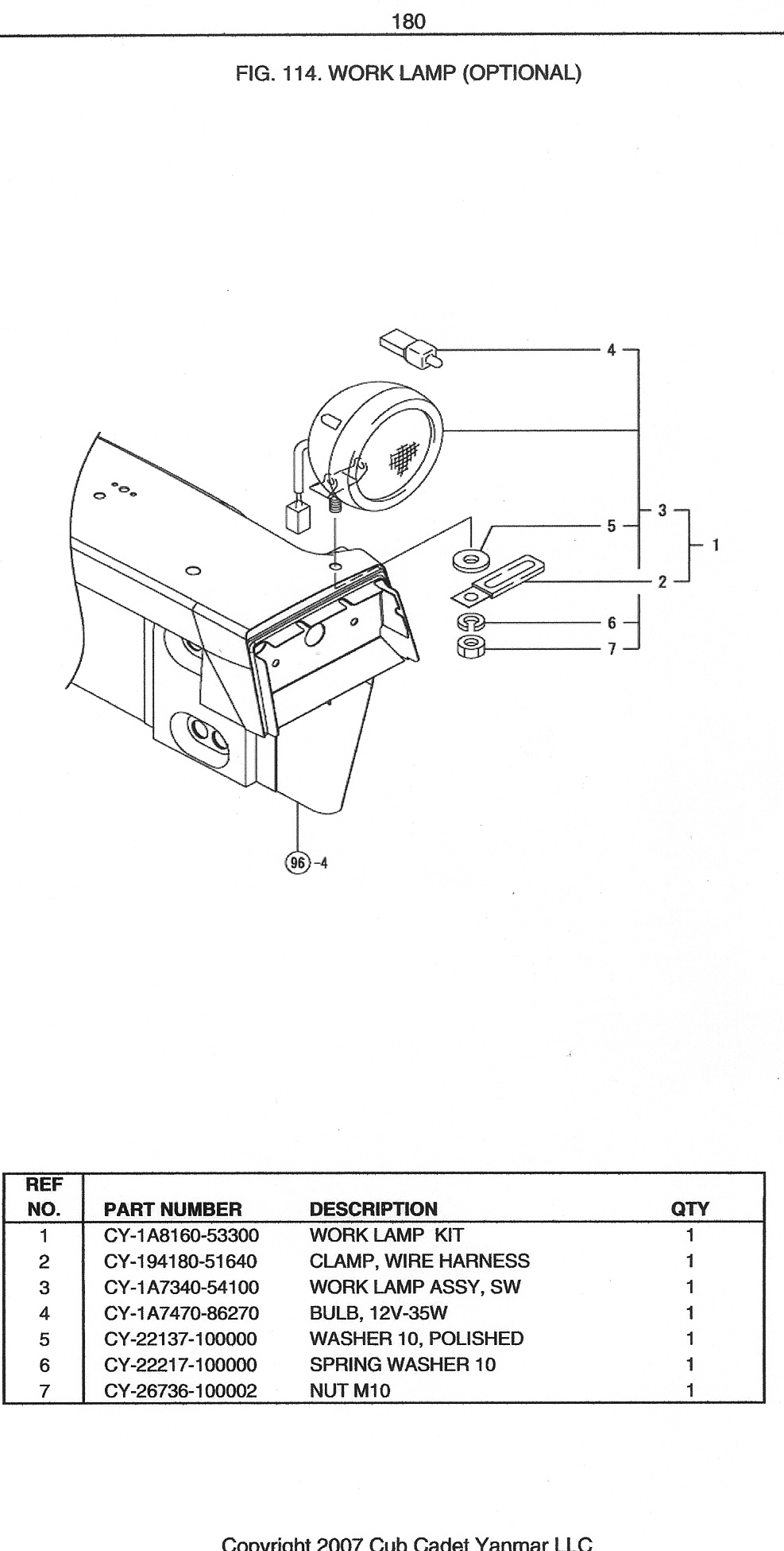

I just ordered a work light kit from my dealer for my EX3200.They could not tell me what it consists of. They didn't know if it was 1 light or 2.They even called cub and other dealers and even they didn't know(Must be a hot seller)I ordered it and she said I didn't have to buy it if it wasen't what I wanted. Has anyone here installed one of these kits? Thanks

Here is what the rear work light consists of. It is one light 35watts. Plugs into the existing wiring harness.There must be a on -off switch on the light because there is power to the circuit all the time when the key is turned on. My dealer wanted over $90.00 for the kit so I just went over to the light aisle and picked out a 35 watt light and a waterproof toggel switch and put that on. Total cost $23.00. I had to cut the OEM plug off.

Nice to have the OEM stuff AND that circuit can handle just that one light but sometimes you want MORE light and the only way to get it is new circuits.
Next problem, more than one lights will start to tap the resources of the alternator/battery, to much draw and the battery starts to drain.
