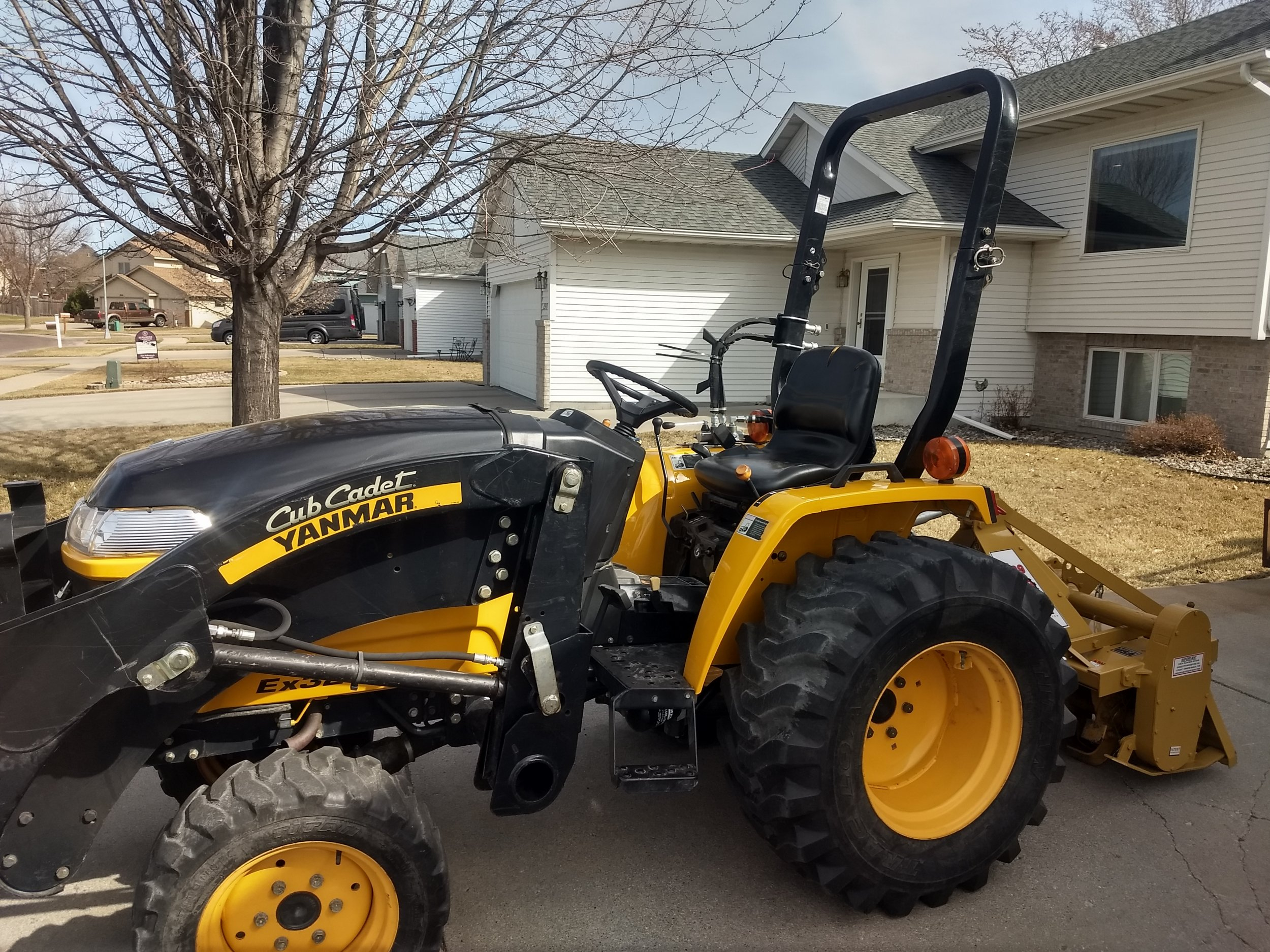

Hi everyone, i have the same issue with the temp and fuel gauge on Cub Cadet Yanmar EX3200, did anyone ever get this resolved or insight.
very frustrating mine works sometimes and sometimes not. they are both affected

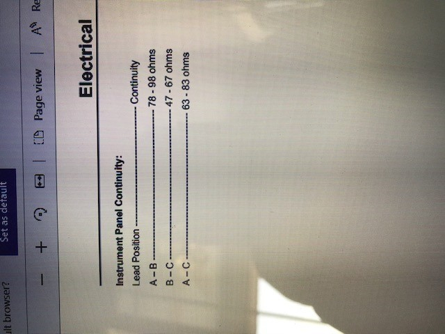

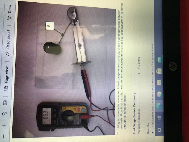

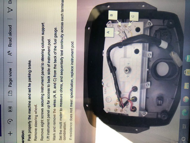

Nighthawk & Jack, Here is some info on the dash panel,

You say they work on and off check the connections as something is loose.
