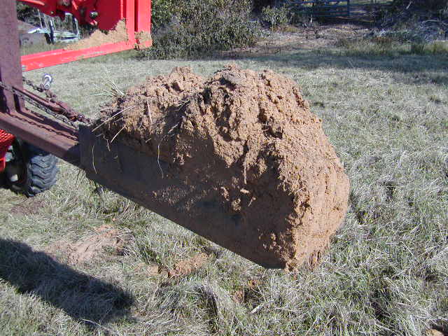

If you have an HST tractor with front end loader, you could probably use one of these.
Best part, it took about an hour to build & cost next to nothing.

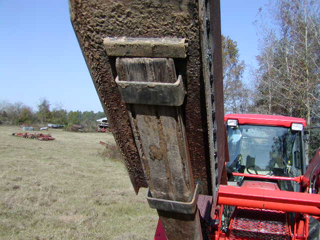

Just took a scrap piece of 12" Jr I beam, welded some sleeves for one fork to slide in, with a stop for fork to push against.

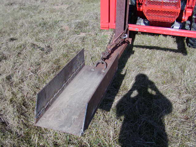

Welded some 6" side boards on it.
Installed a ring to chain it to rear of fork and I have a shovel
that weighs around 50 lbs.
Slip one fork off. Slide the shovel on the other fork by hand.
Position the fork off center so it is in full view.
It is quick & sure does beat the old hand shovel.

I have ran straight gear tractors with loader, shuttle shift and hydrostats with loaders. Close is close no matter what you drive. I've never had a problem getting close or easing up on anything a gear tractor. Interesting digger though. How well does it dump? Any problem getting the clump of dirt to release?

So far I have had no problem dumping. Normally will fall out before it is turned straight down. I have had to give it a little shake a time or two. Also I have not used it in clay yet, which would be more sticky for sure.
