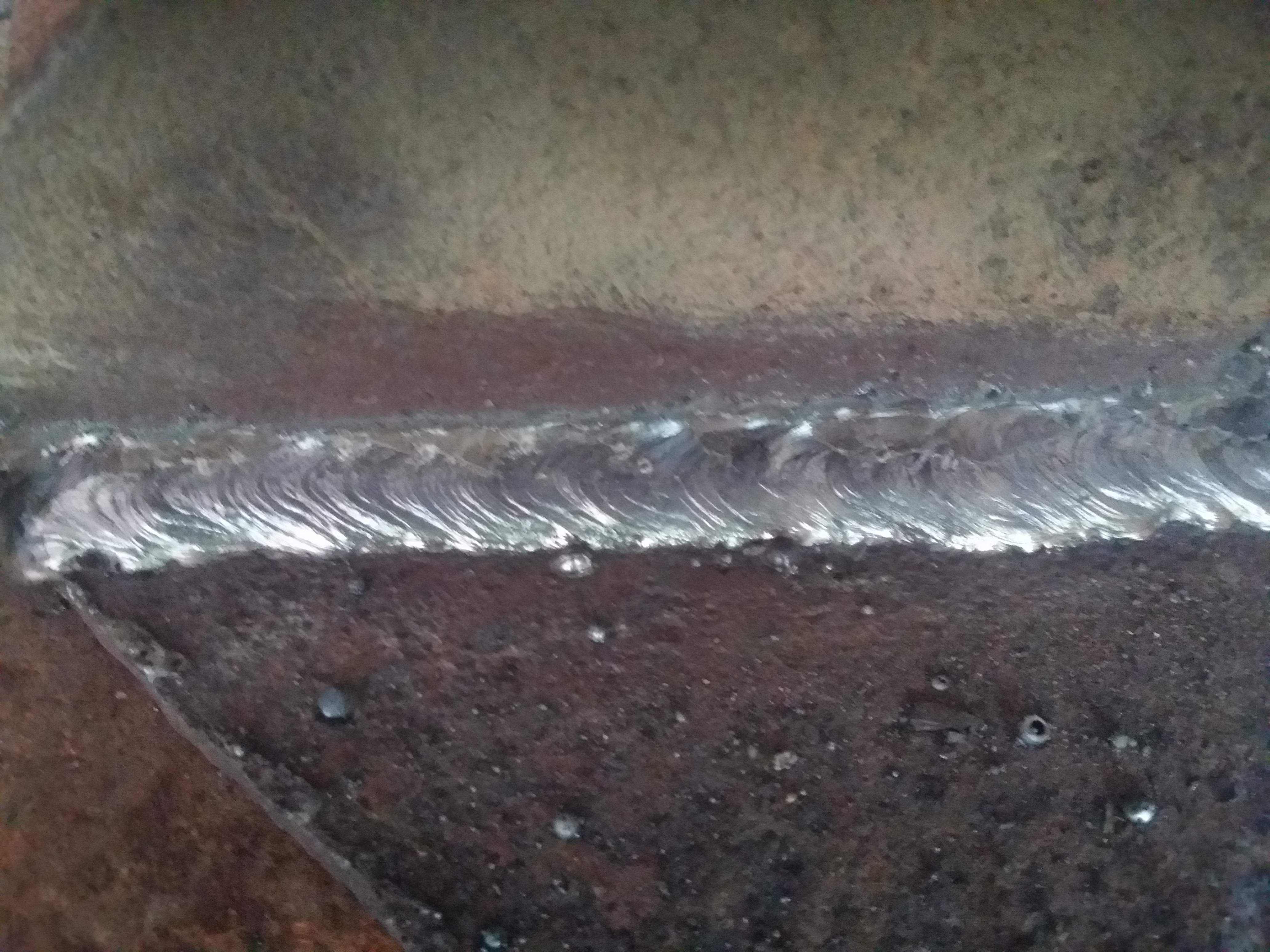

First I ran some 1/8" 7018. (It should be noted that all of my 7018 is about 10 years old and has never seen the inside of a rod oven. I have a brand new can of Lincoln Excalibur, but I refuse to open it until I spring the money for a rod oven.) Wow this thing runs hot! I used to run 1/8" 7018 at about 125 amps. Way too hot with this machine. I found the sweet spot at about 110 amps. Granted I was only welding on rusty 1/4" plate steel. I didn't even bother to clean it for the test welds. The arc was much smoother than what I'm used to and the arc strikes were easy.
Next I threw in some 5/32" 7018 on the same rusty 1/4 inch piece of steel. Again, runs really hot. I found it liked this thinner steel at about 140 amps. My old machine was struggling to even light it at 160 amps. This is just something I'll have to get used to. Not bad, just different. Makes me wonder how accurate the digital readout is. As long as it remains consistent I'm OK with the way it is. That being said, it ran the 5/32" 7018 great. I really think I could run 3/16" rod with no problem, although I don't have any on hand. Again the arc was very smooth and this machine made me look like a pro. I am a self-taught weldor. I included a pic of the 5/32" bead on here. Not bad for an amateur...I am giving the machine some of the credit here (no I don't work for Everlast). The slag does NOT come off easily from this outdated rod.

WOW, that is a nice weld:thumbsup:. Everybody has their opinion, what I have found with these inverters is they like one brand of rod over another. My Everlast PowerArc 200 loves ESAB's Atom Arc 7018, and ESAB's 10P-Plus 6010, and Hobart's 335A 6011.

Thanks, Shield Arc. Trust me, my welds don't always look that pretty. lol
Update to my original post: I plugged in the 110V adapter and ran some 3/32" 7018 (once again, old stock that would be considered "wet"). I ran vertical up at 64 amps. It ran buttery smooth. The arc was much better than my finished weld....but that's my own fault. I will have to try it, but I bet this machine will run 1/8" 7018 on 110V as long as you don't turn it up too hot (on a 20A circuit). VERY HAPPY with my purchase so far.
