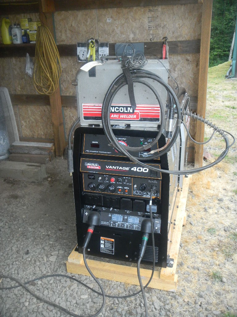

I paid over $12,000.00 for my Vantage 400. In SMAW mode the PowerArc 200ST runs the same. Mark, maybe you guys should raise the price of the 200ST! :D
