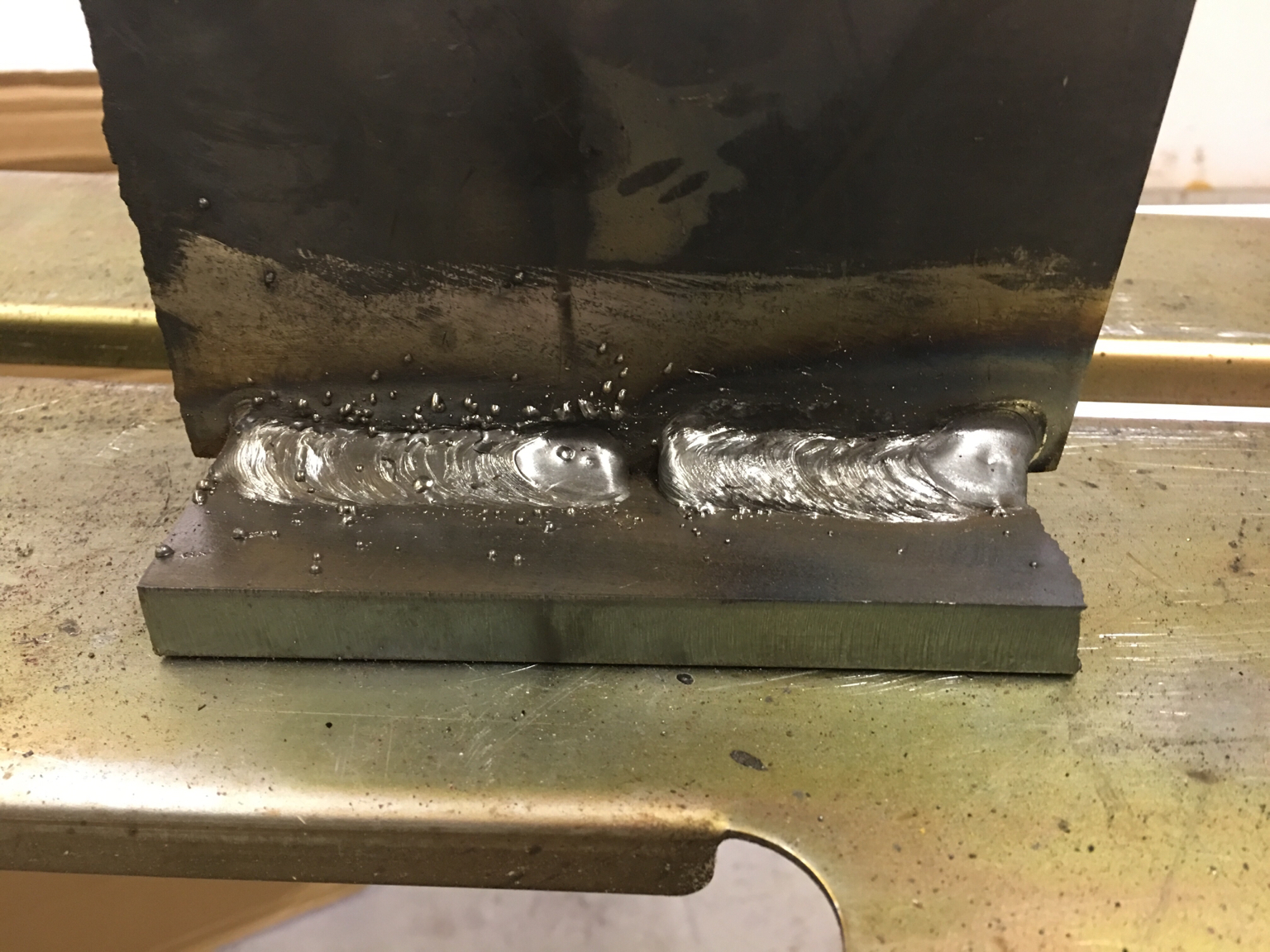

So I played around with the different modes and settings on some 1/4” and 1/2” plate coupons using .035 solid wire. I got it welding pretty nicely on mig mode with 75/25. Then I started playing with the pulse and double pulse modes. Here is where I was surprised. Apparently, those are really pulsed spray transfer modes. The noise the arc makes sounds like busted bassoon; nothing like a standard mig sizzling sound. I found that the arc would occasionally seem to go out very briefly and I was getting a little too much spatter while using the pulse mode.
While waiting on this welder, I also bought a bottle of 90/10 on the hopes of doing some spray transfer. So I switched over to the 90/10, and the those problems mostly disappeared.
The left bead is 75/25 gas and the right is 90/10. Everything else stayed the same. 250A and 20% on time. I don’t remember exactly what the voltage was set to though.
Does this seem correct? I know it’s not a great bead, but is does show much less spatter.

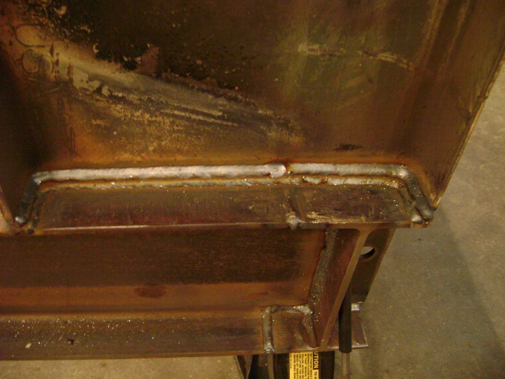

3Lfarm are you left handed, or right handed? If right handed, try starting the weld on the right side, and weld towards the left. That is called pushing.
What length of stick out are you running? With Mig, I run about 3/8 to 7/16-inch.

Yes for pulse you need the 90/10 or 95/5 or 98/2 depending upon the metal. For aluminum, 100% Ar. 75/25 will give you too much spatter because it isn't meant for spray.

Thanks! I’m right handed. I normally push right to left, but with the pulse settings, pulling left to right seemed to do a little better.
The welder didn’t come with any .035 contact tips, so I used a .035 tip from the Lincoln. It sits recessed inside the nozzle about 1/8” and I was trying to keep about 3/8 to 1/2” stickout past that for the pulse. The arc jet was about 3/8”. I don’t know how long of an arc I should be trying to achieve there.
