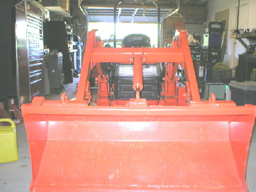

I have finally started customizing my BX1500 /forums/images/graemlins/smile.gif. I have added 3 grab hooks from AW Direct to the FEL. They are Grade 40 5/16" weld on hooks mounted to 2"x2" 1/4" wall steel tube.

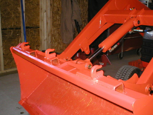

Another view.

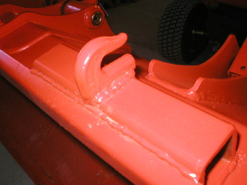

A close up. /forums/images/graemlins/cool.gif

   / Even More FEL Hooks #4
Nice job! The orange paint will make them super strong!!
   / Even More FEL Hooks #5
Nice Job!!
www.AWDirect.com is a Towing Industry supply outfit that just happens to be a very good source for hooks, chains, straps, tie downs, aux lighting and many other hard-to-find items useful for tractoring.
   / Even More FEL Hooks #6
That looks great! I like the 2 x 2 tube. It gives other possibilities and options for looping chains through the tubes.....
